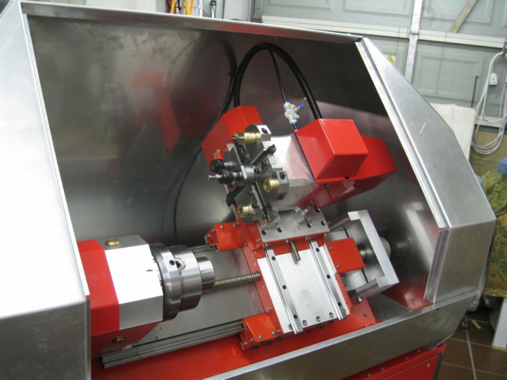

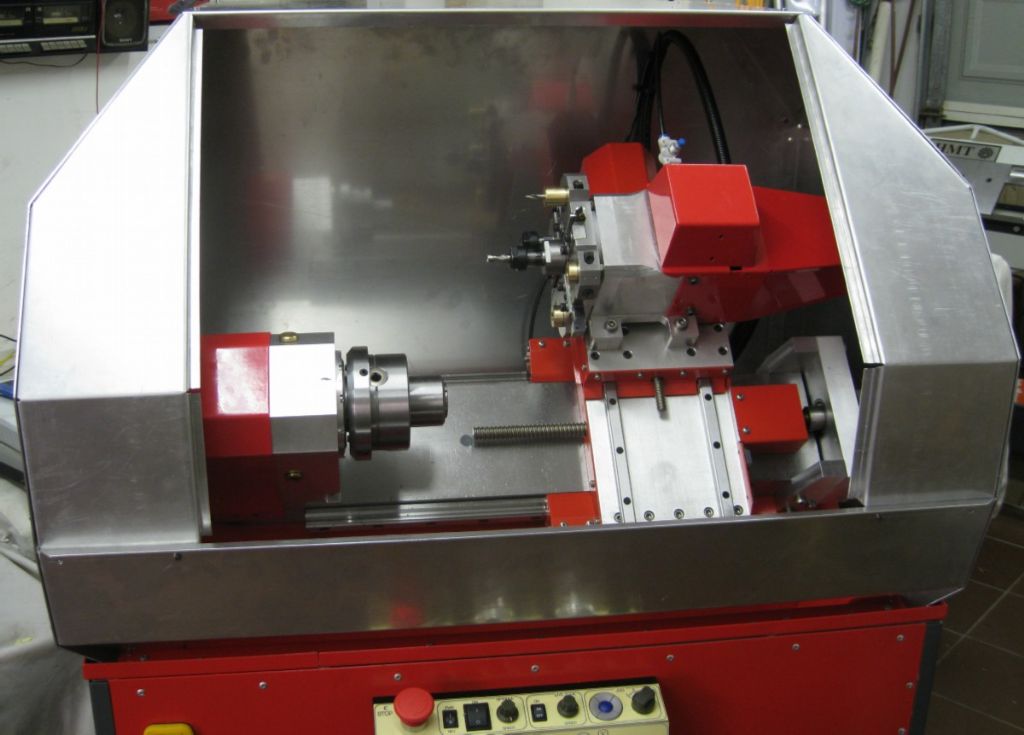

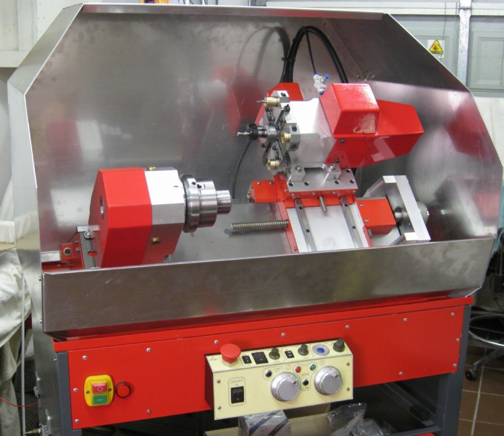

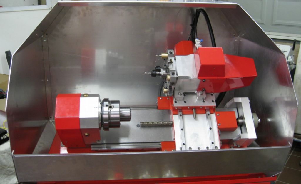

I had more than enough of LinuxCNC , and all things Linux, for a while....So am tackling some of the many bits still to be done on the lathe - Coolant pump and piping, Swarf/Splash guards, etc. Coolant is a bit of an issue on a CNC lathe like mine - The tool changer does not incorporate coolant feed pipes for each tool, like the big CNC machines do. I will have one spout, and that means the coolant is sometimes aimed at the wrong place. The spout can be set up reasonable well for most facing/turning/threading tool tips - they are more or less in the same place when selected, give or take 10mm or so. However, a drill bit, boring bar and the live tool center are not so simple. So the Spout has to be 'fixed', ie, does not travel with the carriage, but aims at the workpiece and must really flood it. I also intend to use a positive displacement coolant pump to have good pressure to blast swarf away...
Coolant will be neat cutting oil - Castrol Ilocut™ 510 MP,  a chorine and heavy-metal free, multi-purpose neat cutting oil. It can also be used as a hydraulic oil confirming to ISO 6743/4 Type HM, so I wonder if using a thin hydraulic oil is also possible?
So while the design concepts for all that brew, I continued with the Splash guards. This encloses the lathe entirely, to be fitted with a perspex front panel for viewing. I cannot get the flexible acrylic matl in Southern Africa, so Perspex it is..
Also have to think a bit about lighting internally - IP66 lights don't exist here...
The Guards so far-
Edited By Joseph Noci 1 on 13/12/2021 20:56:05

Looking very impressive.
John Haine13/12/2021 22:30:12
5563 forum posts
322 photos
Hi Joseph, on the polar kinematics issue, I don't know if you saw MG's post on a "polar drawing machine" a week or so back, but when I saw it I immediately saw the point you were making! As a result I've been idly wondering about using the technique to do laser engraving of a clock dial - it would make for a simpler machine than having 2 linear axes perhaps.
Somewhat related, I see that there is a CamBam plugin to do C-axis mapping of X or Y axes, which I think is mainly of use for doing cylindrical engraving, but as far as I know it can't map X and Y into polar coordinates.
Will your joint changes to LinuxCNC make it into the main thread or just be a fork? Sounds like it could be a good feature.
The lathe is looking good! Did you make any progress with the tool touch-off system? I was just thinking today about how I could integrate my electromagnetic approach more into the lathe structure. At the moment I have to loop the sensor over the workpiece and make connections to the chuck and toolpost for the excitation current, but this is often difficult with small components. I'm wondering how I could build the sensor into the toolpost structure itself.
