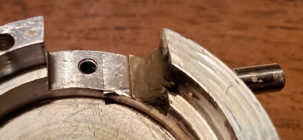

Turbine Guy11/04/2020 12:36:54
541 forum posts
578 photos
I bonded the insert to the existing nozzle bore with Loctite 290 and allowed it to cure overnight. The following drawing shows the finished dimensions of the insert and the position in the existing nozzle bore. I started the cleanup of the Loctite and found it has got into a lot places I did not want it to get into. It will take me a while to finish the cleanup, but if I can't get the Loctite out of all of the flow path, the insert won't work correctly.Nozzle Insert 2
Turbine Guy12/04/2020 18:28:34
541 forum posts
578 photos
I cleaned out the bore of the nozzle insert with a 0.022 in. drill and then cleaned the 0.032 in. diameter at the discharge end of the nozzle. I tried to clean the tapered entrance of the insert. Because of the metal filled epoxy I used to fill an opening where the drill broke through, I could not get a tapered pin down to the entrance of the insert. With the entrance taper still blocked with Loctite, the flow coefficient of the insert is reduced considerably. My original nozzle has a 60 degree included angle entrance and an estimated flow coefficient of approximately 0.93. With the tapered entrance of the insert partially blocked with Loctite, the flow coefficient is reduced considerably. I ran Turbine 3 with the APC 4x3.3EP propeller, Krytox GLC 105 oil, and 50 psig steam. The maximum speed was 4,150 rpm and the speed stayed approximately the same for 13 minutes until the boiler ran dry. The boiler had ¾ cup of water at the start of the test, so the mass flow rate was approximately 1.8 lbm/hr (19 g/min). The performance indicated that the larger diameter at the discharge end of the insert did not allow the steam to reach supersonic speed. Apparently, this was not one of my better ideas.
