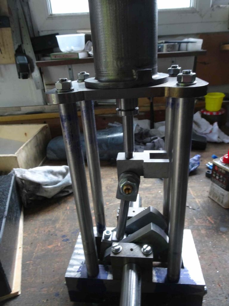

So (for the first time!) I assembled the engine.
I found two things (well two bad things).
I put the piston gland in place with some superglue, by the way so I can get it out easily if it turns out the plate is gash.
The main one was that if I put the cylinder on, it is fine at the top part of the cycle, but jams near the bottom. This is because the piston position is to far to the back at the bottom. Two possible reasons. One is the 1mm offset and the second is that somehow the piston gland bore is NOT in line with the cylinder registration. By about 0.3mm.
I really don't know how I managed that as the two were machined on a superglue chuck which was never removed in the same machining operation (Possibly several days apart, but even so..).
So I've stuffed up the bottom plate well and truly.
Oh, the other minor thing is that my piston gland is to long It stops the piston rising to TDC.
That, at least is an easy fix!

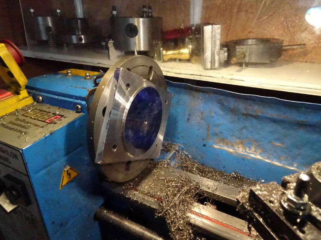

The task was to re-do the bottom cylinder plate which I'd manage to machine the spigot off-centre to the central hole (no I can't imagine how, either).

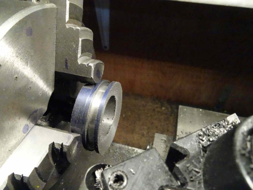

I started off by trying to use a superglue chuck. The chuck was snug to the chuck plate with a 6mm hole in the centre. The plate has a 6mm hole in the centre and I located them with some 6mm round toolbit material.
When I put them together on the lathe I noticed that central hole didn't seem central. So I got my indicator out and it seemed to be 0.5 mm off. Which I thought was too much.
Actually, I then spent quite some time (whilst working on other projects) trying to work out how to hold the plate.
IN the end, I drilled and tapped two M6 holes on the outside edge and mounted it on my face plate.
A bit of tapping and I got it reasonably centred (0.02/0.03 mm)
Next a rough cut to get 2mm down through the area which had an interrupted cut. I have interrupted cuts. I have to run the lathe at a higher speed than I feel comfortable with or it stalls.And sometimes it sticks or stalls anyway.
Then it was taking the rest down to a 50mm diameter and boring a 20mm hole in the centre. All very gingerly and trying and fitting with the cylinder and piston gland.
Here we contrast the new one and the original (bad) one. this time as you see I've done the bits where the registration matters before the cosmetics.
And, guess what? It all fits together!

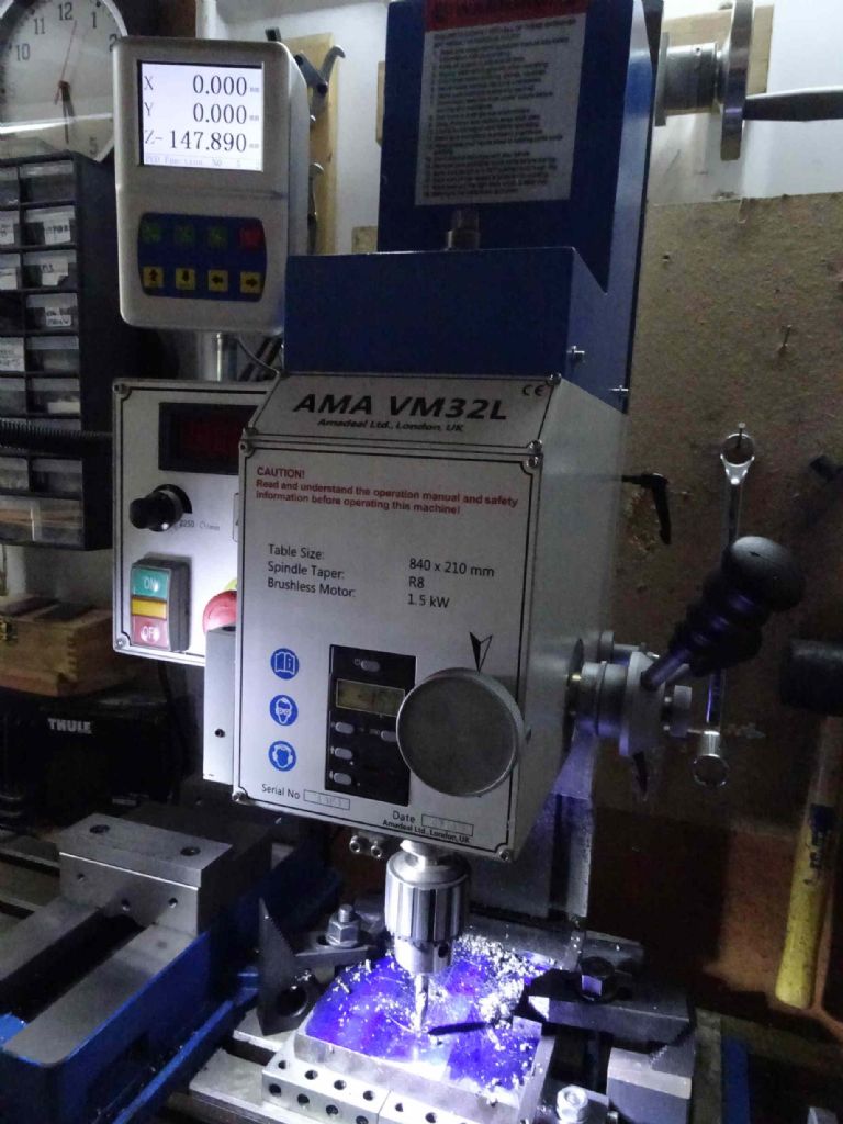

Next I needed to prepare the fixings for the cylinder. This is where my new DRO gave me a great deal of happiness.
First was to clamp the cylinder to the plate and use some slip gauges to make sure the valve face was parallel to the back of the cylinder plate (this by getting a close approximation and 'feeling' - This is not something where the odd 0.05 mm will make a lot of difference) then to clamp the cylinder in the vice.
Although the DRO has something to make holes round a circle, I'd designed this to have a slightly wider gap on the port side of the cylinder. In hindsight not sure if this was required to clear the ports, but there you are. I took my design and made a drawing with the offsets of all the holes from the centre of the plate marked and used that work out the positions on the DRO
I first put 7 spots in with a 5mm Spotting drill , then changed to a tap drill and put 7 tapping holes in, then back to the spotting drill to go just down through the 7.5mm plate (I should have done this to start with and saved a step), then a countersink for the 7 holes and finally, swapped out to a tap.
Doing this with the DRO was a joy. The top end I did on a rotary table with swapping between, drills, taps and drills for each hole!
Here we go! Already for mounting!

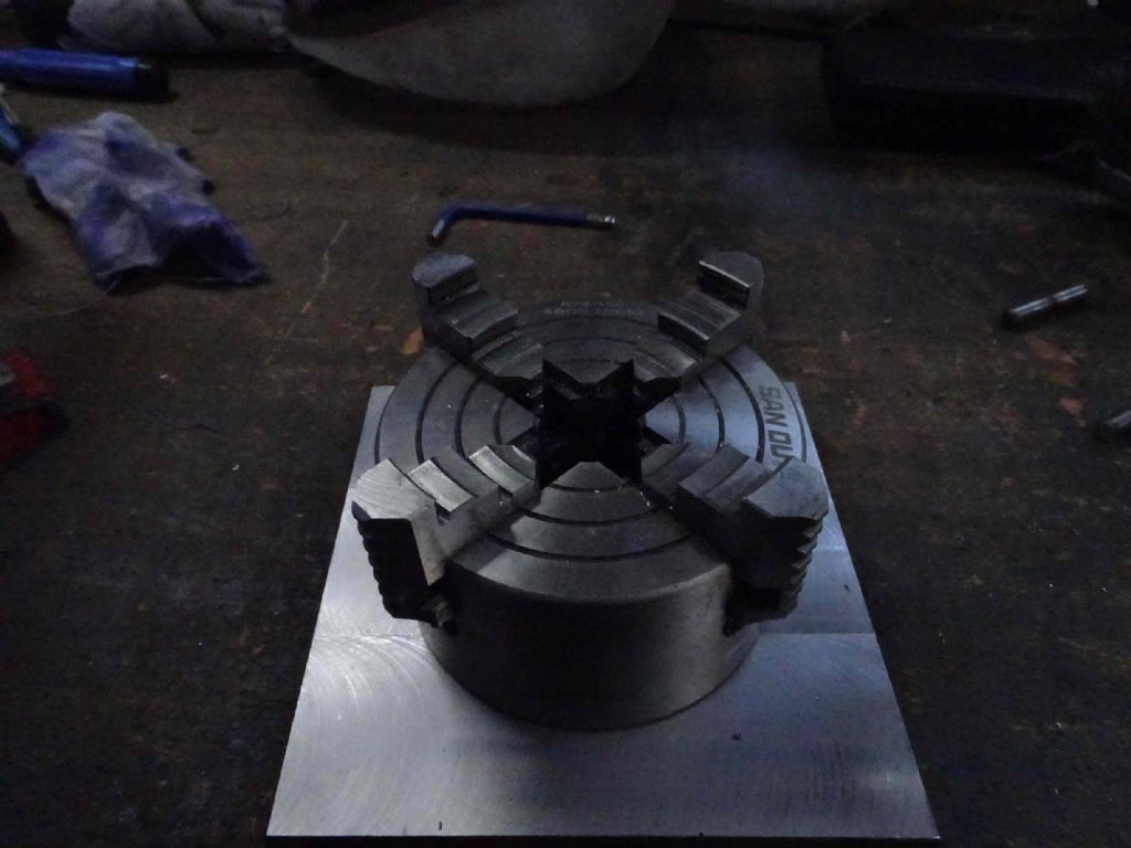

This phase of the operation shows that you often spend more time making the tools to make the parts than you do making the parts. Not that making the tools isn't as much if not more fun, but ...
In this case, I've given some thought as to how to machine the eccentrics and I've come up with an approach that looks like this.

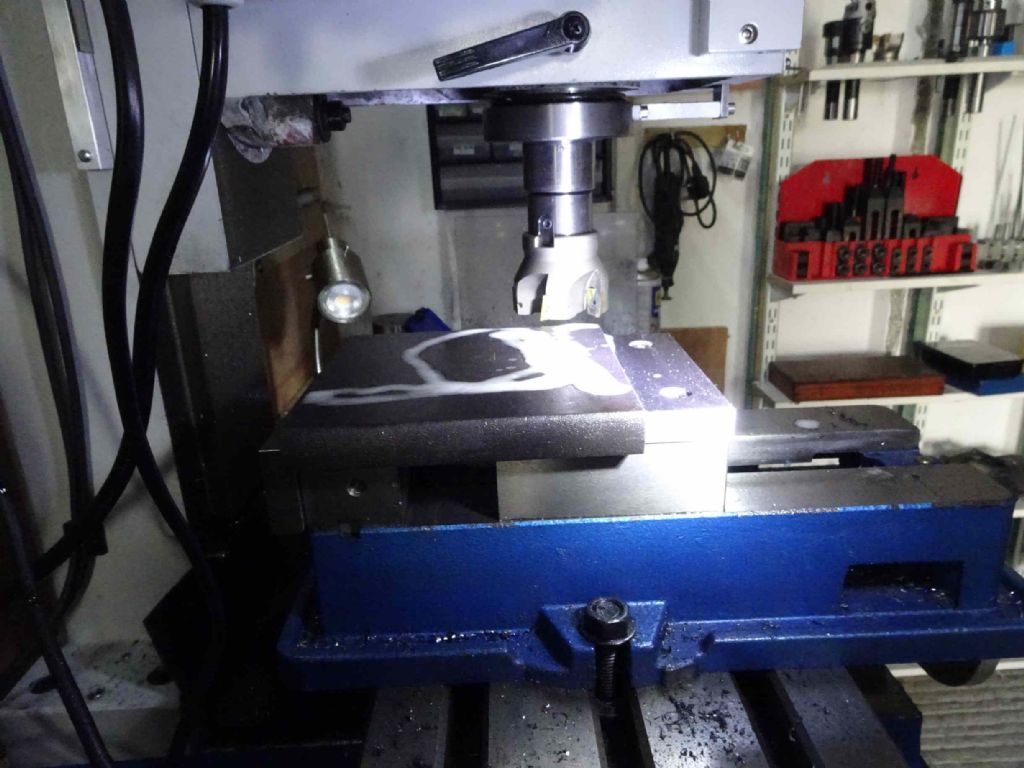

So the idea is to mill a square on the end of the cast iron bar to hold it in the 4 jaw. Then moving the piece to between the eccentrics and the offset of the crank will be (relativel)y easy. I worried about how to hold the piece on the mill (a round shaft vertical) and quickly decided a chuck was the right way. So how to hold the chuck? I chuck holding plate, of course!

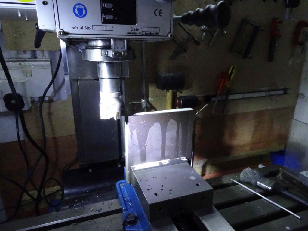

I have some pieces of 6 inch square x 1 inch plate I bought many years ago for a first project which was going to be a lathe. Ah, Hubris! Downfall of the Gods and amateur engineers who over-reach. So the headstock sides have been re-purposed since for more practical uses.
First, to square the sawn ends so I could put it in the vice
Then, for the first time, used the versatility of this ARC versatile vice. You can move the jaws around to hold bigger pieces - the standard jaws won''t hold a 6 inch piece.
This worked really well and I was able to get a nice shiny flat plate.

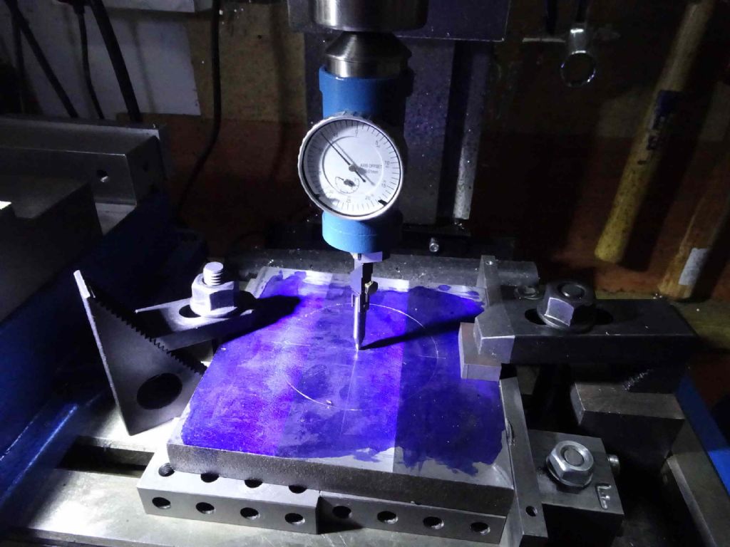

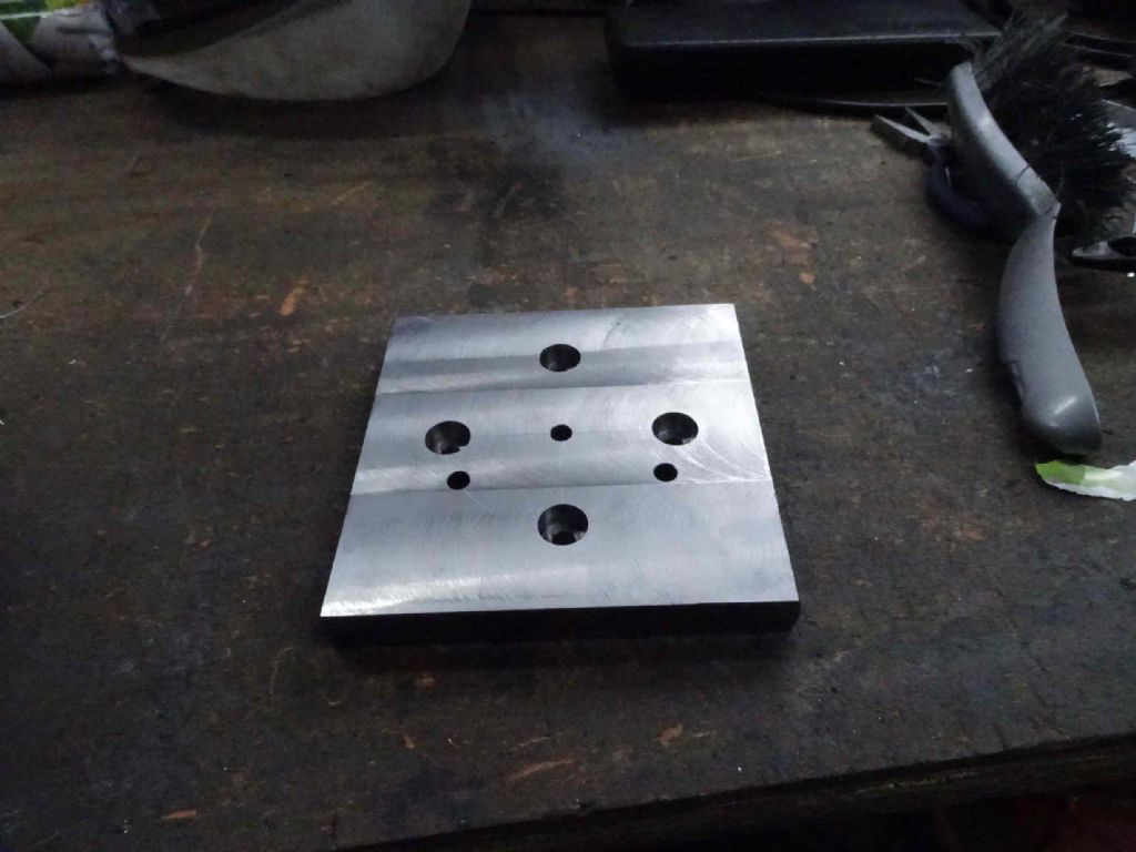

Now here's the exciting part. My first attempt to use the PCD function on the DRO.
Set the centre of the plate up with the co-axial indicator and set the INC register on the DRO to zero. I have to say the DRO seems pretty good (but see later) but the chinglese manual is not the best. Once I zero'd I set the PCD to 84mm diameter, 5 holes (yes, for some reason you have to end up where you started, so drilling 4 holes means you have to enter '5' and start at 0 degrees.
Oh! I've just discovered you can set the picture size!!!
Anyway running through the holes is pretty easy, you just press <- and then wind the handles till X & Y are zero. The DRO really is transformational - in another tool to make the eccentric, I had to spot, drill and tap three holes. Before, I would have spotted, swapped to the drill, drilled, switch to the tap, tapped (manually) and then did this twice more. With the DRO, I set register 0 to 0, spotted, moved to the next position, set register 1 to 0, spotted, moved to the next, set register 2, spotted. Changed drill, drilled, selected register 2, drilled and so on. Much less swapping of tools!. On this piece I also managed to power tap successfully for the first time.
Anyway, here's what the Chuck holding plate looks like
I ended up making it suitable for 3 and 4 jaws as you can see.
And here with a chuck on it
The other tool I mentioned above was something to hold my indicator in the QCTP - just a piece of mild with some bolt holes to hold the indicator. When I've tried to centre in the 4 jaw in the past I've used a lever type indicator with a very small degree of movement. It's to easy for an idiot like me to back the piece out of the range of movement of this - if I can get it in in the first place, so I'm hoping that this will make things easier.

First I drilled a centre in end of the bar, holding it with the 4 jaw on the (aforementioned) chuck holding plate
Then onto the lathe with a 3 jaw lightly nipped and the end of the bar in a centre
First few passes with a carbide insert which didn't really work too well - perhaps I wasn't taking enough off, it seemed to rub rather than cut - though the dust that's produced was hot enough.
Then finished with a nice traditional HSS tool. This reduced the 50mm bar to about 48mm - I wasn't trying for a particular size - just to get it nice and clean to hold in the 4 jaw.

Then onto the mill for the squaring
Again, the DRO made this child's play. I used an edge finder to get the Y edge and zeroed the DRO, then the same with the X. Then moved the table to center the spindle over the centre of the bar and zeroed X&Y.
Oh - and I discovered why I got a 4 Axis DRO! At the time it was just because I could but didn't really know what I would do with it. After all the Spindle DRO would do all I wanted.. However, I realised here that I could use the Z to take the head down by 25mm with the spindle high and fully locked. In theory more rigidity! I'm not 100% sure this will make a difference in practise, but it certainly makes me feel better about the extra spend...
A bit of chatter on this, but this was cleaned up when I slid the tool sideways to open the slot out to 4mm.

Most likely, the next work item are the eccentric straps. To be honest, I've not yet worked out how to machine these. I've seen that there are videos on youtube and no doubt advice in this august forum, but I've not got round to looking.
I was wondering if I should make the straps in steel or brass. I was thinking steel, but brass would like nice, wouldn't it? Any reason why not?
What I may do before that (if I have to wait for material, for example) is to mount the cross head guide,
I can feel it getting close!

Marked up on the surface plate as a check, but then back to the mill to use the DRO to mark and drlll some nice round corners for edge relief.
The stop was used so that I only need to edge find once. The two pieces being within 0.01 / 0.02 in all dimensions (somewhat to my shock).

Back to the mill to be drilled and tapped.
The lovely DRO let me spot, drill, tap drill and tap without having to change tools a million times. Thanks, DRO!
