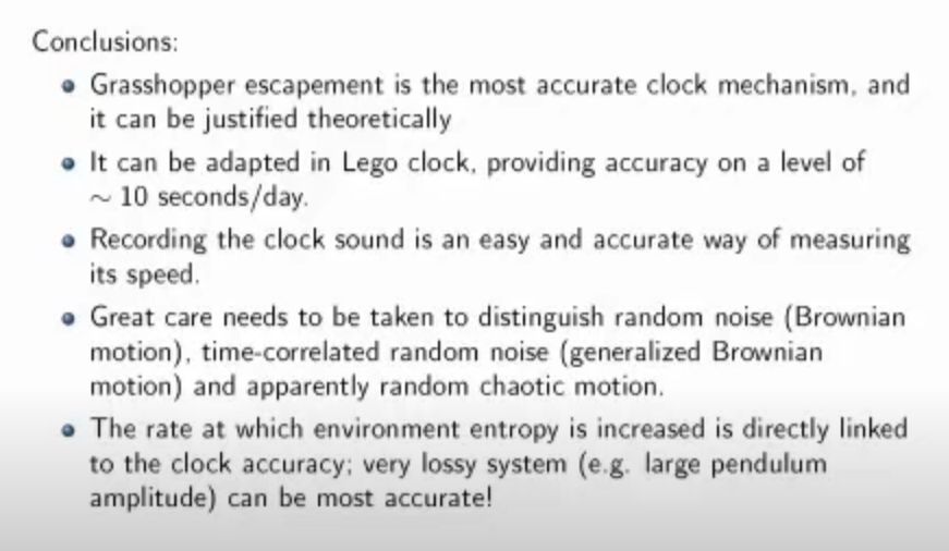

SillyOldDuffer01/03/2023 16:05:48
10668 forum posts
2415 photos
Posted by Mason Green on 01/03/2023 14:26:33:
From Ziemkiewicz's lecture on YouTube:
YouTube Link
His analysis reveals the pendulum period error is not a simple gaussian random walk, but rather follows a Maxwell-Boltzmann distribution:
YouTube Link
"Interestingly the error function is a fractal that resembles the trajectory of Brownian motion... further details reveal it is not pure Brownian motion, individual "jumps" are slightly correlated"
"pendulum has a memory"
His previous paper is also an interesting read:
"Numerical analysis of grasshopper escapement"
But, a wise man once told me to never waste my time trying to convince anyone of anything on an internet forum, lol.
Not really a question of conviction, more about me gripping the point and how the hypothesis might make a difference to what I'm doing. If I've learned anything from my experiments it's that clock stuff is hard to measure AND difficult to understand. Misled myself on many occasions, and am probably doing it now!
No disrespect to Professor Ziemkiewicz, but looking critically at his conclusions:
  • 'Grasshopper escapement is the most accurate clock mechanism'. Maybe the most accurate mechanical mechanism, but not proven its the most accurate, yet! Harrison's fiendishly clever ideas look excellent to me, but no one pursued them. None of the world's best pendulum clocks used the system, though it' true recent examples have done well. I emboldened mechanical because it's not necessary for a pendulum to have an escapement at all, and there's a strong case that no escapement is best.
  • The Lego clock is impressive in it's way, but it's full of noisy mechanical imperfections. Although indicative, they may be confusing the conclusions.
  • 'Recording the clock sound is an easy and accurate way of measuring it's speed'. Up to a point, but the pendulum itself is silent. The acoustics are generated by the escapement, which isn't exactly synchronised with the pendulum. (I don't believe the pendulum was measured relative to the noises off.)
  • 'Great care needs to be taken...' Absolutely! For example I could claim my graph evidences a Maxwell-Bolzmann distribution and have a few even more convincing examples. Only problem is, I'm pretty sure my skewed graphs are due to over-impulsing. The curves look Brownian, but aren't. Looking at other data reveals my clock has a correlation between the degree of skew and impulse power.
  • 'The rate at which environment entropy is increased is directly linked to the clock accuracy; very lossy system (e.g. large pendulum amplitude) can be the most accurate.' An interesting observation, but again 'not proven' I think. For example, on my clock, over-impulsing can do horrible things to the pendulum without damaging the time-keeping in the long-run. The reason I suspect is large amplitudes work provided they're consistent, not just because they're big. Small consistent amplitudes work too.
Certainly not saying the whole idea is hopelessly wrong, far from it, but to be convinced it's proven, I think we need more evidence that all the other possibilities have been eliminated?
