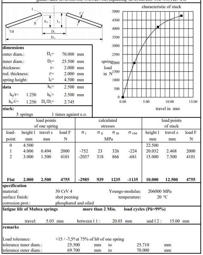

The Bellevilles are 70mm OD, 25.5mm ID, 2mm wall, 4.5mm height Qty - 5. That gives a height of 22.5mm.
At 2000N preload, they are compressed to 20mm ( lower half of image below)
At 4200N they are compressed to 15mm ( upper image half ) with a 5mm extend., ie , a 68% crush.
Use of odd numbers of Belleville spring is OK, if always in series, ie, each one inverted in relation to its mate - if you nest them, they can still be odd numbered, but each must have a nested mate...
Clearances have been adjusted all round to eliminate over-constrained contact.
A much larger diameter thrust bearing fitted behind the piston to prevent canting. Piston also impinges on spacer -8- when pressurised, as end limit stop.
The pre-load nut -4- now has a lock nut -5-.

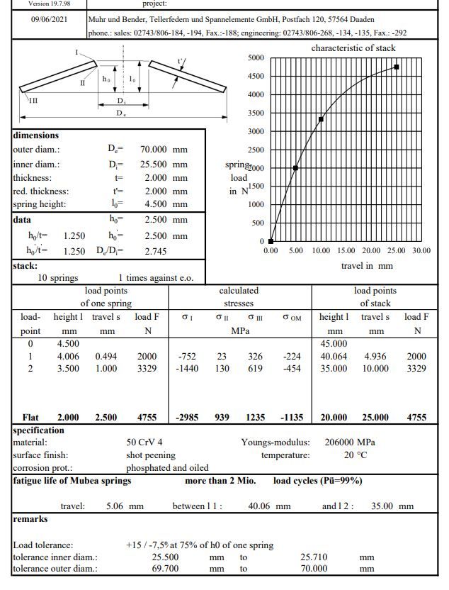

That all makes sense. You have used bigger Bellevilles then we did and looks like you have a larger piston diameter to deal will the forces required to open the Hirth coupling.
We were limited in cylinder size and a max 8 bar, as safe usable, pressure so I had to balance to pre-load force and the opening force. I'm sure you are aware but by using more springs you can change the load profile and reduce the opening force.
There is the down side that the stack is bigger but if you are considering long term reliability then it might be a good trade off as it will give the thrust bearings and stepper motor an easier life.
for example if you doubled the stack to 10 springs then your 2000N preload is at 5mm and the open stack force would be 3300N @ 10mm. That is nearly 1000N (25%) lower then 4200N from a 5 stack system.
It might not be so critical here but I have done this on my mill PBD to keep the max loads as low as possible for reliability.

Not sure what diameter your piston is - mine is 90mm, with 24mm lost in the center bush area, so around 9 square inches which @ 120psi is around 4800N - to mix a few units...
I have no idea how to integrate losses, friction, etc into this, but I am content to go to 120 psi (8.2bar).
I played around extensively with the evaluation tool you linked to - the one you used to create the data sets in your post above. I would have liked to go for 8 springs, maybe more, but the housing length becomes an issue for me to machine - I would really like to machine the housing interior in the lathe with the 4Jaw, rather than on my small mill with the boring head - that is excruciating in focus and concentration, and very slow to get the pneumatic seal finish required..
A lengthened housing in the 4jaw scares me though - the housing is quite large - 140x130x95mm deep -5 more springs adds another 15mm or so to the depth- we will see - need to model a bit more!
I have reduced the Hirth engagement to 4mm, expecting a 4.5 to 5mm extend for the teeth to clear. I kept the tooth angle at 60deg - steeper would allow reduction of preload forces as you say, but I worry as to how steep - when does it become a 'taper-lock' with corresponding big force needed to break the lock?
When you say 8bar is 'safe useable' - what do you mean? I have a 2KW 2 cylinder compressor that seems very comfortable at 10bar. The pneumatic solenoids I have (Festo) for air control give limiting pressures of 15bar. Am I missing something here?
