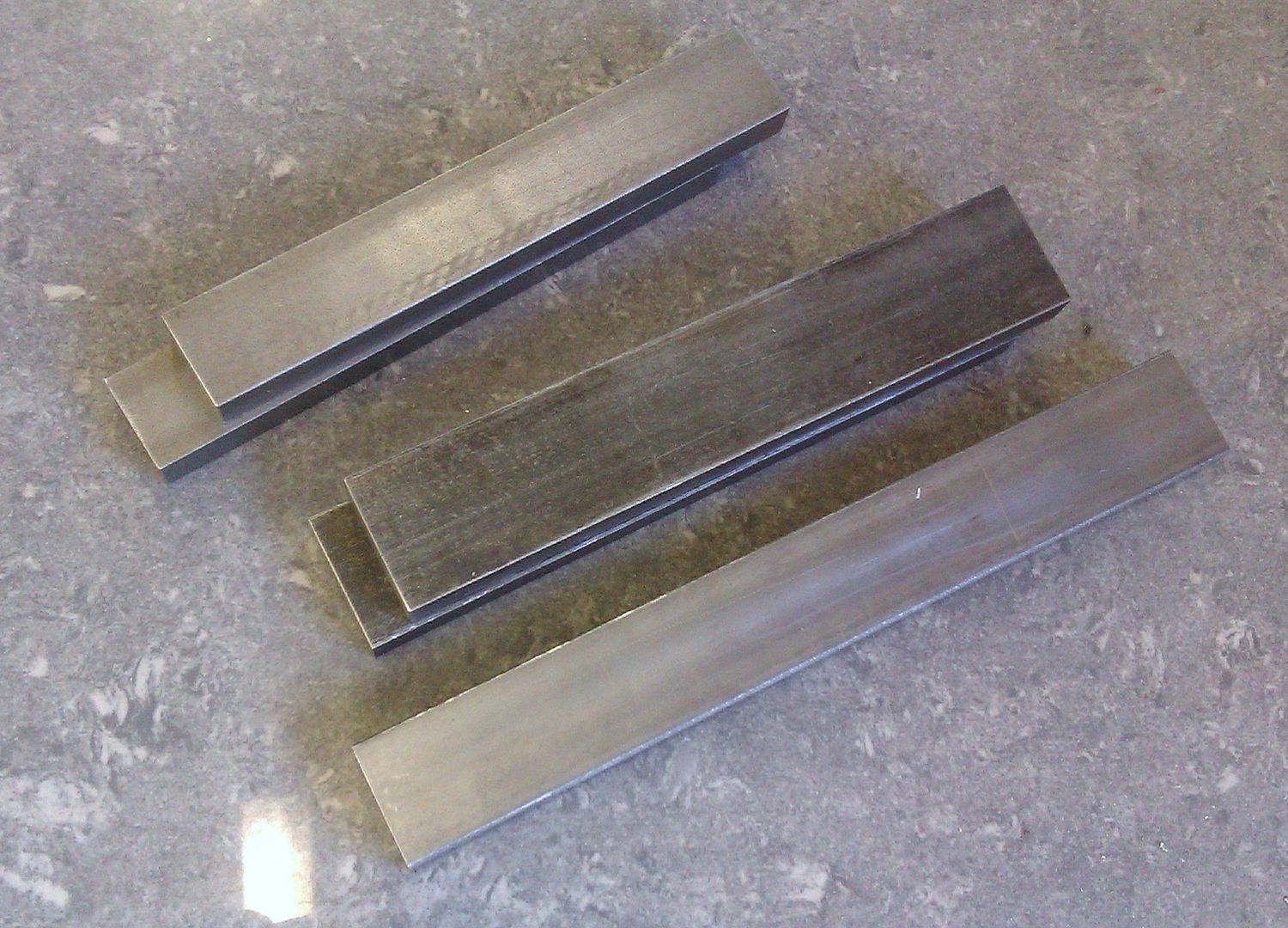

I'm not averse to using flat stock particularly if the rod doe snot have a forked end which can tend to close up, This pile of bright and black bar.........
................Stayed true enough on my Easton & Andersonsmiley
