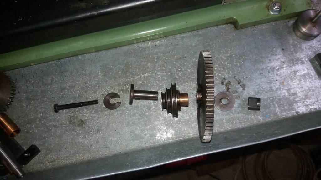

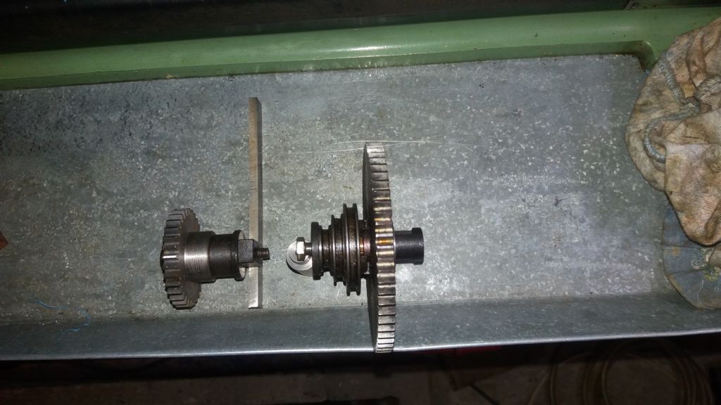

James Hounslow03/06/2019 21:59:13
2 forum posts
Well I am between 5 and 9 years late to this post.
I have just picked up a Warco 220 for pretty much silly money. It has come from a school and appears to have had very little use, which is always nice
The downside is that it did not come with any tooling, or screwcutting gears. I knew this when I bought it.
The second downside is that (probably for reasons of safety) the school un-installed the lead-screw drive mechanism. It is missing the gear which meshes with the spindle splines, the one with the 3 small pulleys for the 'friction disc' to engage in.
Does anyone still have one of these lathes, and if so, would it be possible to have the dimensions and tooth count of this gear so I can make up a new one?.
Many thanks
James
Tim Hyndman28/10/2019 19:00:13
1 forum posts
3 photos
Hi James,
I think you are after a 64 tooth gear. I am installing a 220 vs and trying to work out the screw cutting gears. I found your post and took some pictures. I could draw up this gear if you still need the info?
