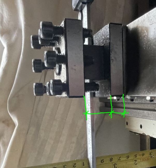

Thanks for those Margret, Both the QCTP you have and the 111 would work with larger tooling but the 000 may not suit the smaller sizes. To check exactly what works could you put something pointe din the lathe chuck or tailstock and take the measurement from that to the top surface of the top slide as below
Also if you could measure the diameter of the threaded portion of your toolpost stud that would help deciding what's the best way to modify that. I suspect it's an M8 thread so should be 8mm or a bit under.

Jason - putting the tool in and offering up to a workpiece looks fine - although I did have to adjust the tool holder up a little (not sure if this is normal practice as i have nothing to compare against) - but a standard tool of the size I generally use does reach the work piece ok. See pic. I will try the stud later when home tonight but it looks likely that the stud will work or worst case, I need a new stud. The threads on the original stud look a bit worn don’t they?

Looking at the first photo the tool does not look like it is not yet lined up with the ctr of what you have in the chuck so could do with going up maybe another 2mm. This will put you right at the limit for that height of tool (10mm? ) and anything smaller won't really come upto ctr height without being packed up. So I would be more likely to opt for the 111 toolpost with standard holders so smaller tooling can be used. (hope the bottom ring is screwed on in that photo)
The other advantage of the 111 is the hole in the middle of the toolpost is 14mm which would be better to allow the existing stud to be retained and a shouldered nut made.

Jason - putting the tool in and offering up to a workpiece looks fine - although I did have to adjust the tool holder up a little (not sure if this is normal practice as i have nothing to compare against) - but a standard tool of the size I generally use does reach the work piece ok. See pics. Although I am concerned how far I have had to adjust it. There doesn’t seem to be much thread left on the adjuster- is this normal?

Hi Jason, just read your latest response during a break (lol). Yes I think you may be right, it does seem quite near the extremity of it's adjustment - I think the 111 might be a better option. See pics below, they show clearly how near it is to the limit of adjustment.
Do you agree?
How I would make a shouldered nut though, I have no idea! disgust

I have just asked my brother to measure the distance from the top of the top slide to the centre of the workpiece/chuck - it is 20mm.

That sounds a bit low to me, from the photos I would put it closer to 25-28mm maybe check again when you are home.
The tool opening in a holder is 13mm so your tool looks to be about 10mm square. Max height of the bottom of the holder is 17mm but your adjuster is a couple of mm from max so lets say 15mm. so add the 15mm and 10mm and the edge of your tool is 25mm from topslide surface.
As for the nut well it only needs to be hexagonal if you want an extra spanner to loose. Simpler to go with something like you have that is cylindrical with either a fixed tommybar or just a hole for one. You could use the washer that comes with the toolpost then it is just a case of turning one end of some say 25mm bar down until it fits inside the toolpost and threading that end to suit the stud assume M8. Last thing is a hole for the tommy bar.
Not far off what I use on mine, the hole is drilled so I can use the chuck key to tighten the "nut"
the larger 14mm hole in the 111 toolpost gives a decent amount of metal around the M8 thread that you would not get if it had to fit the 10mm hole of the 000 size

Jason - you were right about the measurement. Somebody (who shall remain nameless) didn’t do it correctly - it’s 22mm. Does that help in anyway?

If 22mm plus is correct then a 111 will allow you to use upto 10mm sq tooling with the standard holders or 12mm with the slim bottomed ones. You will also be able to get smaller tooling such as 3 or 4mm square HSS upto ctr height which is handy for making small form tools as the small section makes it quick and easy to grind.
