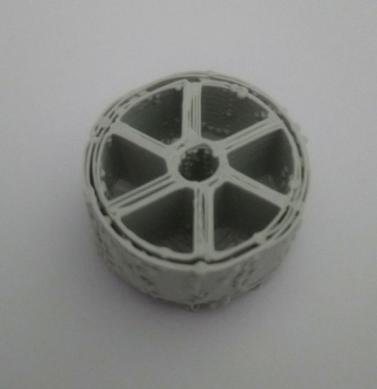

Alan19/04/2022 15:29:58
22 forum posts
9 photos
Its taken a bit of time...But here is my attempt...
This is a FreeCAD screenshot
And this is part of a 3D print...
Not a very good print... as I'm still trying to learn how to work the printer!!
The FreeCAD drawing could also be improved... but I don't think its too bad for a first attempt!

Posted by Alan on 19/04/2022 15:29:58:
Alan
Congratulations! No idea why the 3D-print is wonky. My Creality Ender-Pro "just works" with the default settiings, and I've never had to fiddle with it. Just as well - there are a lot of them. Cura seems pretty good at generating a reasonably strong internal honeycomb too.
Those staggered spokes,are slightly harder to do than straight ones, so award yourself a small prize. Reminded me of something FreeCAD struggled with in earlier versions, which now seems fixed. S-shaped spokes as used on cast-iron pulley wheels to prevent cracking as the casting cooled.
Alan20/04/2022 09:09:46
22 forum posts
9 photos
Thanks Dave!
The staggered spokes are an error.. (feature.?)
I'm currently trying to get then straight!
The method of drawing it was fairly easy...
1) Sketch the side on profile
2) revolve around Z axis
3) Drill hole in centre
4) Sketch one segment, and make the hole
5) tell the program to repeat 6 times...
Alan
