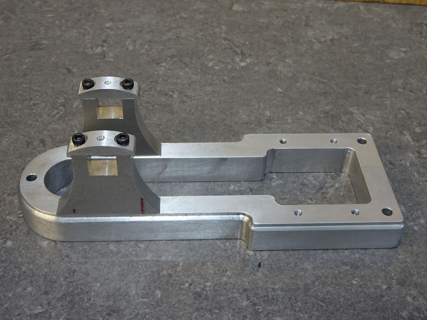

I did have a bit of a doodle last night, Vicky and her twin sister in the early stages, all fabricated.

That looks good Jason. The difference I have is mainly in the bearing mounts.
I've been quoted for 25mm x 10mm Al.
I was thinking to have an 8 mm high parallel side around the base at 10 mm wide, a 15 mm high tapered section above that, then another 2 mm high parallel section at 9.53 mm, which would match the 3/8" wide bearing blocks. This 2 mm high section would be milled back along the lengths to form the bearing and cylinder mounting pads. By my reckoning this would then give an approx. 1.8 degree taper on the outside faces to represent some draw.
I would have to figure out how to cut this angle accurately though.
However, I do like the look of the plinth around the base - and how you've modelled it in general.
I like the idea of not having mounting lugs, which look out of scale and a bit ugly. Is the intention on yours to use studs up through from the base and put nuts on the top?

I'd based my drawing on being able to pick up some imperial 1/2" x 1" aluminium and that would give me a 10mm width at the top allowing for draft and the flaired foot. Another option if you can't get that size or a slightly thicker metric one is to use a separate plate on the bottom as shown here (CNC not required) or rather than having the moulding at the bottom it can be cut into the top outer corner with a simple home made cutter.
Yes the base would be held down by long studs into the base with nuts bearing on raised round bosses. These bosses are just thick "washers" that are loctited into a shallow counterbore and then a fillet of filler run around the edge to give the cast look.

OK so I can get 1” x 1/2” aluminium. I wonder if I could use the fly cutter with a 0.8mm tip radius insert to simultaneously form the angled side, and the step with its corner fillet?
I might be able to make an angled jig out of steel, and secure the aluminium to it with screws through the steel into the Inner (flat) faces of it.

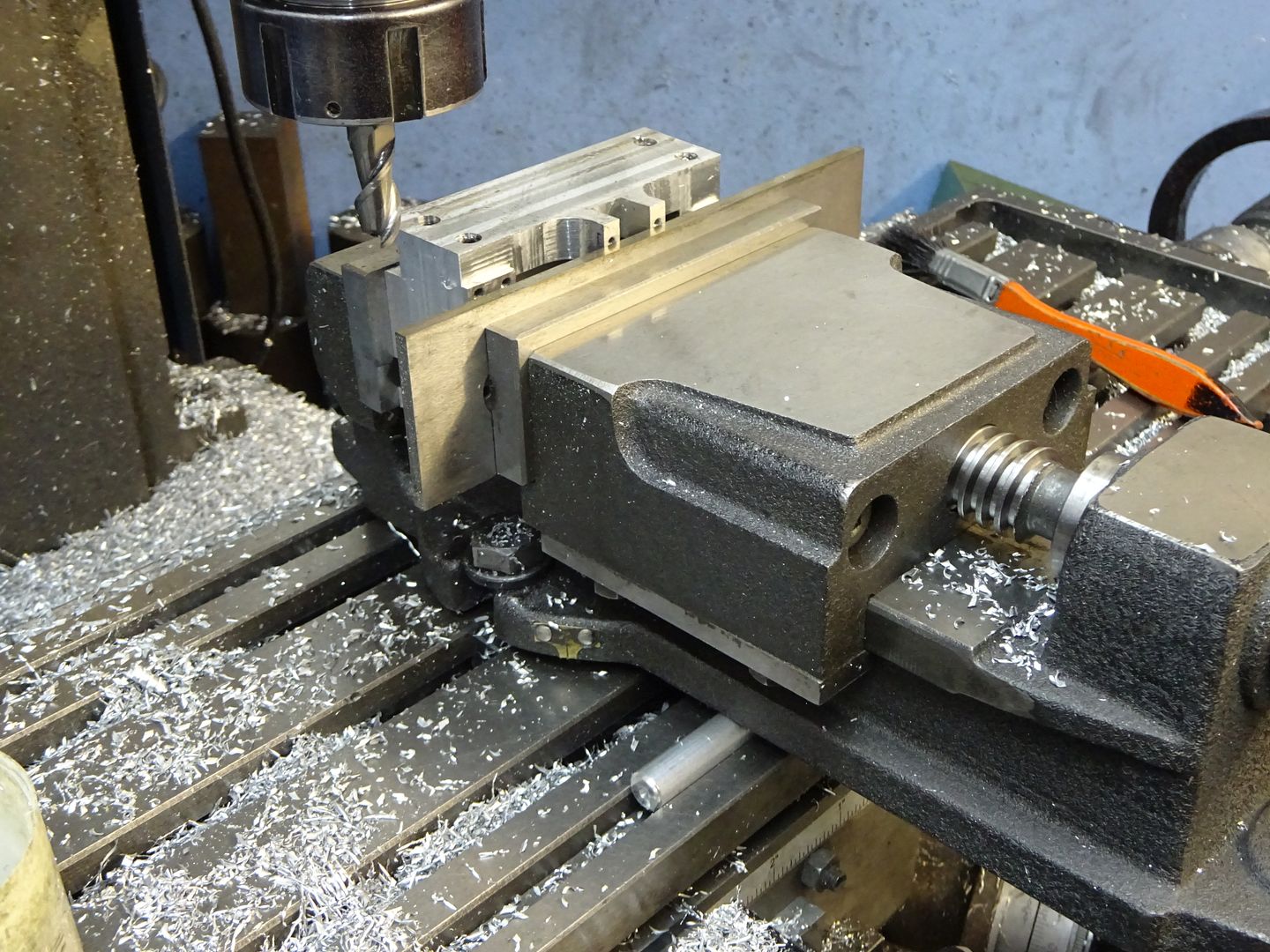

Flycutter will do the sides easily but nay be a bit harder to set up for the ends, probably have to do the end pieces before assembly and sort out a way to the the ends of the sides then a final file all 3 pieces flush after the JB weld has gone off.
Did I show the simple way to angle a vice for this sort of job? easy to work out height of packing if you know angle and distance between points of contact.

So this morning I had a play about with fly-cutting some scrap aluminium.
I used Jason's vice tilt method, which worked well, but I think a longer workpiece will definitely need more support - somehow:
I had to grind the back of my toolholder (under the insert) a bit, because it was scraping on the workpiece.
This was just a random angle, I think it looks OK, perhaps bit shallow. I used to design steel castings for offshore oil platform jackets, and it was always about a 3 degree taper for those.
Here it is de-burred and after a light going over with wet and dry:
And painted with primer:
I think the finish is fine - I was pleasantly surprised with how it machined since I only have 0.8mm radii inserts for cast iron and steel.

You should be able to move the side along in the vice and go at it in two or three stages, I've certainly dome long items like that.
I went with a larger 1.5mm radius and to give the 10mm width at the top that I'm using the angle comes out at just under 4deg
It's not too hard to grind up a round nosed tool bit to go into a small flycutter, another option is to freehand grind the corners of a blunt milling cutter to the radius you want. Does not have to be bang on as after all we are trying to replicate castings that are not perfect so a bit of hand work is a good thing that is why I usually nock off the external corners with a file rather than going for the more regular finish that a corner rounding milling cutter gives and will also run a Dremel over the surface for a bit of texture depending on scale.
I should really be directing you to a copy of my book but here are a couple of examples of mouldings produced from basic freehand ground tools.
I would get all the parts to length first, drill and tap the ends of the four cross pieces and also drill and counterbore the sides first. Then setup to mill the long pieces to profile followed by the end pieces which can be done the same way. Then JBWeld and screw it together on a flat surface such as the mill table - a sheet of thin plastic cut from a bag will stop the work getting stuck to the mill table.
Once the JBW has gone off (at least 24hrs) skim the bottom and then the top, while setup for the top you can reduce heights to leave the mounting bosses and drill & tap those. Also if using through studs for mounting these can be drilled and a counterbore added for the round bosses.
Lastly hold by the sides in the vice at a slight angle so that most of the protruding ends of the side pieces can be side milled off then finish with a chalked file. lastly ease all external corners that would have been cast with file then Emery cloth. Before painting fill assemble screw holes with filler and add any internal fillets with filler or two part putty.
