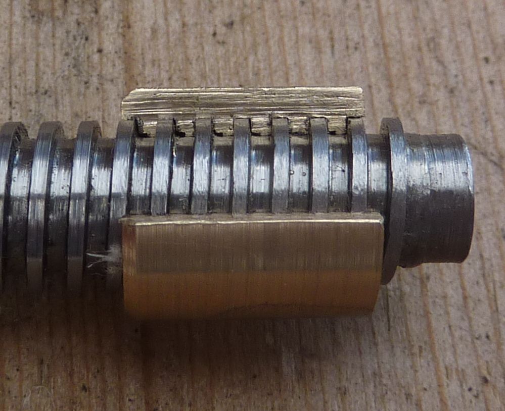

You might try making an aluminium nut and hacksawing it in half longitudinally. Apply one half to the screw and you will see where the cutter needs any "minor" correction.
Being able to SEE how your thread fits the screw is a big help. I was surprised to see the mismatch on the first one. Yet, a quick test would have me believe that it was "good", but the contact area when cut open was very slight and would have become sloppy very quickly.
I made three before I did brass and the brass nut was a really good fit. Another dodge, assuming the screw is worth keeping, is to make a nut that best fits the worn area of the screw and use it to lap the less worn area of the screw. This avoids the loose/tight problem, but only if we are talking about slight wear of the screw. One "safer" lapping compound brand is Timesaver, which comes in grades and stops lapping after a certain point. Of course, use a very fine grade, frequent testing and meticulous removal of the lapping compound. When you have the threading process working, make a few extra brass nuts. It takes very little time passing before you forget how to set-up and cut a proper left hand Acme thread.

Posted by Paul Fallert on 03/07/2020 16:43:01:You might try making an aluminium nut and hacksawing it in half longitudinally. Apply one half to the screw and you will see where the cutter needs any "minor" correction.l
Thanks Paul. Sounds like a good tip. I might do that with the 'wrong un' - like I said, it's a learning experience.

I took Paul's advice and sectioned the left handed nut. I generally find that my compact camera is pretty good at really close up inspection so I took some photos in daylight and artificial light. None of the photos is perfect but I present the better ones here for your personal perusal.
The nut (before sectioning) was very tight on the thread and I could only get it onto the thread by clamping it in the vice. It got stiffer the further I went and I never quite got it all the way through. I got the same result from either end. Had the cutting tool not come loose I was intending to take one more thou (radius) to deepen the thread.
The threads on the tailstock screw measure with calipers at 0.85mm. I think there is wear but it is pretty even along the screw. For comparison the very end thread on the compound screw measures a full millimetre.
The odd 'step' in the thread is because I was unable to correctly 'pick up' the thread for the second session so you have a partly cut thread overlapping the almost fully cut one.
