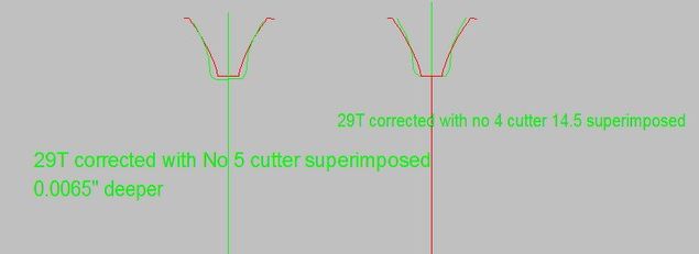

![]() 5068 forum posts 3 photos | Posted by Simon Williams 3 on 21/03/2017 23:28:39:
Well, that's a low blow, what! So I guess it's easier to buy the spares than a whole new set of cutters. Bother! But that means that the transfer gears and my magic combo should all be 20 deg PA as well. Blow that for a game of soldiers. The change gears meshed with the tumblers, what's going on? Looks like I'd do better to replace the tumbler gears and the one on the spindle. No rest for the wicked.
Sorry Simon, my bad in that not thinking I did the 29T gear at 14 1/2 degree PA. As you have found out they will mesh, a lot of overthought is put into gears which are actually quite crude, hence your alloy one.
Where PA really counts is where speed is concerned and in turn noise. Some years ago I sent a batch of 20 T 20DP gears in for some racing bikes to be cut and they cut them at 14.5 and not the 20 degrees on the drawing. Not easy to see and i went ahead and built these engines up and they fitted with no problems given all gears need some clearance. However on starting these engines up they howled really badly and it took a while to locate just what the problem was. A new set of gears were cut at 20 degrres and problem solved.
Later tonight I'll do the same exercise with 20 degree and a o 4 cutter in 14.5 to see what the difference is. Im betting not a lot.

John Stevenson | 23/03/2017 00:18:45 | ||||||||||||||||||||||||||||||||||||||||||||||||||||||||
![]() 5068 forum posts 3 photos | Simon, Thanks for that chart, no doubt it will help other users of the early gearbox's but only if they can do a 30 /17 and 29/16 cluster.
I went back and examined the 14.5 and 20 degree differences.
Quite a difference. The one on the right is 29T corrected but at 20degrees PA with the original No 4 cutter at 14.5 PA superimposed. As you can see nothing like.
The one on the left is using a No5 cutter 21T to 25T range and cut 0.0065" deeper. Again loads of under cutting but the flanks are a good match. | ||||||||||||||||||||||||||||||||||||||||||||||||||||||||
Simon Williams 3 | 23/03/2017 00:31:32 | ||||||||||||||||||||||||||||||||||||||||||||||||||||||||
728 forum posts 90 photos | Thanks John, looks like the couple of thou I added on to the DOC "just to be sure" were well invested. Best rgds Simon
