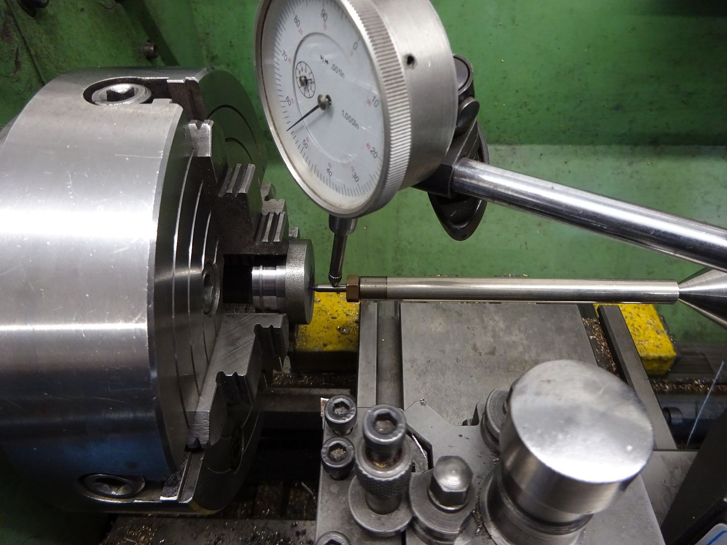

Didn't have much workshop time today, so prepared material for the split main bearings.
Hacksawed the square section brass bar into radius sized pieces (the only size I could get was too small to cut in half and re-solder, so I had to offset the cuts:
Milled them flat, with identical thicknesses:
Tinned and sweated them together:
Them milled the assembly to clean-up the sides:
Centre drilled ready for fitting in the 4-jaw chuck. I did this knowing that the offset from each side to the join was identical, and after checking everything was correct with the edge finder. I thought it would serve as a method of double-checking my centralising of the piece in the 4-jaw; I can centre using the telescopic pointed shaft thing, and also using the dti on opposite faces. Pretty confident it's spot-on though:
One question regarding this: I assume that if this single bar is for both bearings, then I bore all the way through (in order to be able to get the journal lengths fully engaged beyond the crank spigot), periodically checking fit on the shaft? Once parted-off for the first bearing, I'd double-check for fit on the other journal? I assume that the bore will taper slightly, so, assuming both journals are identical diameter, the second bore might need a spring pass or perhaps a few?

You can put the dti on your sprung guide and clock the movement of the ctr hole which is how I usually do it. Back end of the guide wants to be free

Thanks Jason, yes that what I meant. I’m not sure what you mean by back end wants to be free though?

Don't hold it in the tailstock chuck, mine is free to move about as it is supported with a ctr. Though a pointed long length of say 3/16" rod would flex so could be held rigidly.
