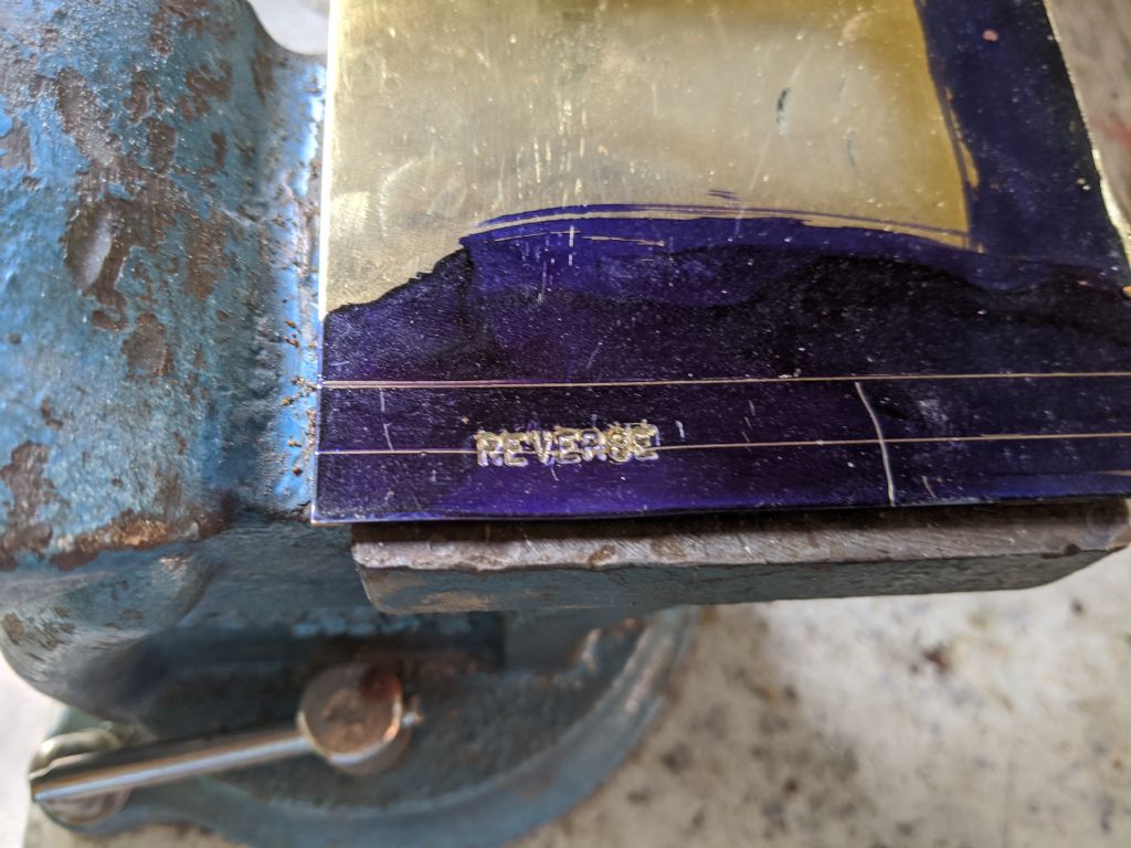

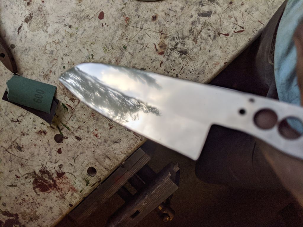

PROGRESS!!

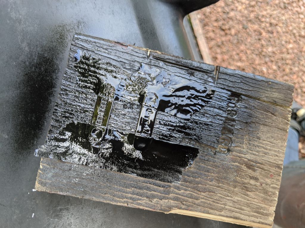

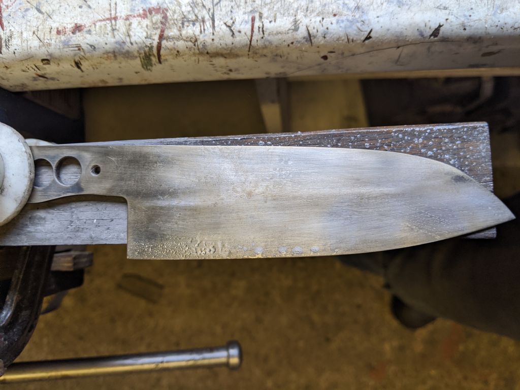

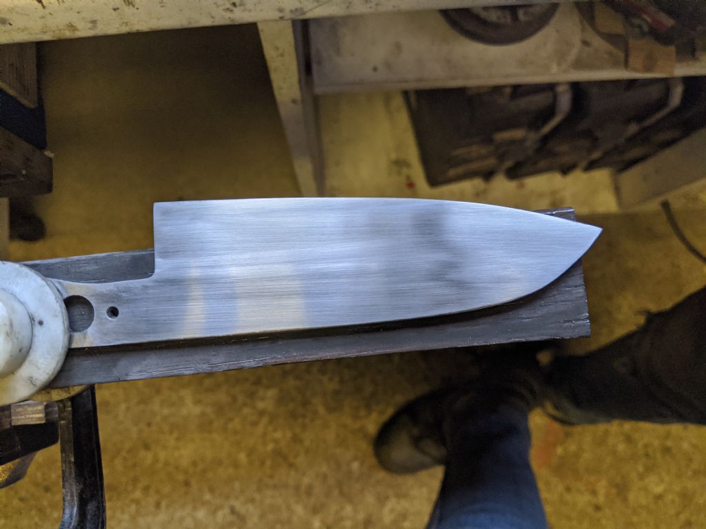

I heat treated the knives as expected, had some warps so had some fixing to do.
So I had an hour or two spare while the knives were tempering in the mini oven.

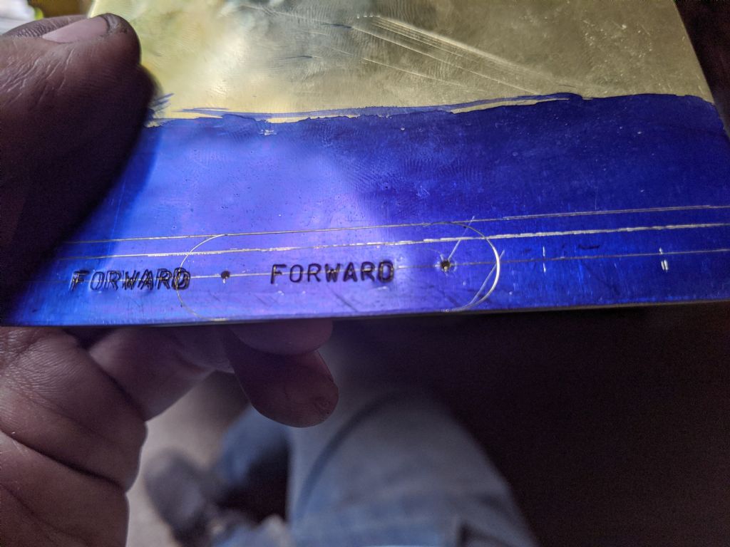

First one went a little squiffy when I tried to make it deeper
Funilly enough, I currently only have 2 E's, so I had to do this by overlaying the other ones.
I have some more letters on order, but they're backordered for a few more weeks, so I thought I'd have a go.
Ready to be fitted tomorrow. I'm very pleased so far. They look much better than F. and R. written in marker pen
I may try to deepen the O and the R a little.

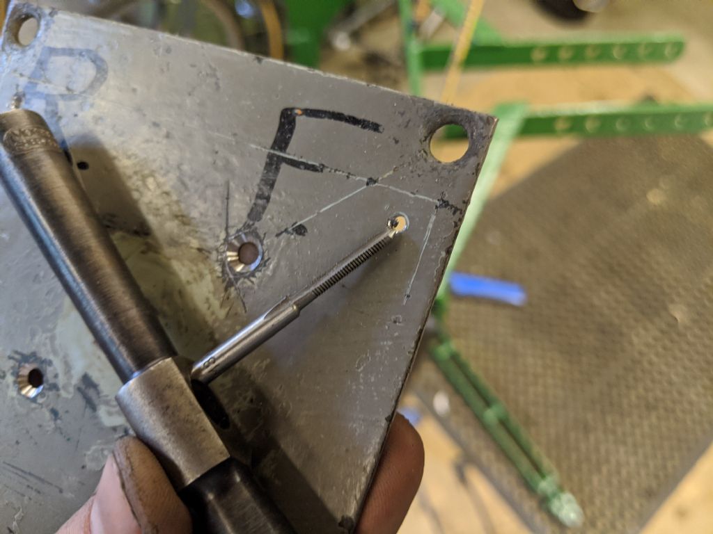

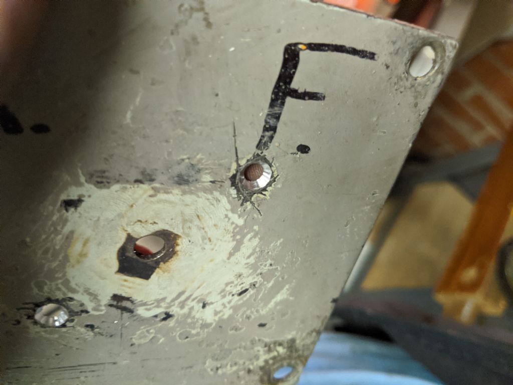

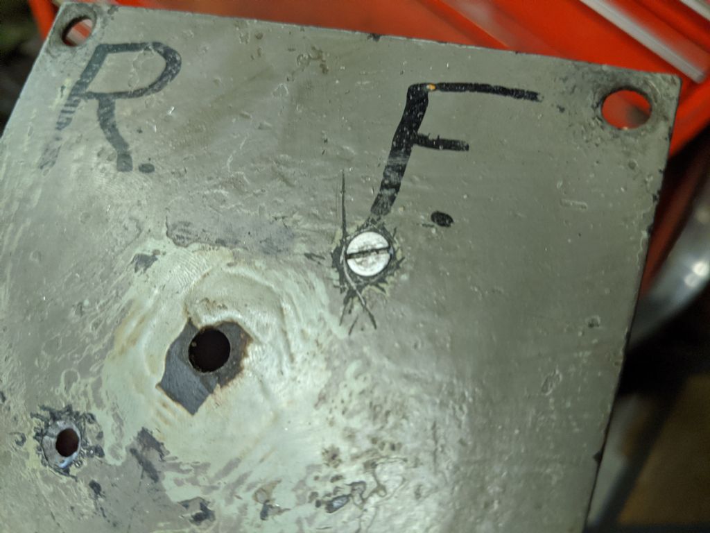

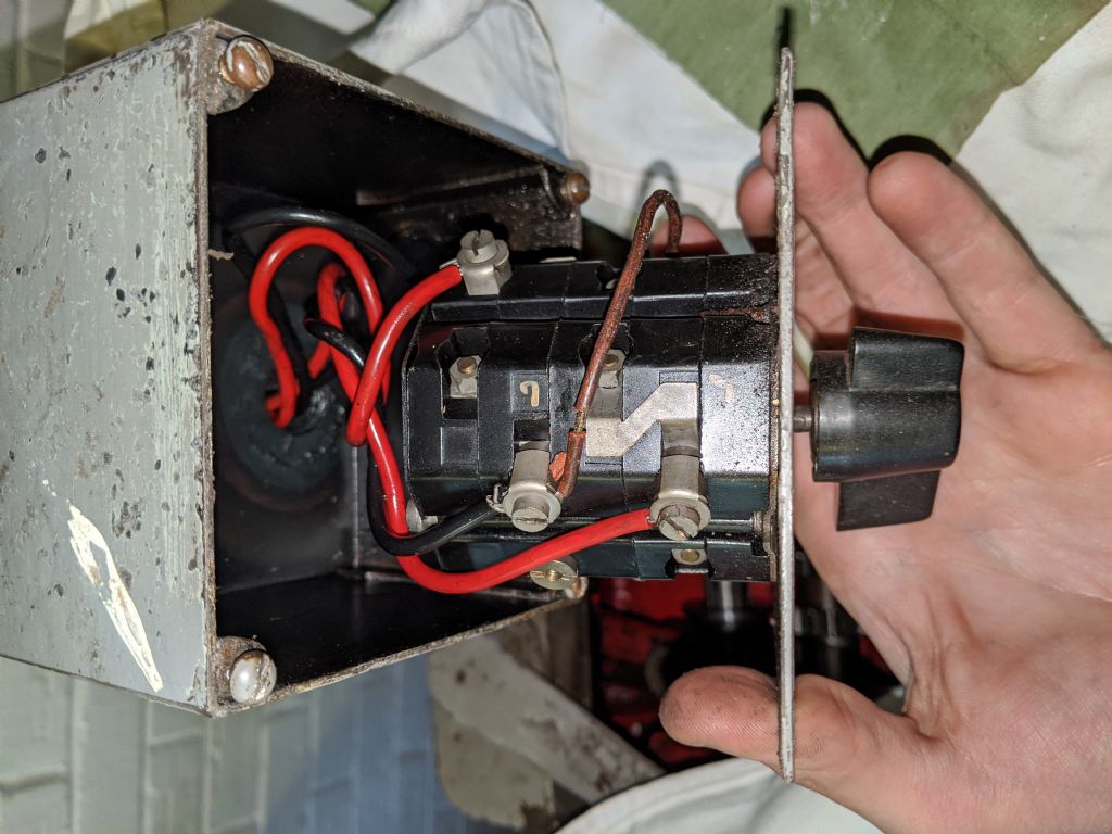

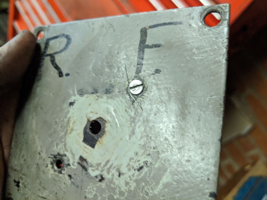

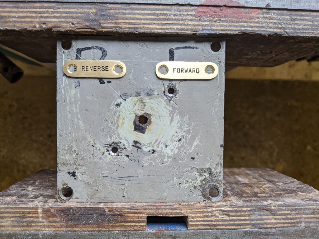

So this is what the switch originally looked like. Nice and rough with beautifully handwritten F and R
First step was to take it out and off
It was held on by 2 countersunk screws, which were going through non countersunk holes.
So I countersunk the holes so the screws are now flush, cosmetic improvements only today.

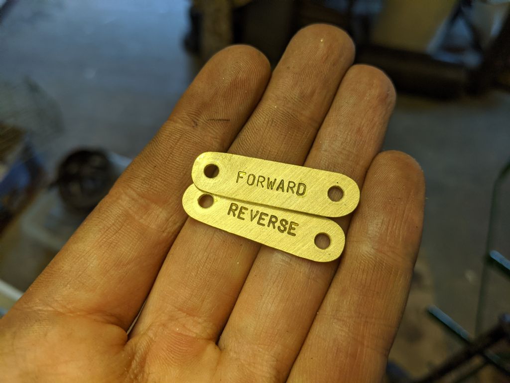

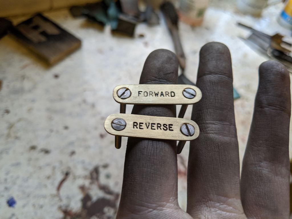

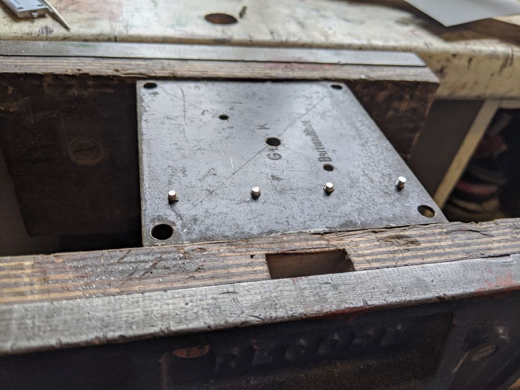

Then I laid out the new labels and marked where I wanted them to go. I did one hole for each, drilled and tapped, then marked the other hole from there so they both lined up. This worked well

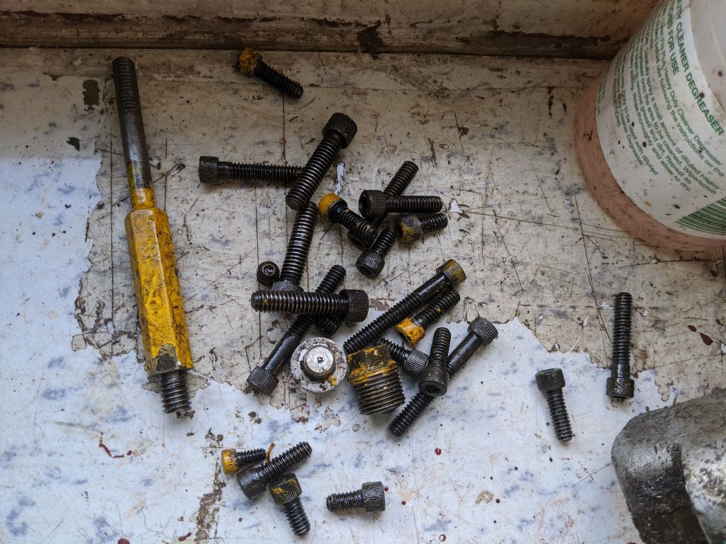

Then I had 4 long m3 screws to cut down. They didn't interfere with anything inside, but it made screwing them in and out much quicker
The F and the R mostly rubbed off with a bit of acetone. But It will be fully repainted one day!

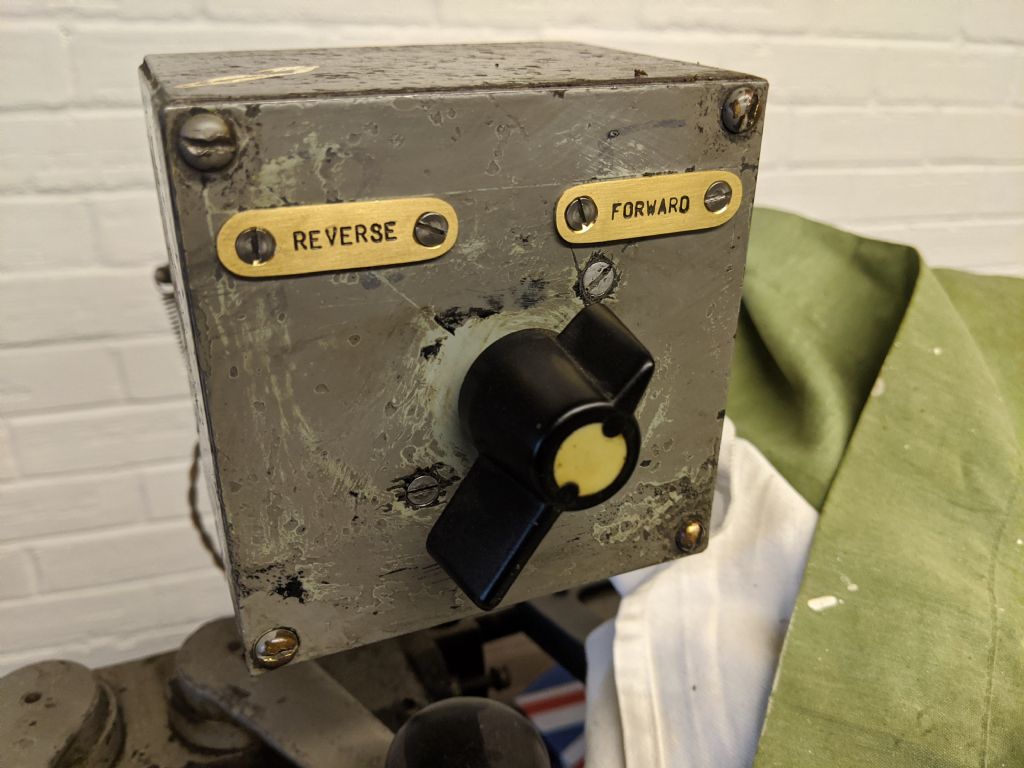

Then at last I put it all back together
I'm very happy with how they came out. Not original, but much more fitting than permanent marker!
I did end up deepening the O and the R from forward, so it blended a bit better. A minute difference that you wouldn't notice unless I told you.

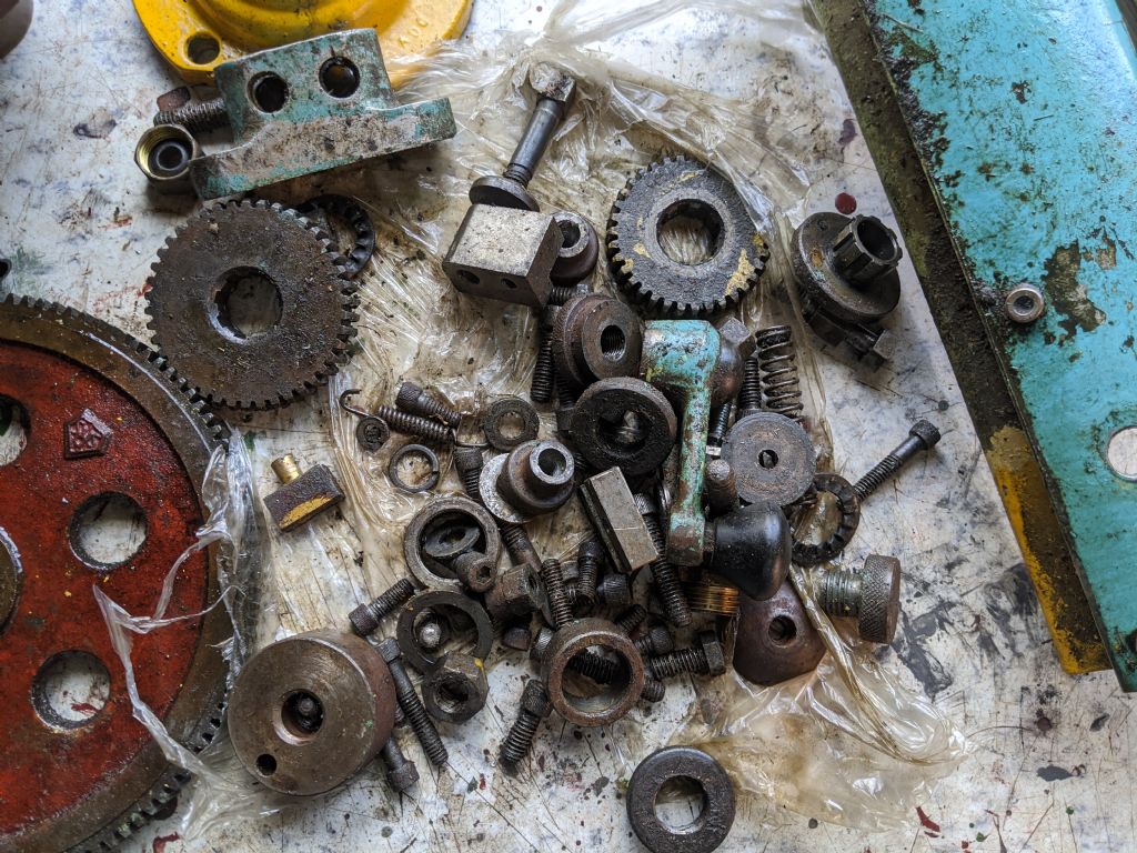

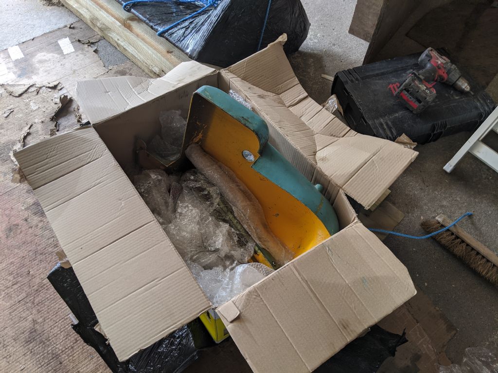

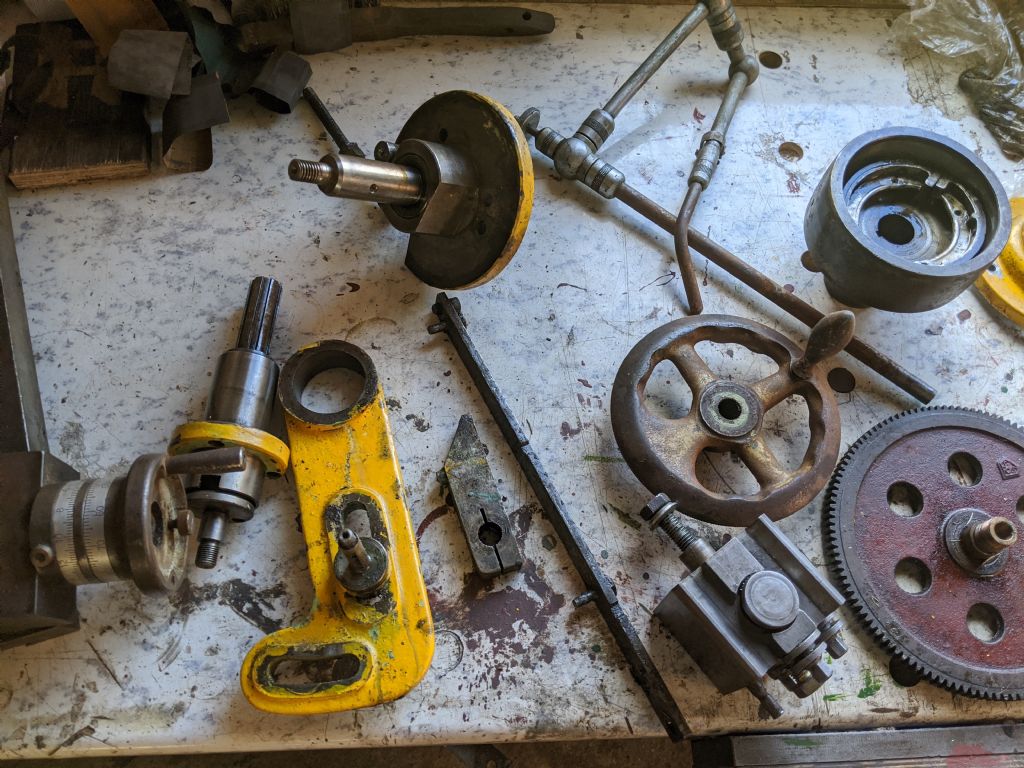

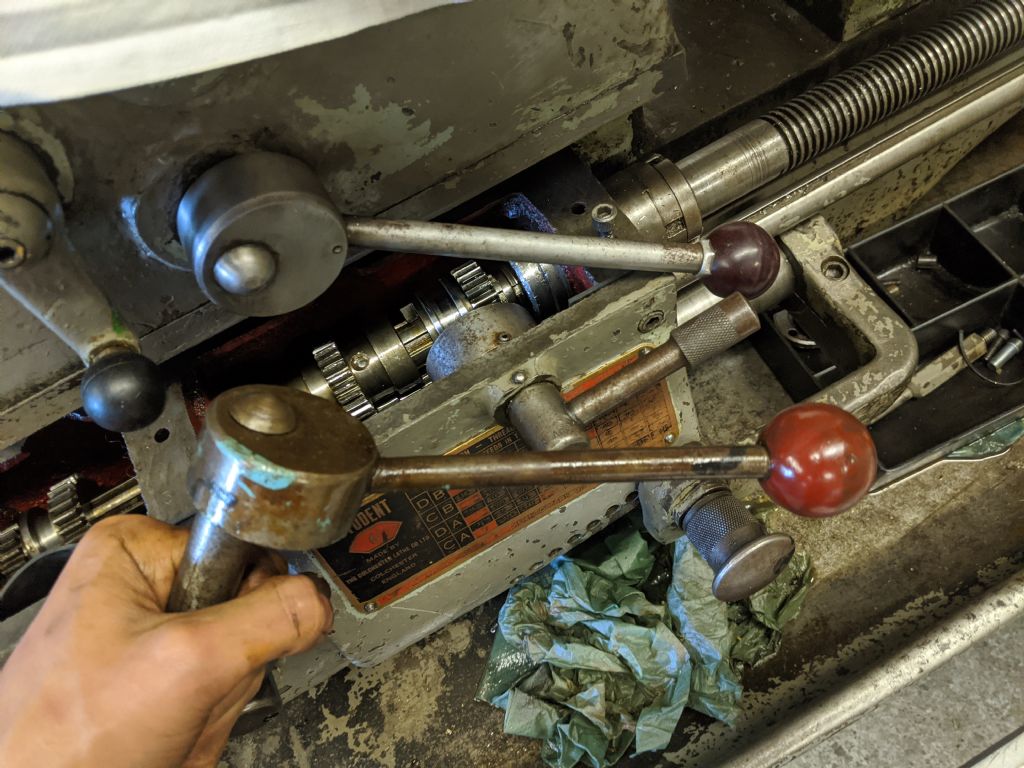

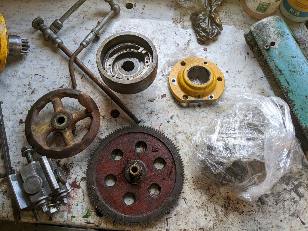

Parts have arrived! The main 4 parts I needed are exactly as I wanted, so they can be replaced easily
There is much more than I need. So now I have spares, which don't fit my machine either
End cover, not needed and wouldn't fit anyway
Backsplash needs a good clean then I'll see how/if it fits
New on/off lever, no slop in handle and I can swap over the red knobs so mine will stay the same colour. Perfect
Lead screw spare I think, with dials I won't be using.
Interestingly the gear box cover there is aluminium instead of steel like mine. The holes to mount it are also in different positions.

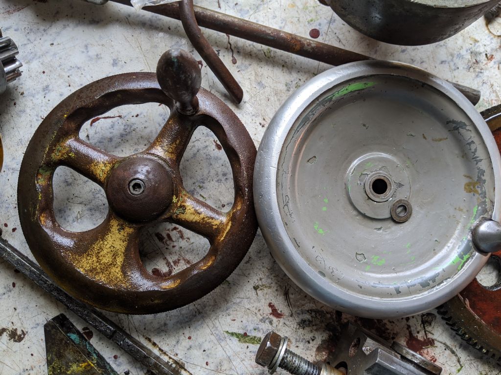

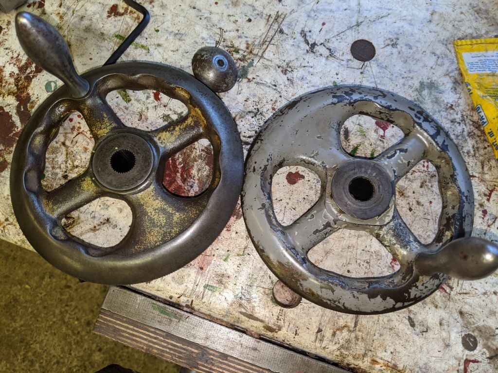

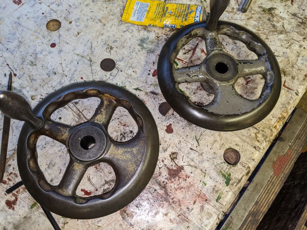

Handwheel is very nice, so I'll be swapping my non original for it. Think it needs a good clean and polish before that though.
The toolpost seems to have been mounted just using a bolt and 1 locator hole. Not sure how beaten up it is. I may still just get a new one and stay away from the more expensive tool holders.
Pretty much the whole compound and most of the cross slide, the top part including the nut and leadscrew
Assorted bolts and nuts and small gears. None of them have chipped teeth, so I may swap a few over if any are the same
Much better

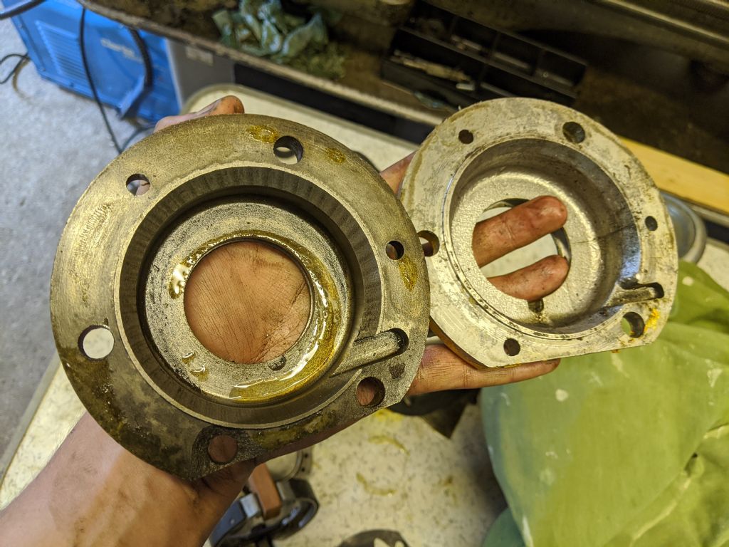

This bearing housing is also aluminium, which I need to use. So I'll have to get the etch primer out!
The knurled knob that goes onto the end cover fro the lathe is the same thread as the one on the threading dial here, so I've used one of the spares to go on here. It should have had one on here anyway, so it'll be much easier to engage and disengage. Spanner free!
So, lots of parts, a few I'm unsure of what they are, which is impressive considering i've taken most of my lathe to pieces. So there must be more differences in the models
I imagine there will be spares if anyone needs anything. I'll probably put it on the Colchester forum as well. No point me having parts that don't fit

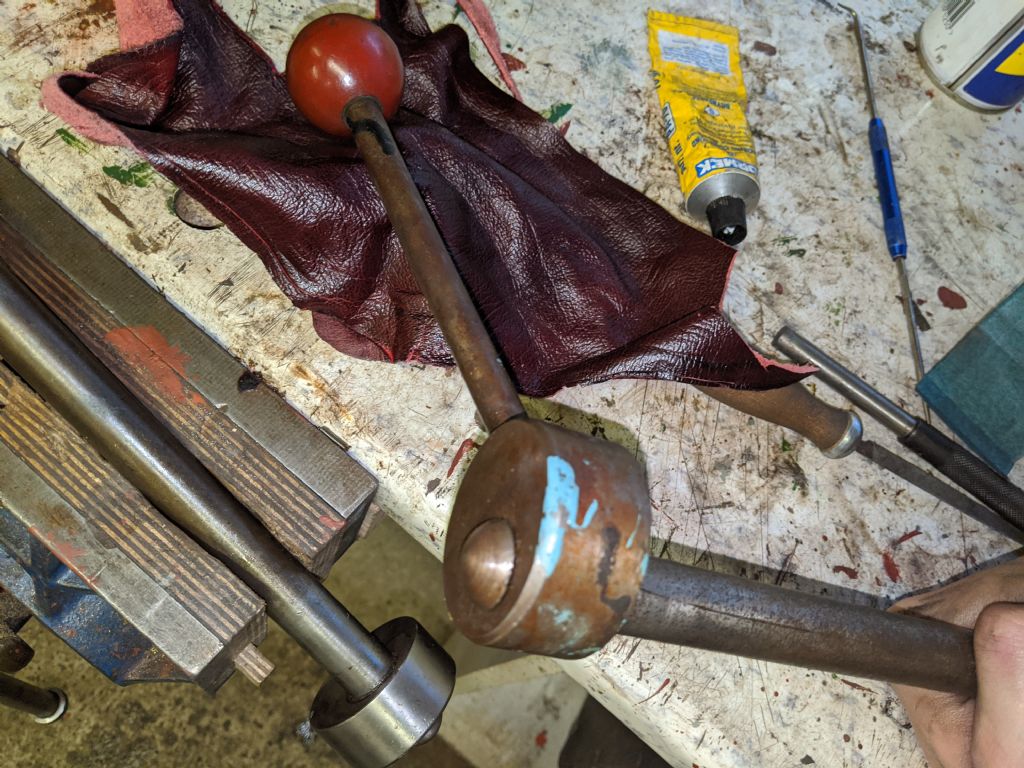

Lots more progress made this evening.

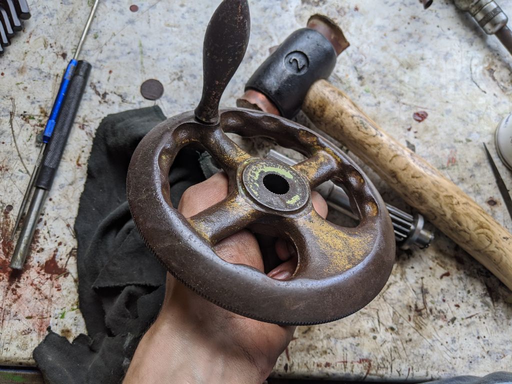

Firstly I looked at the on off levers. They are almost identical. Except the new one isn't worn! So it will be perfect. but only if the ball comes off the original. I don't like the brighter red one...

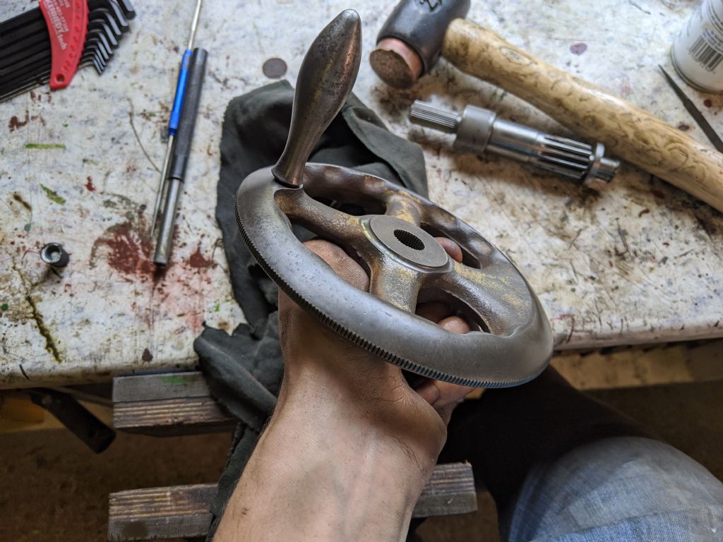

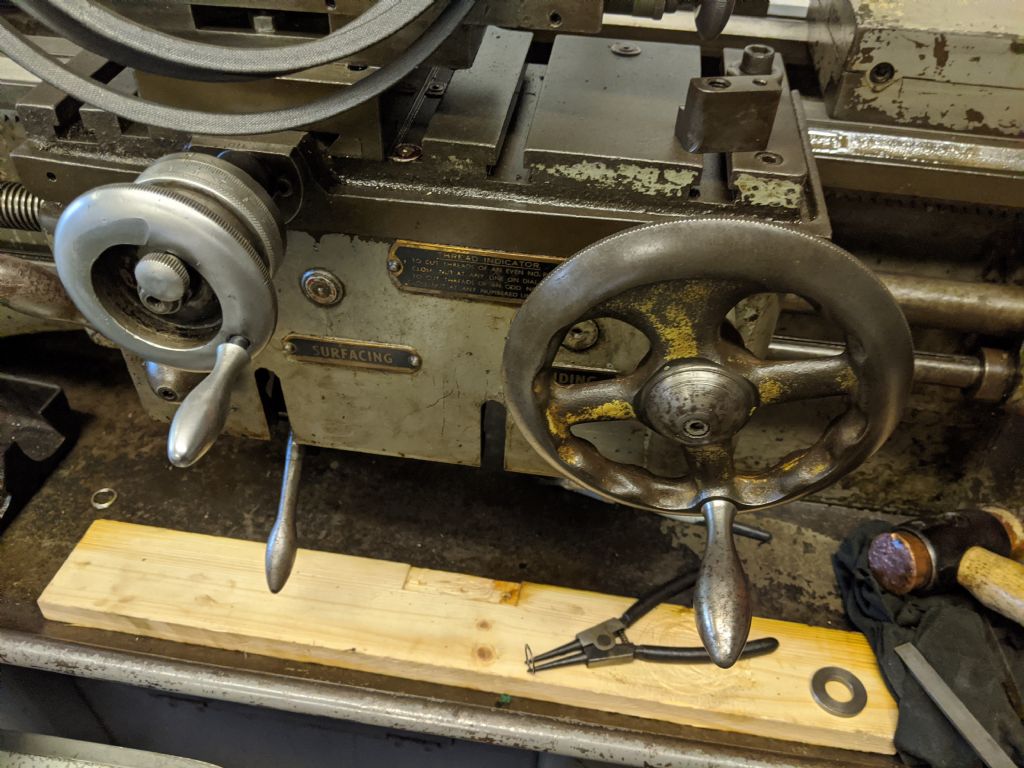

Then I got to work on the apron wheel. I took it to the wire wheel and polished it up a bit. Not its final finish, but close enough for a quick play today
Then came a very important task. The splines were full of crud and rust and all sorts, so I spent an hour filling down the inside of the wheel so it now pushed on and off with a little bit of force. Not too tight, not too loose.
It looks fantastic, I'm very pleased. However, It most definitely needs a lick of paint(more so than the rest of the lathe)

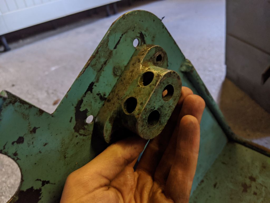

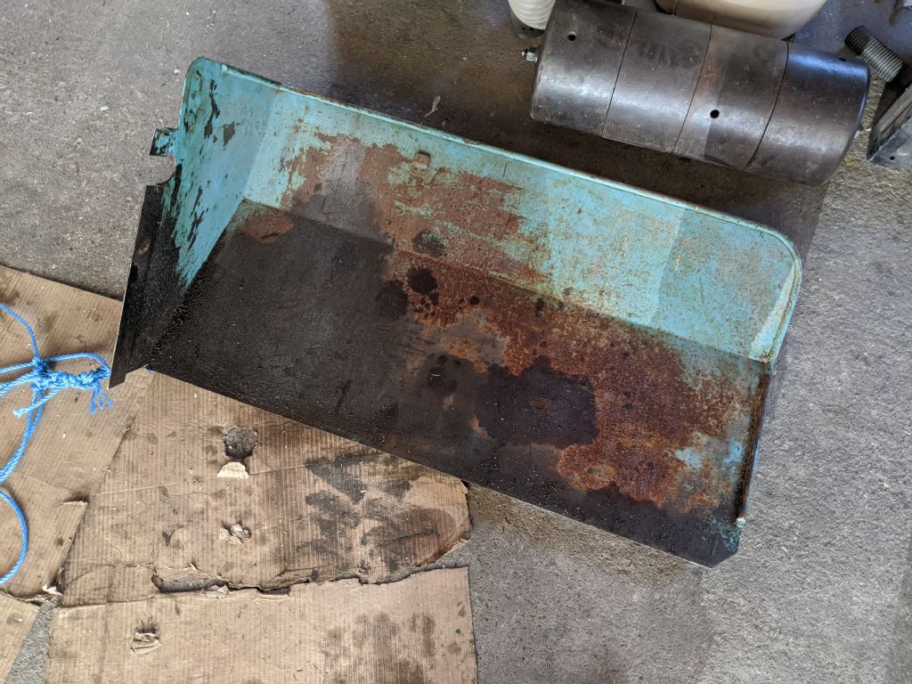

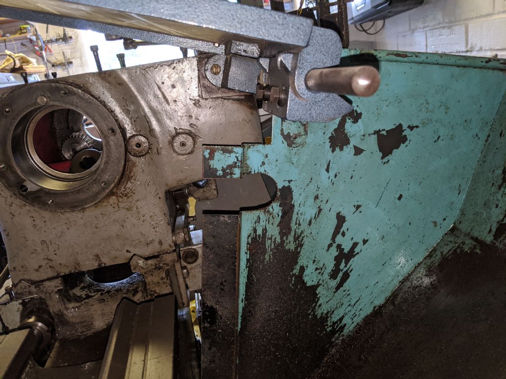

Then I had a look at the backsplash. This part seems to go on here? But I don't know what It's for?
Then I had a little mock up of where the backsplash attaches. It looks perfect. From what I remember it's not the same shape as Hermans and Phils, but it has a space for the two holes in the back of the headstock to pass through. Which I think is for the taper attachment? I'll have a go at fitting this after I've given it a clean tomorrow.
I thought I'd take the wheel off the tailstock while I was cleaning things. So I removed all the paint from the areas that shouldn't have been painted; They both still need fully stripping and painting nicely
Meanwhile, it's looking better

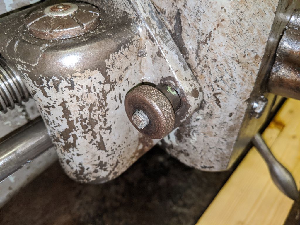

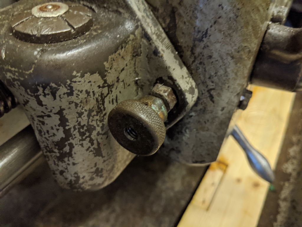

Then I removed the nut that was on the threading indicator mount bit, and I put on the Knurled thingy. Looks and works much better

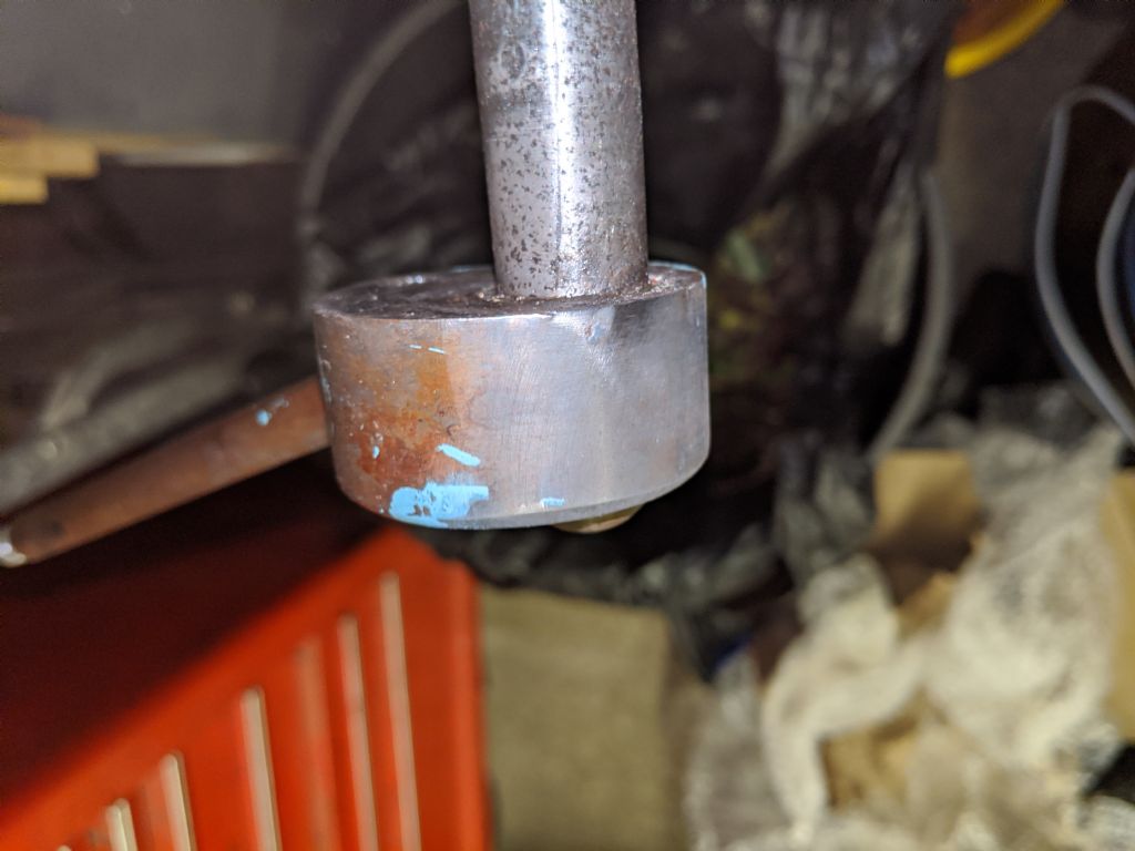

Then I moved onto trying to swap over the balls. The new ball came off without any struggle, but the old one put up a bit of a fight
Then just onto cleaning
I went to look at the end and try to thread the bolt back into the new one. Looks like there isn't a thread, I'll have to consult the later manuals to see how it should be held in place on the new ones. I think I will probably drill and tap the hole that is there. Possibly m12 if there is enough wall thickness(looks like there should be)
Then I realised that I haven't seen the apron carriage wheels button spacer that goes in the middle. I had it earlier but it's gone walkabout and I cannot find it for the life of me. That's one way to ruin what would have been a perfect night! The search shall continue tomorrow.
I probably won't clean these parts too excessively. I don't see the point polishing them like Herman has(even though his look amazing) Definitely rust-free, but I don't need to be able to see myself, at risk of cracking the parts then!
After all, A LITTLE BIT OF RUST IS NOTHING TO WORRY ABOUT!
It should be where the lamp mounts. The lamp has a mounting bracket with the same holes.

Mid day update, More progress.

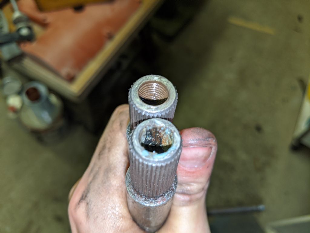

I tapped the end of the shaft to m10 as there was enough meat there. It was over the drill size however, so I tapped extra deep so there is more engagement so the pressure is more spread out. I also used a bolt that is twice or three times the length. So that will fit nicely now.
I couldn't see on the diagrams in the manual how this was meant to fit as it was a bit complicated as the model was meant to have the forward reverse switch going through this shaft too? Or at least it was in the manual
Then I got onto cleaning up the handle and shaft properly. The little button at the front came off accidentally. But it made cleaning a lot easier. It was quite scored so I put it in the drill press and cleaned it up a bit. Nothing too extreme. I don't see any point making it perfect as it would take a very long time, and then I'd have to get everything perfect
Then I gave the old ball a bit of a polish on a very fine buffing wheel with some very high grade compound. It shined up nicely. Once again, not removing the dents and scratches, but just making it look a little bit better.
Then It's all done, Finally a satisfying click instead of a sloppy handle! I believe the feel of the machine is very important. The better it feels to use, the more I'll want to use it!
Upside down, but still shows the same thing. The mount for my light isn't original, but the holes seem to line up for the mount. So I will probably need to machine something to make it fit nicely. I'm not too sure how it's meant to be done. Does anyone have any pictures of this?
Then I moved back onto the Apron wheel. A little more wire wheeling and it was looking good enough to buff. I can't see myself in it, so it's safe. But it definitely looks the part
Then I stripped all the paint, cleaned it and put a coat of red oxide primer onto it.
Productive morning, time to look at the backsplash
Phil Whitley29/07/2020 21:09:09
avatar
1533 forum posts
147 photos
back splash is what you get when you haven't got a splash back!! That one looks the same as mine Richard, but the handwheel is a lot posher than mine, which does not have the corrugations on the inside of the rim. The 2 hole bracket on the splash back is for the early type of amglepoise lamp I think, is it not like the one you have?

As it turns out, the yellow bearing cover replacement part that I wanted is the wrong size. The last of the 3 mounting holes doesn't line up, so i'll have to fix the old one somehow
