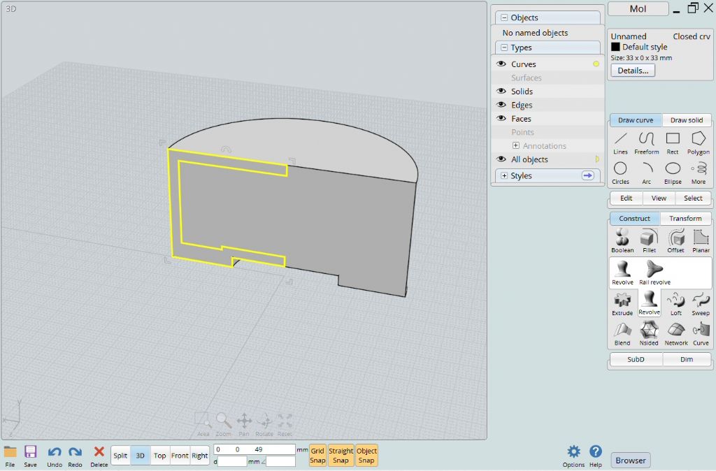

Very interesting videos Martin, thanks for taking the time. I tried a rotated sketch this evening as suggested by Jason. It did not go well. I drew a closed curve.
And then revolved it around the right hand side.
The head was solid, no internal void. I undid that.
I then drew a vertical line 1/2mm to the right of the sketch and revolved around that.
I got a hollow head, no jokes please!, but of course it's wider and has holes in. I then extruded the sketch to make sure it was valid.
I am missing something, but I can't figure it out. I did try different variations of the revolve, and managed to get two solids. The head, and the void, by deleting the two small uprights on the right hand side of the sketch. I boolean cut the void from the head to get a hollow head. Before posting this I tried the same sketch in FreeCAD and it worked perfectly. In your first video you revolved the base of the head and that worked OK. I tried full 360 deg revolves and it made no difference. The 180 deg revolve is to make the inside visible.
Thanks for making it clear that I have spent so long without a mirror function in Designspark, that I have been drawing things like the inlet/exhaust tracts twice. Mirror will take some getting used to!

I think you've found a bug! I've never seen this myself, but I can repeat it. I'll post a notice on the MoI forum and see if Michael will take a look.
Well done! wink

I'm using v5 and can easily repeat it, so it's one of those 'obvious' bugs that only new users seem to find. smiley
I've done a video of the problem for Michael so I'm sure he'll look into it. I know he's busy integrating the ACIS kernel into MoI at the moment, so we'll see what he says.

Does Moi not have the option to make the part transparent or give a sectioned view so you can see inside? Or even supress the initial rotation.

Martin, I read the reply by Michael and that's the way I got it to work.
Jason, as far as I know, there isn't a tranparancy or section option, only wireframe.
