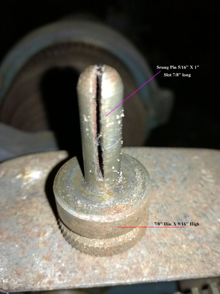

Hi Haydn, three photos below, first is the Gear train, second is the Leadscrew end and the third is the Spindle end. None of the change wheels have a keyway cut into them and are all driven by two pins in all of the change wheel gears and the ones mounted onto the banjo, just have a straight pin to fit the bore of the wheels, just a tad longer the thickness of two of the wheels. The pins have a threaded portion, long enough to pass through the banjo with a nut and washer. The front of the pins are drilled to take a sprung split pin type of thing, fixed into the caps that can be seen in the gear train photo. There is a collar with two drive holes, same as the wheels on both the spindle and the leadscrew and these are held in place by a grub screw, the one on the spindle has a small flat and the one on the leadscrew is a keyway.

The next photo shows the extended change wheel pin that is mounted onto the fork on the headstock, which is carrying the 50 and 30 tooth wheels in the above photo and has the dimensions, with the exception of the screwed portion through the fork with a nut and washer on the other side, and also shows the hole which the sprung pin goes into.
This is the sprung pin that holds the change wheels onto their pins, these appear to be turned from a sold bar and just slotted.
This is just an unused change wheel pin with the sprung pin just entered into the hole in the change wheel pin, which can be seen at the bottom-right in the top photo.
Hope all this helps.
Regards Nick.
