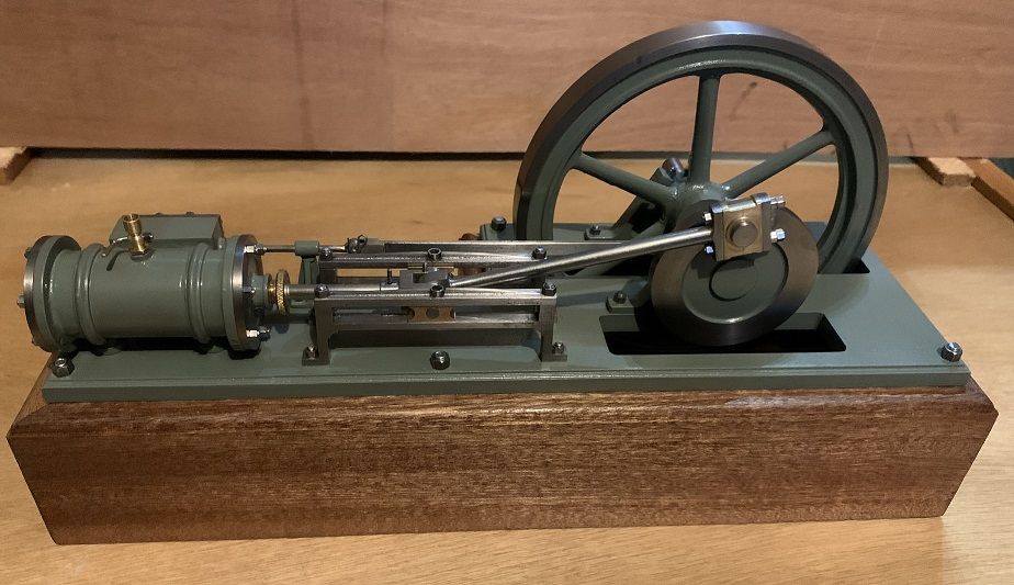

Finally completed my version of the engine so thought I would upload a couple of photos.
I repositioned the steam inlet so I could recess the valve cover.

That looks to have turned out rather well, the slightly larger flywheel does not look out of place and the colour is nice and subtle plus it makes a change from the usual dark greens and crimsons.
How does it run?

Thanks Jason,
I was inspired by your use of muted colours for my choice.
The flywheel was not ideal, but what I could get hold of reasonably easily at the time, I don't think it looks too bad, but when I compare with yours I do like the slimmer smaller design.
It runs okay, though have only been able to try on air.

Nice work James a very good job and the flywheel looks fine to me, the grey colour suits it well. good luck with the next project i'm sure it will turn out as well as this one has.

Hi James Love the colour.

Just add my congrats, very nice indeed and for me one Jason's best designs.
I too love the colour, it looks like my favourite, Halfords industry grey?
Geoff

The colour is Rustoleum Sage Green, was about the only colour the local hardware shop had that came close to what I was looking for, and now its on I do like it. I have plenty left in the can so I can guess what colour the next one will be !
Thanks to Jason for the series, it was a good build with plenty of learning along the way, so I think I have gained a lot of experience during the build.
