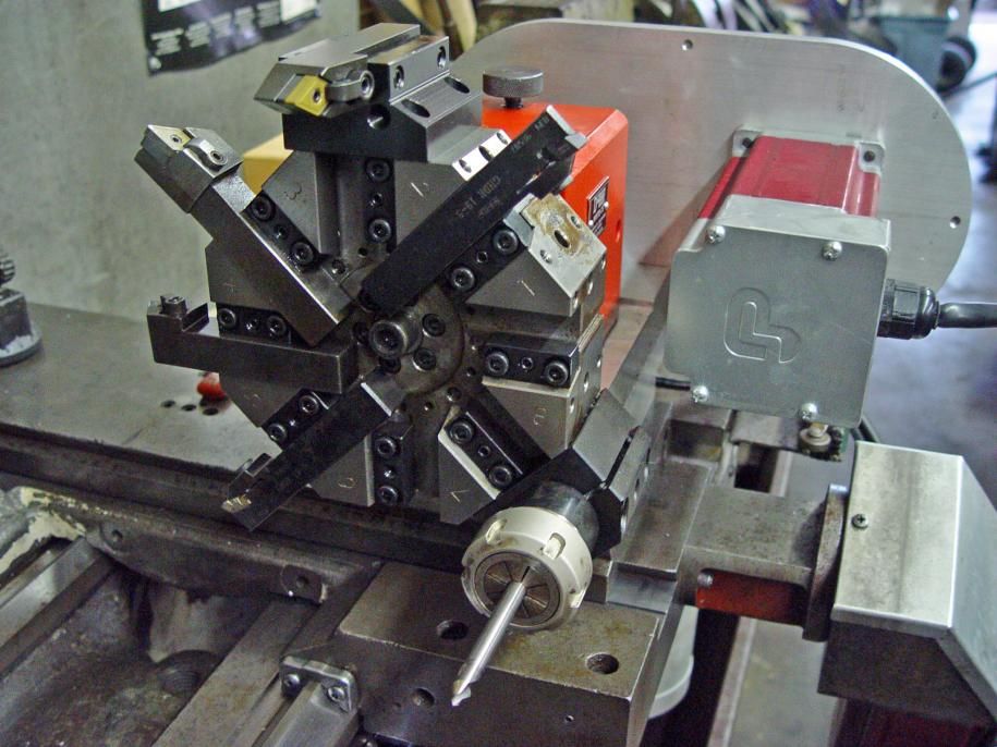

The ATC design is also a juggle of compromises. How many tools to accommodate, Tool clashes with headstock, chucks, etc, choice of inverted or conventional-up tip tooling, etc. Then of course how the changer will actually work - I have not got my head around that part yet!
There are many articles on the internet of DIY ATC's for a lathe, but I fear most of them are, in my humble opinion, simply a hack. The way they are machined, the accuracy of positioning and placement of tooling can only mean misalignment with the spindle axis at the best. I am not sure at all of the route to follow - The positioning and locking mechanism has not a simple solution - it must locate accurately, must lock firmly, have no play which will promote tool chatter, etc.
So I started with the simple part - the tool plate..
I decided on 8 tool stations, 4 of lathe cutters - normal facing/roughing/profiling tips, as well as threading, grooving and parting tips, and 4 stations to accommodate drill bits, centre drills, boring bars and internal threading tips.
I looked at MANY ATC's out there...
One of the big issues with tool placement and tool plate size, or rather , diameter, is the potential of a crash of axial tools ( boring bars, etc) with the headstock and chuck. Since my lathe has no chuck, that problem went away around the corner, and like LinuxCNC, came around the other way and bit me in the backside! The 5C collet spindle is almost flush with the headstock face, so there is no elongated space for the axial tools to flail about within..They will smack the headstock. The only way to prevent that is to have an axial tool placement radius of nearly 170mm, ie, a tool-plate diameter of more that 340mm - That's Big Haas lathe territory!
Headstock with no room for axial tool bypass..
On top of it, the current spindle implementation leaks oil and all my modifications to the oil well, the labyrinth seals, oil level, etc, have been wasted - it still leaks unacceptably.
So, a new spindle is in the works, with a trial taking place with greased bearings to see how they do for 20minutes at 4000 rpm, etc, etc....And the new spindle will be fitted with a 4inch OD, 5C collet chuck from Bison-Bial..
The design of the tool-plate is now a lot simpler, and has worked out nicely. I need to now work on the actual positioning and locking mechanism, but am a little lost - no neat solution apparent at the moment!
Here are some typical examples of tool-plate layouts - lots of similar to see, but few insights into the gubbins in the boxes..!

And my 3D models of the present design.( click to see a larger image)
Tools are operated inverted - swarf goes down, not up!
Rear of tool plate with spin-shaft.
Lathe tip-tools are held in place with taper wedges ( lilac below) and clamped with the pink clamps.
Joe

mgnbuk19/04/2021 08:34:44
1394 forum posts
103 photos
The usual method of positioning on industrial turrets is with a Hirth / Curvic coupling between the disc and the body. With that, there are two basic solutions - the disc + half of the coupling moves forwards to clear the body coupling teeth before indexing, or the body part of the Hirth coupling can move axially within the body (but constrained radially) to allow the disc to rotate without "lifting".
Hydraulic operation of clamping is easier, but indexing is a bit more awkward - the Taiwanese all hydraulic turrets on various lathes at work use a complex Geneva indexing method using a hydraulic motor & rapidly "step" between positions. Control is quite simple, though, using a couple of proximety switches to count stations as they pass + a reference position switch & clamp / unclamp switches. A counter in the PLC gives a representation of the disc position, being incremented / decremented by the count switch depending on disc direction. The counter is a "ring counter" preset in the PLC with the number of disc stations that has no zero value. Usually the disc is indexed repeatedly to find the reference switch on the first tool call after powering up - at this point the "ring counter" is preset to the current station number (usually station 1), though some manufacturers make referencing the turret part of the initial machine reference procedure & some others use battery backed registers in the PLC memory to remember the disc position set at the point the machine was powered off, so no referencing required. One Cincinatti machine at work saved the cost of the reference switch by making the operator manually index the turret to station 1 & then confirm the position was set via the operator interface - many ways to achieve the same end !
All electric turrets use one motor to clamp/unclamp using a cam and a belleville washer stack arrangement, then index steplessly after unclamping. This type (variously made by Sauter, Duplomatic, Baruffaldi & Pragati) are mechanically complex and use a lot of precision ground hardened parts + a special absolute binary or BCD encoder for disc position + a solenoid operated plunger assembly for the locking arrangment. They also require quite a fast PLC to run them, as the timing of the locking plunger solenoid operation is critical. Locking is by reversing the motor after the locking plunger engages until a proximety switch actuates. There may also be an electromagnetic brake to lock the motor shaft after the "clamped" switch makes.
It should be possible to do a hybrid - hydraulic clamping with electric indexing - without undue difficulty, I think.
Live tooling drive to rotating tools in the turret is another can of worms to consider ! We have one machine at work with a Sauter all electric turret that has live tooling, but that uses the VDI tool mounting system not square shank tools. I have the manual for that turret that has sectional drawings that I could copy & post if that would help ? I would not like to try and make one, though !
On the turrets here that use a wedge to clamp square shank tooling, there are two counterbored holes & a tapped hole in the wedge rather than the plate you show - the counterbored holes line up with tapped holes in the disc & the tapped hole in the wedge is used to extract it. I think the face mounted wedge clamp shown would be restrictive & prone to collision with the workpiece / chuck. You need eyes everywhere when you have boring bars and turning tools mounted on a tool disc to be watchful of collison risks - you could do without introducing another one.
HTH
Nigel B.
Joseph Noci 120/04/2021 21:19:49
1323 forum posts
1431 photos
Nigel,
Thank You for the post Nigel - A lot of very useful info there!
WRT your comments on the tooling clamping wedges - This was on of the areas that bugged me - Your proposed method is as on the two turrets I showed at the beginning of my ATC post - The reason I did not go that route ( but have decided to change now..) is simple - its a lot more steel to hog out of the tool plate on my small EMCO FB2 Mill! The wedges and such like are easy - all hogging will be done on the shaper, but the tool and wedge slots are all endmill stuff. But the result is not that elegant. The triangular wedge pressure plate is loose and will flop about when trying to tighten down the wedge, etc, so I decided to go the better route..
The indexing and clamping arrangement is still going to challenge me - There is a good series of article in MEW , by Simon Davies - No's 269-272 - He uses a taper cone interface between the tool plate and base and is rather attractive, but does require the base stock material for the tool plate to be very thick with lots of lathe work!
I favour the Hirth coupling, but I am not sure I will be able to achieve appropriate fit and tolerances - My mill is just on the small side for that size work at those tolerances in steel , if not spending days standing at the mill!
I suppose for this small size of lathe I could get away with an aluminium toolplate, but that just does not seem right..
Live tooling on this lathe is a bit of a misnomer! I intend to have only a single milling spindle, up to max 8mm endmill/drills with the spindle axis at the same height as the lathe spindle axis. The mill spindle will be able to swing so that its axis is either axial or radial to the lathe spindle, ie, you could mill a hexagon on the end of a shaft or a spiral groove into the side of the shaft in the lathe chuck, for example.
The ATC really does not downsize well! It has to have all the features with reasonable rigidity as its bigger brother's do, but fit on a small lathe with much reduced axis motor torque, etc. On top of it, my lathe is a 'slant bed' so the weight of the ATC falls down, affecting the X axis +ve acceleration..At least in my case the workpiece diameter is limited to the 5C collet capabilities, so ATC performance constraints are reduced somewhat.
Thanks again for taking the time to respond in detail Nigel.
We will see where this one takes me!
Regards
Joe

T.B20/04/2021 23:32:12
54 forum posts
21 photos
Hi Joe
I built a small lathe ATC a while ago , after experimenting with a pawl and ratchet for a while I went with a hirth coupling design in the end.
I wouldn't be too daunted about making the couplings , mine where made on a Centec mill so not vastly different in size to your mill, while I'm sure there are inaccuracies in my machining of the couplings , due to the self locating nature of a hirth coupling its seems that its still very repeatable to the point where I struggle to measure any deviation in a closed tool position.
In retrospect I think the whole thing is massively over engineered but on the positive side its extremely rigid , I only wish I had made the toolplate to a better design !
I also often use a 4" bison 5C chuck for the reasons you state but still often wish the nose of the chuck was longer so I didn't have to cut down so many stub drills and boring bars etc.

T.B21/04/2021 13:03:47
54 forum posts
21 photos
img_5529.jpgimg_5530.jpgHi again
It was actually a joint project between me and a friend , he did most of the design stuff and I did the machining.
I will ask him if he has any drawings I can send to you but in the mean time I will do my best to show / explain the workings. I did in fact show him this thread a while ago as he often talks about wanting to build a machine along similar lines to what you are doing.
You are correct the spindle slides in bronze bushes , these where made to a close sliding fit but again in retrospect I think it would have been easier making them looser with the spindle less constrained as the hirth coupling when pulled into the locking position does all the location work.
Inside the ATC body is a pneumatic cartridge that contains a stack of belleville washers and a piston.
when at rest the belleville's are pulling the hirth coupling closed with some considerable force , the piston when actuated compresses the washers and pushes the spindle forwards , this leaves the hirth coupling disengaged and importantly the spindle is then totally free to rotate so that it can be driven round with a little nema 17 motor.
Behind the rear cover you can see a disc that is keyed to the main spindle but free to slide axially , this plate has a small hole , which along with a sensor is used for homing / referencing tool position on start up.
The little green stickers are covering up additional holes as to start with we where going to add more sensors and use a sort of Gray scale to give tool position feedback after a tool change.
In the end we decided this was making things overly complicated as the rest of the lathe is on open loop steppers anyway ie: with no position feedback.
I did however add a pressure sensor later on to the air line feeding the ATC as forgetting to turn my compressor on was proving to be the most likely fault scenario, if the pressure drops too low to open the hirth coupling the lathe pauses its cycle and throws out an error message.
I should have more photos showing the workings of the pneumatic cartridge but I cant find them at the moment.
hopefully this link will work , showing the ATC in the testing phase
: **LINK**
