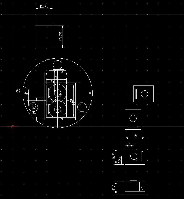

Bit of progress.
I used Qcad to layout a plan of the clock base using the dimensions of the bob and magnets etc. I find it easier to do this sort of work in 2D.
Having established the fit in 2D, I moved to Fusion 360 and designed a box to hold two electromagnets with cheek pieces to hold the IR LED and detector.
The idea is to use one magnet at the side to start the pendulum swinging from rest, and the other underneath to impulse the bob. One end-wall is lowered so the 'start' magnet rests on it and tilts towards the bob. This late change bit back.
Exported the F360 design as STL and printed it via gcode with my Creality Ender 3D printer. Shown below with magnets glued in and the infra-red components plugged into the cheeks.
Below right under the terminal strip is an unmodified Arduino IR Proximity detector module. Normally the clear LED emits a beam that bounces back off obstacles and is detected to stop a robot hitting something. The module contains a comparator chip and sensitivity adjustment pot. Rather than design and build my own circuit, I modified a module simply by extending the LED and detector on wires.
Fans of duffer cock-ups will note the terminal strip swaps the connectioms over. Despite making notes and marking the LEDs to make sure they were reconnected the right way round, I soldered them back onto the module the wrong way. Ho hum.
Here it is connected and assembled for first fitting. Nothing is fixed down yet.
Although it looks reasonable, it's a very tight fit. I failed to allow space for the IR beam wiring. Worse, because the electromagnets are rectangular and asymmetric, the bob was pulled off centre. Rearranging the magnets fore and aft to correct that means the poles can't quite be positioned correctly under the bob. Might work but it's way off design.
I'll probably go back to a single electromagnet to test the pendulum while rethinking the dual coil idea.
