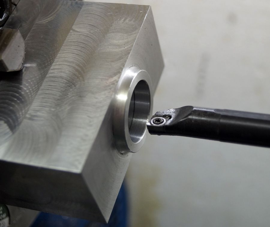

The cylinder block is to size apart from adding a spigot ring, I machined it all on the mill using the 25mm end mill and its turned out nice and square so thats good.
Its now set up in the 4 jaw ready for drilling and boring, I know a recent thread said the proper way is to go from the pilot drill straight to the largest drill size but there is no way my lathe will cope with that so am going with a set of drills and do it in stages. I am going to give a 6.0mm, 13mm, 16mm, 19.5mm and 22mm a try, then bore out to the finished size 24mm.
I must admit I am a bit nervous about it I think the largest hole I have drilled on the mill to date is 13mm so I will see how I get on. One area where I may have a problem is the boring, the largest boring bar I have is 12mm with a GT insert which is probably too small but we will see. From 22mm to 24mm I only have to bore out 1.0mm so hoping a series of light cuts will work, but I dont know.

Well I need not have worried the drilling couldnt have gone better, sailed through it, none of the drills grabbed at all and the lathe had no problem.

I turned up a spigot ring as the alu block was just too short to allow the spigot to be turned from the end face. The spigot is fitted into a recess with 638 retainer and I have left enough meat for it to be turned to size.
Next job is boring the cylinder to 24mm, currently drilled to 22mm.

Up early and turned the spigot to size and bored the cylinder using the 12mm bar (biggest I have) with a GT insert.
With a question mark over the size of bar I took it easy, 1.0mm to remove so went with 2 x 0.3mm passes, 1 x 0.2mm and 2 x 0.1mm all run at 650 rpm except for the last pass at 950 rpm. I may have just been lucky but as best I can measure using a Mitu Digimatic the bore is good to half a thou which over 60mm I am really pleased with.
