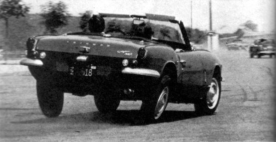

Transverse leaf spring and a tendency for the rear wheels to tuck under. The system was tweaked to make it slightly better on later cars but still somewhat tail happy in the wet going around roundabouts. The rubber doughnut version used a lower wishbone rear rather than letting the axle shafts take the strain.

...... together with a sudden loss of grip at the rear end as the axles swing under the car pivoting at the UJ at the differential. There is no slow transition. It tends to go from grip to no grip very quickly.

Closing the throttle, or braking, when cornering on any swing axle car i( such as the original VW Beetle, Triumph or Skoda 100 Series) will cause the rear wheel to tuck under. This usually precedes a visit to the the local countryside!
As Chris says, the transition from safe to Whoops! is pretty rapid, and not to be encouraged.

Brings back memories of a certain not very popular teacher who had a Triumph Spitfire. Provided he had parked out of sight of the staff room we would lift the back end up and watch the wheels tuck in. Two or three big strong lads could easily lift the back end off the ground.
