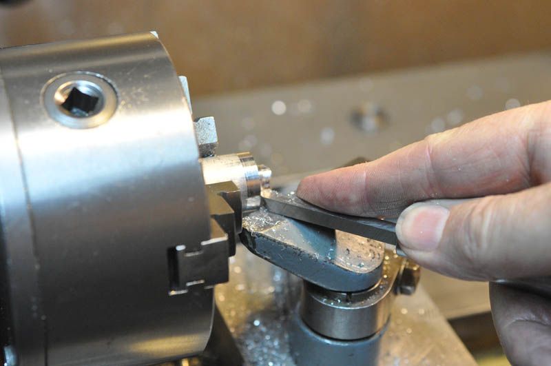

Stems are brass, tops and bottoms ally. I used the gear I put together to mill helical gears for the stems. First I turned a 2.5 degree (5 inclusive) taper using the taper turning attachment.
Then set up a gear train with a lead of about 3 inches.
I reduced the taper to 1.5 degrees and set up the milling spindle to follow the taper and used direct indexing to mill 4 helical facets.
The curves on the ally top and bottom were done with a hand graver.
The top is held on with a screw and the bottom with Araldite.
