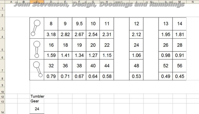

John Stevenson20/03/2017 21:12:51
avatar
5068 forum posts
3 photos
Allan,
Just joking.
In my case the maths were done years ago and TBH I'd probably struggle to sort out what I did nowadays.
Because these questions always came up I wrote a spreadsheet and upon this I superimposed a drawing of the Myford gearbox legend.
This is the standard plate with the 24 driver.
Top row of number per row is the standard imperial tpi from 8 to 56. The lower row of numbers which make no sense are the pitch in mm.

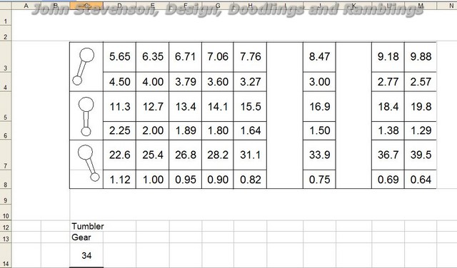

However if we swap the 24 for any other number, things change dramatically.
Here we have changed the 24 to one of the magic number, in this case 34 and the top boxes are now gibberish but the lower boxes have the number we need for metric threads.
So the maths you need are embedded and hidden under that image of the legend plate. This spreadsheet was written about 1998 or so hence my fuzzy memory of just what it does.

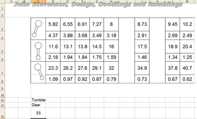

Simon Williams 320/03/2017 22:28:38
728 forum posts
90 photos
Evening all!
Well, bless my soul, that's a mighty pretty summary of where we've got to! Thank you John.
Do you have a spread sheet printout with the tumbler gear set to 33T?
Allan - request for explanation noted, really John's spreadsheet says it all, provided we don't worry too much about what's hiding inside the gearbox. It's only really the relation between the spindle and the carriage travel we're concerned with, and that's what the label on to top of the Q/C gearbox details. What John has done (bodger that he is) is to alter the input gear ratio driving the gearbox, which alters the amount that the carriage moves each revolution of the spindle.
It happens that the alteration chosen magically makes the carriage movement fit most of the useful numbers of the metric series of threads, hence being now able to cut metric threads - or at least a damn fine approximation thereto - with an 8 TPI leadscrew.
It's just a confusion that the imperial threads are traditionally measured in Threads Per Inch, and metric threads are expressed in the pitch between successive crests, measured in millimetres. They are actually the same thing expressed in two ways.
I've gone and confused the otherwise confusing logic of this by finding that the gearbox fitted to my lathe happens to run at half the speed of the one John's calculations were designed for, so all this stuff about 17 tooth gears is me trying to bodge my way round this. I suggest you ignore that for the time being.
The arithmetic is actually fairly simple - or at least I think it is though I'm waiting on Brian to tell me I've misunderstood something. The usual gearbox is fed from a 24 tooth gear. How the motion gets to the leadscrew doesn't matter, but the lever positions tell us the overall result, expressed in TPI. John's spreadsheet replicates this, AND adds the information of the thread pitch in mm. Remember it's the same information, just expressed in a different way.
What we've then done - not my idea, I take no credit for this, is to change the gear driving the gearbox, so that for the same speed of the headstock we have changed the speed of the leadscrew, hence the carriage travels at a different speed, and the TPI numbers (and thus pitches) alter. There's nothing magic about this except for the canny choice of the new driving gear, the gearbox itself hasn't changed and so the output variable - the speed at which the carriage travels along the bed - varies in strict ratio of the new driving gear to the old driving gear.
The original Myford set-up drove the gearbox with a 24T gear. We've decided that's not good enough, and now decided to drive it with a 34 tooth gear. So all the thread pitches (gearbox outputs) increase by 34/24, which is what John's spread sheets show, and the TPI's of course reduce by the same proportion. The clever bit is that someone realised that by choosing 34 as the new number many of the new pitches happen to fall neatly into the numbers you would want to cut metric threads. Eh voila! Metric threads on an imperial lathe.
This cunning plan was developed further by realising than some other useful (metric) pitches fell into place if said input gear was now altered to be 33 teeth.
So now for an apology, because I've come into this late, and presumed to write this up, but it's not my idea and I've got a sneaky feeling that the clever chap who did think of it is somewhere in the mix of this thread. Gent's I apologise unreservedly for my arrogance in taking this upon myself, I only hope I've got it right!
Hope this helps, best rgds to all

John Stevenson20/03/2017 22:50:37
avatar
5068 forum posts
3 photos
33T gear fitted.

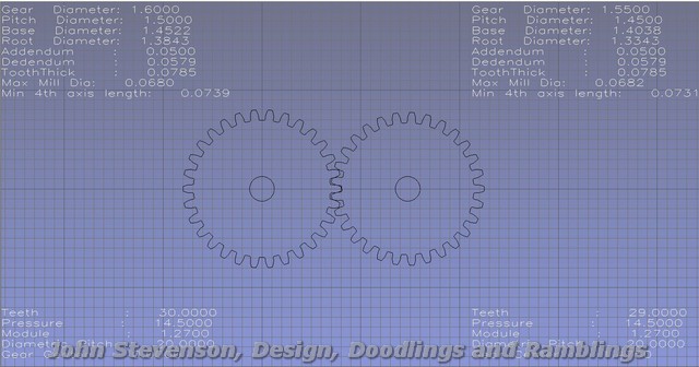

Post to explain how corrected gears can be cut using standard cutters to a reasonable accuracy**
Could be long and may need to be in two parts because of the length of it, so best go get a coffee and throw the cat out.
Bit of background first and some of this may be simple but as I don't know who's reading this I need to explain the whole.
Making corrected gears is something that is done in industry all the while. Strip and measure any modern automobile gearbox and I'll bet none of the gears are standard, all modified for strength, quietness etc.
In production work it's easy to modify corrected gears as any manufacturing method that uses the GENERATING method like hobbing, shaping etc will form the corrected involute automatically.
Unfortunately the home shop method uses FORMING which is limited to the shape of the forming cutter.
As every gear as it increases in tooth number has a different shape then we need a different cutter for each shape, rather a tall order to have say 100 cutters and then you need a hundred in every pitch or DP ] you want to use.
So very early on Brown and Sharpe decided to 'band' these as the differences are very slight.
The bands were numbered 1 to 8 so only eight cutters were needed per set.
Cutter No 8 cuts from 12T to 13T
Cutter No 7 cuts from 14T to 16T
Cutter No 6 cuts from 17T to 20T
Cutter No 5 cuts from 21T to 25T
Cutter No 4 cuts from 26T to 34T
Cutter No 3 cuts from 35T to 54T
Cutter No 2 cuts from 55T to 134T
Cutter No 1 cuts from 135T to a rack.
As you can see the number of teeth in the lower range is limited by the differences in shape whereas as you get bigger the difference isn't so great as regards shape.
A Number 8 12T to 13T is very curved whereas a number 1 from 135 to a rack is virtually straight sided as a rack should be.
A note here to explain that the band of cutters is most accurate at the lowest number of teeth listed.
Now lets take Simon's 29T special gear.
Standard 30 T on the left, 29T on the right, both standard at 20DP and 14.5 pressure angle. There is virtually no difference in shape as these would have been cut with the same FORMED cutter but these shapes are GENERATED.
The important bit is the 30T has an OD of 1.600" and the 29 has an OD of 1.550" but Simon needs it to have an OD the same as the 30T so it meshes correctly.
So we correct the gear by moving the relationship of the Addendum and Dedendum [ top bit of the gear above the pitch line and bottom bit of the gear below the pitch line ] and we get this.
Now both OD's are the same but now look at the shape of the tooth. Because 29 teeth have been spread out where 30 should be they now have fatter stronger teeth but unfortunately you can't use the standard No 4 cutter or you just finish up with the same shape at the 30 T.
End of this post. I need a coffee and I reckon the cat is still outside.
More later.
