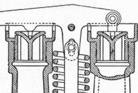

Hi Paul, pictures added.
the poppers are a loose fit in the bores as the drawing to me wasn’t very clear.
id like some made for me but in these dangerous times it’s not easy to find a machinist rightly so of course.

I’ve tried grinding the poppets in, even if I tighten the spring it still leaks so clearly something I’ve done wrong.

To work correctly the ends of the pivot pins on the lever arm should locate slightly below the valve seating, and the valve seating face not too wide,

Hi Micheal
Do you mean the tips of the lever should be deep inside the poppets and not slightly balanced on top?
should I drill down into the poppets so they sit inside.
Thanks for the help

I’m pretty sure the tips were further in as requested, I actually filled the holes with solder to higher the recess up.
so I think if I drill back down they still won’t seal.

Posted by derek blake on 10/04/2020 19:46:08:
Hi Micheal
Thanks for the help
Yes the tips should be drilled into the poppets so that they are slightly below the valve seating (As in the drawing above) if they are just balanced on top the lever can flop about.

Hi Micheal
I’m not sure if you know the Allchin safety valve, but regarding the wings on the poppets should these be a good fit in the bores?
i made mine what I thought was correct but there very sloppy in the bores, no matter how many times I look at the drawing or read the book I can’t understand the fit.
i could do with a cut away drawing that shows how the poppets/cones fit down the bores.
but unfortunately I think the poppets have now gone past use from me messing around with them and as such I’d like to find to machining company to make the safety valve safe!
Regards Derek

Derek,
As Micheal says the point of effort for the spring bar needs to be below the line of contact with the valve and seat. One of the points on the bar as indicated in Micheals drawing also needs to pivot. You will not find a pair of these valves that both lift at exactly the same time so small degree of articulation is required. The set up shown is similar if not identical to a set from a Burrel I repaired for a friend. Adjustment was a nightmare as the adjusting nut was inside the steam cavity. I ended up making a false housing for the valve assembly to bolt on to and set them up on air for the lift pressure. Air does not behave the same as steam but in terms of the actual pressure to get them to lift is close enough, it's the re seating that will not be the same as the air does not have the expansive property of steam. You say the fit of the valves in the body is "loose" what does loose actually mean? A couple of thou clearance, 5 thou or 20 thou? They should not be a tight or even a close sliding fit at normal temperature as you need to allow for some expansion, the last thing you want is for them to bind when they get hot and jam shut! Conversely they don't want to be so slack that you can throw them in from the other side of the room? Loose is a relative term here!
As Micheal also says the width of the seat wants to be fairly narrow I am not sure of the relative size of these parts but I would say 25thou contact would be more than plenty. If the body were machined to a sharp corner and then lapped in with fine time saver the resulting bevel of the seat should be plenty.
I would suggest for a start you make a dummy housing with an air connection, get a bit of weight on the spring (having lowered the point of contact for the bar by removing the solder) and see what happens and at what point they lift -! You need a decent gauge in the system! If it's any consolation this type of valve in miniature are really hard to set up and get working right, that's why lots of people hide a pop type valve inside a dummy representation! Also at the moment if they leak like a sieve they are as safe as you can be because you will never build up any pressure in your boiler under steam!
I am afraid this is a case of patience and perseverance and unlikely to be solved purely by having two new valves made. You will get there.

Hi Paul
many thanks for your help yet again, the valves are under size in the bores but I will try and work out by how much.
its possible I may need to start fresh with a whole new safety valve etc, this is an area I’d rather farm out as safety is my first priority and it’s not something an inexperienced builder like me should risk.
what with how the world is there obviously far more important things going on than an engine but I will try again.
i can blank the area off for now to run on air as I can keep the air regulated on the compressor but I would really like to get the valve sorted eventually as I hate being beaten.

Derek,
That's the spirit! Measuring the valves will be difficult as they have three flutes, easiest way would probably be taking a first guess undersize and drinking a hole in a piece of plate, then slowly keep opening it out. Can't remember if you have a lathe but if you do then bore out in small steps until the valve goes in and then you can measure the hole - will be close enough. Can you post a couple more pictures of the body and the underside showing how the spring is adjusted?

Hi Paul
interestingly I just looked up the bores in the sun and you can see daylight around the valves so there clearly no where near seating correctly 🤔
