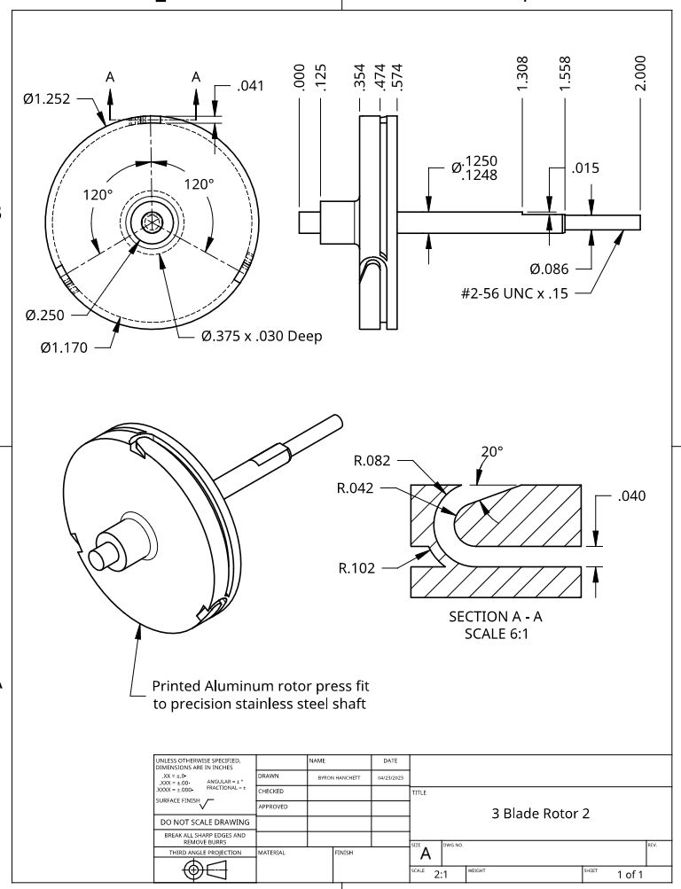

I studied the analysis in ‘Theoretical and experimental analysis of new compressible flow small power turbine prototype’ by Silvio Barbarelli, Gaetano Florio, and Nino Michele Scornaienchi shown in This Link and although I was not able to follow it completely, I thought this type of turbine would work reasonably well with my airbrush compressor and boilers.I looked at different combinations of using a new 3 Blade Rotor with existing turbine housings and designing a new turbine housing specifically for this type of rotor. Although a housing designed specifically for this application showed the most promise, I think that the rotor shown in the following drawing used in the existing Housing 3 SD Gap has quite a bit of potential. I had to make a few compromises to the design of the rotor to fit in this housing and use the existing nozzle. The design of the rotor makes it possible to be printed or cast. The long channel works like in a drag turbine for the middle of the cycle, so the rougher surface helps get extra drag force to partially offset the loss in exit velocity. Since I only need to make the rotor and shaft, I decided to have the rotor printed in aluminum and will make the shaft out of precision machined stainless steel like in all my other turbines. The following drawings show the dimensions I am going to try to obtain for 3 Blade Turbine 2.

Turbine Guy18/05/2023 14:29:19
541 forum posts
578 photos
I assumed the pressures shown in ‘Theoretical and experimental analysis of new compressible flow small power turbine prototype’ by Silvio Barbarelli, Gaetano Florio, and Nino Michele Scornaienchi shown in This Link were gage pressures when I made the velocities spreadsheet shown in the last post. That is why I showed the pressure in the spreadsheet as 44.1 psig. When I do my analysis, all the pressures are converted to absolute which is required when using the gas equations. I assume this was done in the article, but I don’t know if the pressures shown were gage pressures or the gage pressures were converted to absolute pressure and then shown. After calculating the pressure drop in the channel of the 3 Blade Turbine described in the 18/04/2023 post, I found that the pressure drop in the channel was very low. The pressure drop I calculated was very close to the 1.1 Bar given for that example if it was absolute. I decided to revise the 3 Blade Turbine Velocities spreadsheet shown below with the assumption that the pressures given are absolute. I used the case shown in Fig. 19 where U/Co is 0.11, the efficiency is 30%, the inlet pressure is 3 Bar, and Kp is 0.5. The velocities were calculated the same way I did for the tangential and axial turbines. Where the spouting velocity is based on the full enthalpy drop, the nozzle velocity coefficient assumes the pressure downstream of the nozzle is exhaust pressure, and the rotor velocity coefficient includes all leakage and pressure drop losses. I used a nozzle velocity coefficient of 0.95 based on a converging only nozzle expanding to a Mach 1.3 velocity like shown in the chart of the 29/03/2023 post. I found the 0.80 velocity coefficient of the rotor gave the velocity required to pass almost all the mass flow. The resulting hydraulic efficiency of 32.8% would allow for the rotational and leakage losses if they are as low as the report indicates.
