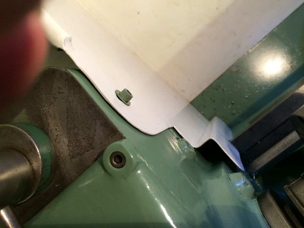

@Richard and @Phil, would you please post photos of what the back splash plate looks like where it bolts to the headstock. Mine is all smashed in at this corner and I do not want to bend it to far back as I have no idea as to what it should look like.
Top view, side views is what I am after please.

Phil Whitley29/05/2020 18:38:31
avatar
1533 forum posts
147 photos
here ya go Herman!

Thanks @Phil, so I see the side plate is all straight with the last bit into a lip. I have a lot of panel beating ahead of me!
