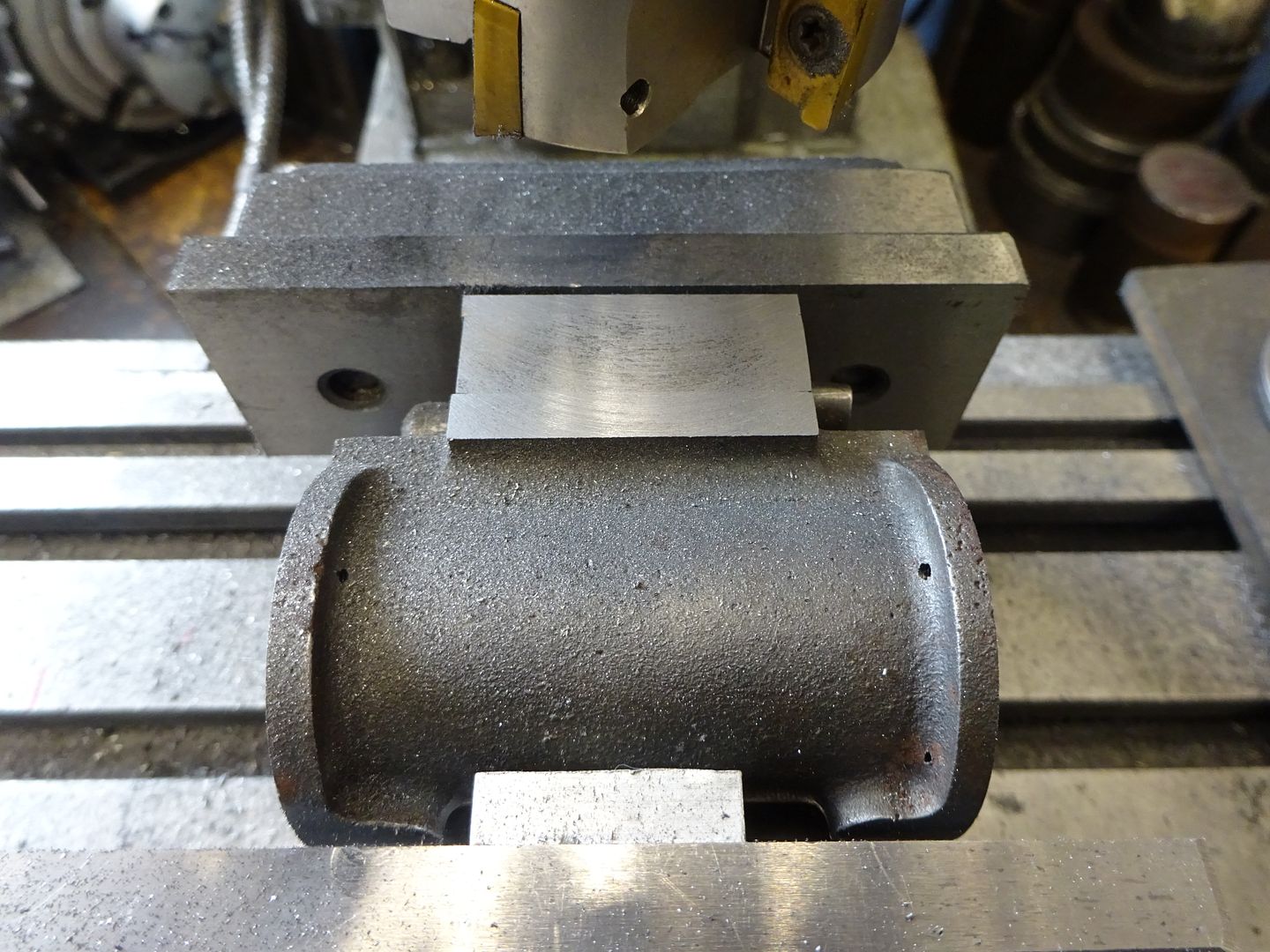

I set up the mandrel as suggested, with snug supports under the overhanging foot plates, but not clamped. I did rebate the rear of the mating boss a bit after all:
So after aligning the angle plate, the mandrel ended up about 0.0005” out of level and about 0.001” out of x-parallel. It’s difficult to know what’s acceptable, but I didn’t think I could realistically get much better, so went ahead and machined the valve face:
After some minor flatting on the surface plate it seems to be pretty much spot-in in terms of height above centreline, and a decent best fit above the flats. One side is a bit off, but the other is parallel, so the casing must be a bit lop sided. The flaw in the valve port machined out too. They might need some minor work with a file:
Next job tomorrow will be the feet recesses and the exhaust port facing. I might also drill the port mounting holes and drill the central hole to the valve face slot. I checked the depth of the exhaust hole from the valve face and that also seems spot-on to the centre pop I made (based on measuring the cast pad), so that’s given some more confidence the offsets are correct.

Always wanted to try using Rizla paper to find the surface of something, 0.0005” according to the verniers, so there we go…
Then machined the feet using the valve face as a reference:
Set up at 90 degrees to the valve face using a 1-2-3 block
Then faced the exhaust pad with a 12mm end mill. It only just cleaned up at the specified offset from the axis
Then puzzled over whether to centre using the valve pad as the reference, or the cylinder ends. There was a very slight difference. Same with the offset from the valve face. Only a matter of 0.004” or so in both cases, but in the end I used the valve pad and the exhaust pad as references:
Double-check with the port seemed to confirm it was about right:
And since I’m using the DROs, I ignored the instructions to mark from the port block, and drilled and tapped the securing holes:
The exhaust hole broke through right where it should:
Now to do it all over again with the other cylinder.
