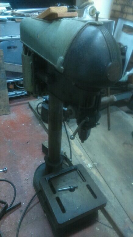

jackson king30/08/2014 12:49:58
6 forum posts
I have stripped it down and had a look, the internal splines mentioned are in very good condition, and everything is tight, and unworn. The front belt guard is cast iron, the body casting is Alluminium.

Rich250230/08/2014 15:22:48
83 forum posts
3 photos
Correct the above to its all cast iron. And it has a government contract plate on it that says 1940.

Hi there, Richard,
I'm glad you found it useful. I'm especially glad for you that the splines are in good condition - best to keep them well lubricated.
I suggest that you take particular note of what the assembly instructions say about not over-tightening the clamp bolt - I have two 'head-stocks' (for want of a better term) for mine and one of them has weld where the results of such over-tightening had caused a crack.
You'll find when you slacken that bolt that local gravity increases and the head-stock develops a strong desire to descend the whole way down the column! That's why I fitted mine with the plastic clamp-rings - the upper one defines the head-stock vertical position.

Rich250230/08/2014 21:33:56
83 forum posts
3 photos
Is there a screw on chuck on these ?
Mine has a Jacobs on it, how do I get it off without damage ? And what spanners fit the bolts on this, I'm guessing its all unified threads ?

Peter Tucker09/09/2014 20:03:09
185 forum posts
Hi Richard,
Jacobs chucks are usually fited on Jacobs tapers. They are removed with split wedges.
Hope this helps.

Rich250211/09/2014 23:41:41
83 forum posts
3 photos
The chuck is just on a short taper maybe an inch or less long. It just comes off with a tap with a copper hammer.

Mark Learmonth28/03/2015 21:55:57
2 forum posts
2 photos
Hi there , I have just picked up one of these , I noticed the comments about the gaurd .... Mine has a factory belt gaurd but .... I cannot see for the life of me how it was originally fitted . There is no brackets or evidence of brackets on the drill or gaurd !
Any ideas , or has anyone seen one with a gaurd ? All the pictures I find have the gaurd missing .
