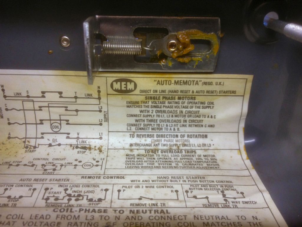

Harry Wilkes07/02/2014 14:41:14
avatar
1613 forum posts
72 photos
When in the workshop today I took the opportunity to remove the cover from my MEM starter and inside of the lid was what I was hoping to find instructions relating to the use of the starter on a 240v supply/load ! There as been a lot written on how the starter should be wired when on 240V so here's what MEM say should be done, sorry about the pic's quality.
Cheers H
geoff07/02/2014 16:17:54
29 forum posts
Presumably it has a 240v coil and not a 415v type
Harry Wilkes07/02/2014 17:11:11
avatar
1613 forum posts
72 photos
Yes Geoff
H

John Bromley09/02/2014 21:24:03
84 forum posts
Well... it's done!
No machine tools were harmed in the wiring of my switch box.
The overload has been adjusted to 2 amps and the 0 volt cut out works.
The wiring confused me due to the fact that someone had connected the coil for remote switching. My brother in law worked through it with me last night and today I connected it up. I now have a safer workshop.
Thankyou guys for your input..
