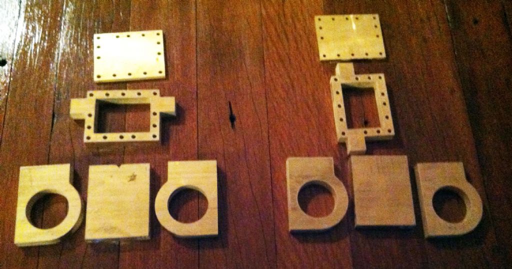

HobbyNut08/03/2013 15:41:10
avatar
113 forum posts
93 photos
Here are the pieces all ready to D&T etc. I am lazy, so I WJ cut the holes in the valve block and cover.

Another question to those in the know.
The valve shaft is detailed with a .010" flat x 5/8" long on 1 end, with a thread on the opposite end.
Why is there a flat on that end? Should the flat be where the "nut" is fitted? There appears to be a few missing dims. on the "nut" also.
JasonB26/03/2013 16:08:27
avatar
25215 forum posts
3105 photos
1 articles
As the end of the shaft is supported in a blind hole there is a risk of condensate building up in the hole and hydralic locking the valve, the flat lets anything out.
Yes there are a few bits missing from the valve nut, shame really as the half page of drawings has been printed twice you would have thought one of the drawings may have the infowink 2 Maybe third time lucky when the text catches up with the drawings
I would assume its made from 3/8" square stock, the large hole is for the 5/32" rod and the threaded hole 5 or 6BA for a grub screw
J
Edited By JasonB on 26/03/2013 16:15:17
Edited By JasonB on 26/03/2013 16:17:24
JasonB26/03/2013 16:23:40
avatar
25215 forum posts
3105 photos
1 articles
Actually I've just read the text and that gives all the info I just said above so we were third time lucky.
Big question is why two different slide valves?
Acrosticus26/03/2013 17:18:41
24 forum posts
2 photos
Posted by JasonB on 26/03/2013 16:23:40:
Presumably because the cylinder and valve chest of the fabricated cylinder and the Railmotor castings, though both the same bore, are different external sizes, and have different valve rod positions.
JasonB26/03/2013 17:34:57
avatar
25215 forum posts
3105 photos
1 articles
Ah yes now I've had a better look it seems one set of drawings is for all the valve parts & cylinder covers for the fabricated cylinders and the other for cast, although several parts are the same on both drawings there are some subtle differences, would have been handy to have a title saying which is which.
Thats what you get for not reading the article from the start.
