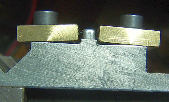

This afternoon I vaguely recalled a web page by some US chap with a Chinese 7x14 lathe (or similar) where he explained a modification he devised to allow him to adjust the carriage strips from above and on the fly. ie: no dismantling anything.
Cannot find the page now but the idea was similar in concept to what the people at Sieg did with the C0 strips so I set to see if I could do something like that with the U3 strips.
Here it is:
Each strip has acquired two 12mm M4x0.70 set screws, but unlike the Sieg C0 strips, the screws are not aligned with the screws holding the strips in place but offset so as to do this when adjusted:
The screws holding the strips are not tightened and the set screws cause the strips rock towards the ways.
It goes without saying that the amount of tilt shown in the photograph has been greatly exaggerated in order to show what happens when the strips are being adjusted. The strips do not load on the ways, they hover just above them on a film of oil so I expect that they will last a long time.
I finished the job a while ago and can say that it works really well: the slide (tested without lead screw fitted) goes from end to end very smoothly, with no jamming whatsoever and no discernible upwards movement at any point in its travel.
Of course, it has to be tested and used for a good while to see the actual results but (for now) it is looking good.

Interesting approach. No doubt your approach will work fine. Whether it will continue to do so as it wears remains to be seen. Realistically, it isn't going to wear much is it?
However, a few things to consider:
1. Tilting the strips will tend to cause line contact, which will be associated with greater wear. Don't forget that a softer material can wear a harder one if it gets embedded with abrasive - as in a lap. These strips need to be 'sacrificial'.
2. You could use Belville washers (or other spring washers) under the retaining screw heads to achieve preload. (IIRC, Emco use wavy spring washers).
3. The strips will certainly not float on a film of oil (hydrodynamic bearing), unless you make the gap large enough (and the saddle whizzes along) - and we don't want a gap, for obvious reasons. At the low speed a saddle will travel, and the loading necessary to pull the saddle down, even boundary lubrication is optimistic. There will be metal-to-metal contact.
4. Don't lose sleep over it. "She'll be right", as they say here in NZ.

1. ... will tend to cause line contact ... | ... associated with greater wear.
I would be surprised if the wear over (say, 12 months) were to be significant enough to matter. ie: to create a situation where the carriage will act up and affect when turning a piece. The original strips showed wear along a ~3 mm band so checking the state of the brass strips in a couple of months should give us a rough idea / approximation.
As mentioned, the photograph showing how this arrangement works is an extreme to illustrate the idea.
In reality, when the strips are held in place by the mounting screws they are practically touching the ways before the set screws are turned. As mentioned, the set screws are M4x0.7 and I achieved what I considered to be right adjustment ie: smooth movement of the carriage without discernible lifting or jamming of the strips, with just a touch of the screw.
Just a touch (whatever quantity that effectively is) in this case means a very slight turn of the set screw. Given the pitch, this translates into a very small advance and as a result, a very slight lift of the trailing edge of the strip. ie: practically no pressure between the way and the strip and I assume (here's the scale factor again) a very small angle between both.
I expect that as time goes by, the leading edge of the strip will indeed suffer some wear but as this happens, the contact surface will be progressively increased.
Will have to check and see just how much further on.

After a fortnight or so I had to dismantle the carrier again to take some measurements and had a look at the new brass gibs. I then realised that they needed a tad more removal from the surface they are bolted on to, so went about doing that.
It was not a case of line wearing as the width of the markings on the brass were quite consistent with the markings I had measured on the OEM lift strips but as the use of the set screws was needed, I decided to go ahead and see what I could do.
It was a very small amount and the result was quite satisfactory, to the extent on not needing any adjustment from the Sieg C0 type set screws I had added.
But then I found out that the whole arrangement had become more difficult tighten, I guess due to the smaller dimensions at play and the 0.7 pitch of the mounting screws.
The solution (again) was to follow Kiwi Bloke's advise and use Bellville washers, so I added a pair arranged in series (on top of the OEM washer) to each screw.
The carrier now moves very smoothly and, as expected, gets tighter as it reaches each end of the bed.
I expect that, as the gibs wear the carrier will loosen up and then it will become necessary to use the set screws to adjust the gibs accordingly but I think it will take many hour's use of the U3 for that to happen.
Here's a photo of the gib below the flat as seen from the tailstock end, with the Bellville washers clearly visible:
It looks like it is as Kiwi Bloke said: She'll be right.

Posted by Julius Henry Marx on 23/07/2023 16:34:28:
The reason why the Carriage gets tighter as it moves towards the end of the Bed is due to the geometry of the machine.
The Leadscrew centre-line is fixed in relationship to the Profile of the Slideways on the actual Bed.
Excessive wear on the Carriage Slideway Profile, now means the Leadscrew tapped hole will be sitting lower than was originally intended. This is not so bad when the Carriage is nearer the Headstock as there is some play in the system. As the Carriage nears the fixed Leadscrew bearing this will cause binding due to the misalignment of the two items. Any attempt to reduce backlash in the system will only exacerbate the binding.
This was, apart from wear in the original thread, one of the reasons I did the above salvage scheme on my Unimat restoration. As wear in the current Carriage set-up takes place a new Phos Bronze Leadscrew Nut can be made with a slightly offset tapped hole to cater for this misalignment.
The fitting of the new Nut brought the backlash back to 0.05 mm which is what I would expect. Although this is the original leadscrew of unknown age, there is no change in the above figure through-out the length of travel.
Regards
Gray,
Julius Henry Marx26/07/2023 23:05:23
113 forum posts
52 photos
Hello:
Sory for the delay in my reply.
Posted by Graham Meek on 24/07/2023 10:58:24:
... gets tighter as it moves towards the end of the Bed is due to the geometry of the machine. | ... centre-line is fixed in relationship to the Profile of the Slideways ...
I see.
... wear on the Carriage ... | ... means the Leadscrew tapped hole will be sitting lower ... | ... not so bad when the Carriage is nearer the Headstock as there is some play ...
Yes, I have noticed that there is some play at the left end of the leadscrew.
... nears the fixed Leadscrew bearing ... | ... binding due to the misalignment ...
Makes sense. But when I was testing/adjusting the new gibs with the Bellville washers without the leadscrew in place, I observed that the was some tightness at each end of the run.
... one of the reasons I did the above salvage scheme on my Unimat ... | ... wear in the current Carriage set-up takes place a new Phos Bronze Leadscrew Nut can be made with a slightly offset tapped hole to cater for this misalignment.
Yes. The Sieg C0 has a leadcrew nut that is adjustable in height, apparently to deal with that problem.
... new Nut brought the backlash back to 0.05 mm which is what I would expect.
Good job that one. I'm still attempting to figure out how to get that done on mine.
Thanks for your input.
Best,
JHM
