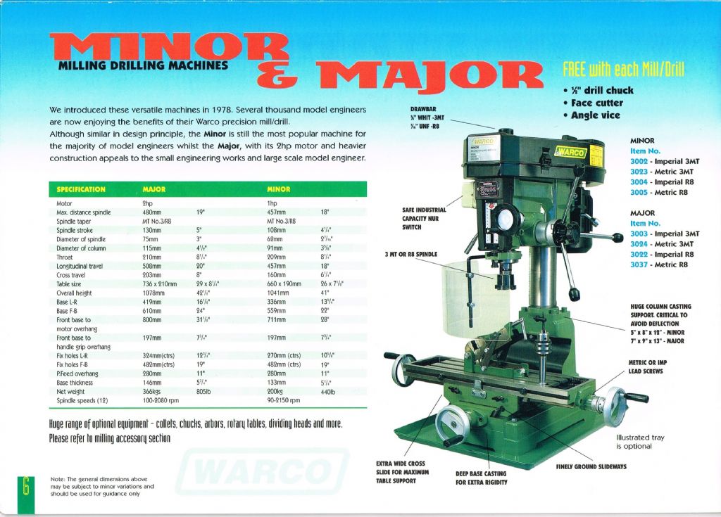

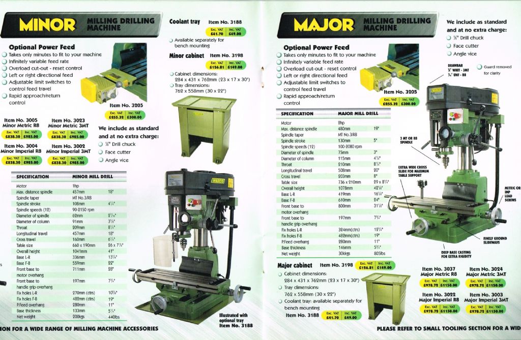

Nicholas Farr28/03/2023 14:29:36
avatar
3988 forum posts
1799 photos
Hi Paul, it is certainly a bit of a mystery, but I have found two other illustrations of the two different machines, the first one is from about 1985, and in this one it has Minor on the belt and pulley cover. The second one is from 2002, and both illustrations seem to show the same machine and both have Major on the cover.
The only other dimensions you could check are the diameters of the spindle and the column and overall height, the spindle speed ranges are also a little different.
Your central locking of the head arrangement could be similar to the type shown below.
The yellow colouring on the handle bosses, seems to be started in their 2007 catalogue, and in which the Minor machine didn't appear, and I guess was discontinued by then.
Regards Nick.
