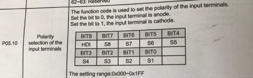

I assumed it was binary and that a fudge factor had been included in the table, but I just took an educated guess at the value. It reminds me when I was trying to program my inverter and struggled to work it out but got it in the end.
Basically you have to create a 9 bit binary number and convert it to hexadecimal and enter that into the VFD. in my case I wanted to change the polarity of terminal S4 which is bit number 3 so:-
Bit number 8 7 6 5 4 3 2 1 0
Bit setting. 0 0 0 0 0 1 0 0 0
Convert 0 0 0 0 0 1 0 0 0 to hexadecimal (that’s easy use a converter from the interweb) = 8
Entered 8 on the VFD, result it works.
Suppose you wanted to change the polarity of all terminals, the binary number would look like this:- 1 1 1 1 1 1 1 1 1 The hexadecimal is 1FF which is what to enter in the VFD, also hexadecimals are usually prefixed with 0x so it should be written as 0x1FF.
