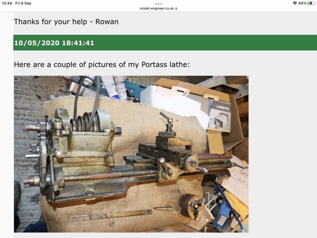

I repeat - the OP says that the tailstock "has a lot of slack in it" when the lock is released. Twist in a lathe bed isn't going to give enough offset at the tailstock to keep snapping centre drills - but a tailstock that loses alignment when unlocked might! Suggests that there is something that needs looking at - how is the tailstock guided? Has anyone else met a lathe with any pretensions to accuracy where the tailstock does not stay aligned even when unlocked?
Can you tell us what the lathe is, and how the tailstock is located on the bed?

Michael Gilligan09/09/2022 07:31:07
avatar
23121 forum posts
1360 photos
Posted by Rowan Sylvester-Bradley on 07/09/2022 18:57:20:
… The tailstock on my lathe has a lot of slack in it when the nut is loosened
May we have a photograph, please ?
… just to make sure we are all ‘on the same page’
Before you ask: https://www.model-engineer.co.uk/forums/postings.asp?th=103028&p=1

Hopper09/09/2022 10:53:34
avatar
7881 forum posts
397 photos
Assuming that the lathe is the Portass PD5 you mentioned in another thread, when you tighten the tailstock clamping handle, it should pull the tailstock up against the angled dovetail side of the flat bed ways, so it will always clamp in the same position, so no need to worry about that.
But there is adjustment side to side to align the body of the tailstock with the headstock spindle if the centre drill is not drilling right on centre. The body of the tailstock and the base are two separate pieces, with an adjusting dovetail or step slide running sideways for this purpose.
Other than that, use the largest centre drill you can, at the highest RPM you can.
Use a good quality name brand centre drill. Not cheap no-name junk.
Use a pecking motion to keep clearing the chips and to keep the tip cool.
Flood it with whatever oil you have in the nearest oil can, to keep the tip cool and lubricated.
Don't try to drill the chamfered part of the hole to full depth on the centre drill. Only a third to halfway is needed to make enough of an angled face for the tailstock centre to engage with in use.
And as said already, forget centre drills for starting drilled holes. Use a spotting drill instead. Or a very large centre drill and just use the very point to put a small divot in the job to start your first drill proper. Reserve centre drills for when you actually need to use a tailstock centre in the hole afterwards.

Michael Gilligan09/09/2022 12:43:29
avatar
23121 forum posts
1360 photos
Posted by Hopper on 09/09/2022 10:53:34:
Assuming that the lathe is the Portass PD5 you mentioned in another thread …
Strangely … When I looked back at previous threads, there was a photo : but I cannot find an Album
If it’s the Portass lathe, the underlying problem could be headstock alignment
… I would check that before exploring other avenues.
In case it’s not obvious:
Quote from lathes.co.uk
”Offered in two forms, one as the simplest kind cast as one piece, the other with a separate bas that allowed it to be set-over for the turning of slight tapers.”
Edited By Michael Gilligan on 09/09/2022 12:52:28
