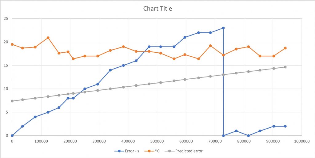

Latest timekeeping results.
This shows readings over the past 10 days since setting the two correction counters to 132 and 92. One odd thing I've seen is that every time I upload new software with changed counters, even though the clock doesn't actually stop swinging it takes quite a long time (days) to settle down. In the plot above the blue error curve was steadily increasing but the rate of increase seeming to flatten off, so 3 days ago I reset the seconds hand (just using the control switch which inhibits dial impulsing, removing 24 seconds of accumulated error. Since then the error has built up to 2 sec, but this includes some due to my accidentally jogging my desk (the clock sits on the desk in my study). The clock has a "half-second" pendulum so the SW divides by two to drive the dial, and normally you see the dial advance on the same half-swing each time, in this case it was L->R. But then I stood up yesterday and accidentally jogged the desk since when it has been incrementing on R->L, so I think there's been at least a half-second extra input to the displayed time and possibly more as the pendulum settled down. I also display the temperature at the time of the reading, I'm not convinced that there is any obvious correlation but haven't yet done a regression analysis. Ignore the grey line. Anyway, I think the regulation is getting there, and I already rely on the clock when I just want to quickly know the time.

Posted by John Haine on 08/01/2021 10:19:36:
... One odd thing I've seen is that every time I upload new software with changed counters, even though the clock doesn't actually stop swinging it takes quite a long time (days) to settle down.
... this includes some due to my accidentally jogging my desk (the clock sits on the desk in my study). ...
I've got both problems too. My pendulum is very sensitive to jogging, and, after a restart, it misbehaves for at least 4 hours. Some evidence in the longer runs that it becomes more stable after a couple of days but I've not had mine running long enough yet to prove the pendulum settles. Or gets worse! MichaelG suggests my carbon-fibre rod will develop fatigue cracks at the suspension point, and I think he's right.
