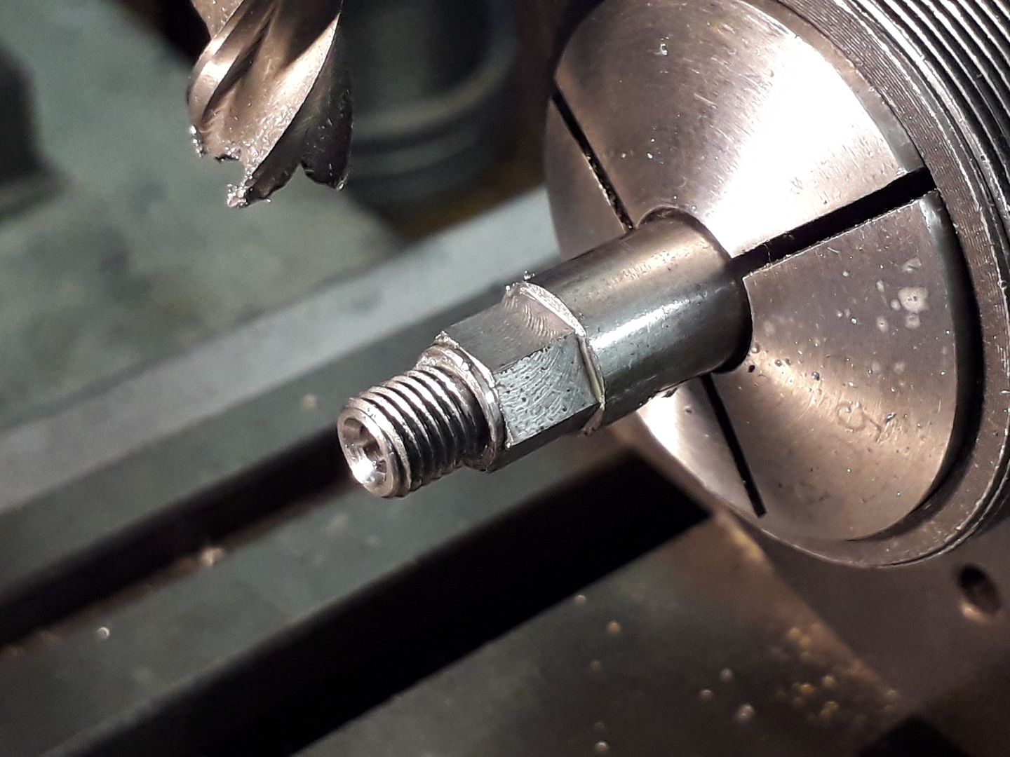

The drawings include details for a home made spark plug to suit the engine so I had a go at making one, well two actually as the extra can be used in the Type D when I get round to making that.
The body started out being turned on the end of some EN1A bar and then screwcut 1/4 x 32 UNEF as I only have a tap that size. The large picture makes it look rougher than it is.
Next over to the spin indexer to mill the 5/16 hex
A suitable female thread was tapped into the end of a bit of scrap so the body could be held to finish the top end.
The insulator is a length of 3mm glass tube which cut very easily with a diamond coated disc in the Dremel, I used the slowest speed to avoid heating the glass and then just twisted the glass in my fingers against the disc to chamfer off the sharp edges
The central electrode is a piece of 0.5mm tig welding electrode and the final part is a small brass cap with a groove to accept the wire clip. The electrode is trimmed to length after assembly.
The plugs are assembled using Loctite 380 "Black Max" adhesive. I could not get the plugs to work at first and it turned out that the adhesive had insulated the electrode from the brass cap, a quick spot of electrical solder on the end soon cured that problem and the engine ran better than with the standard length Rimfire plug that I had been using for initial testing.
Unlike a conventional plug the spark does not travel from the central electrode to the plug body but to a long screw that enters from the opposite side of the cylinder, plug gap is adjusted by turning this screw and securing with a locknut. At one time Nick did offer a disc of glass that coul dbe fitted to a modified cylinder head so you can tip the engine up when running to watch the spark and ignited fuel.

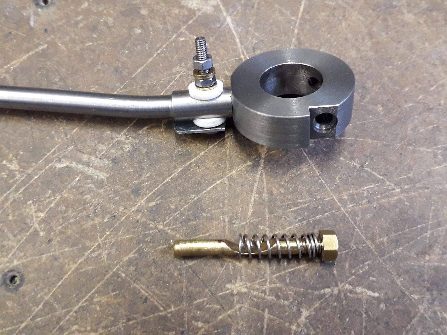

I did not take many photos of the adjustable timing bracket. Below is the lever having had a 2BA thread put on the end it was slid out of the chuck to reduce most of it's length to 3/16" leaving a 1/4" collar for the contact.
After cutting off it was held the other way round and a decorative ball turned on the end. The collar is straight forward turning and milling and the brass cotter applies the friction to hold it in position but still allow easy movement to advance and retard the timing. I opted to use Corian as the insulators rather than the suggested materials.
