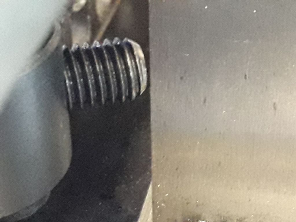

I have only had my mill a couple of months. I noticed a mark on the table when I moved my vice a few weeks ago.
I just had another look after reading this thread, and I can see a number of marks.
I suppose I should be pleased that now I am aware of the issue.
IRT24/11/2019 22:16:20
151 forum posts
44 photos
Not happy though. I was not aware when I was doing it that anything was wrong. I will have a better look tomorrow, but if it is this easy to use wrong it will probably happen again.20191124_220556.jpg

Ian, 18 months ago the same dings happened to my shiny new mill table, most annoying, I shortened the bolt by about 6mm

JasonB25/11/2019 13:23:36
avatar
25215 forum posts
3105 photos
1 articles
Wow, some serious overthinking going on and certainly no need to stop using the vice, I read this post on the phone as I got in and and while the kettle was boiling cured it.
As Per my earlier post the screw on the one I have does project maybe 0.75mm when the jaw is pulled down tight to the body, looking at the screw it's easy to see that where the thread was rolled it has made the screw a bit longer and that the first turn or so is not doing anything useful
So shove it in the chuck and turn off the end, add a small chamfer. You can see I even left the very middle of the concave end so very little taken off.
Now with the screw bottomed out there is clearance between it and the bottom of the vice.
While it is unfortunate that the screw can extend beyond the base as I have said earlier if you are using it in this position then the grip of the vice will be seriously compromised. So learn to use it correctly and shorten the screw to be safe.

IRT25/11/2019 20:25:17
151 forum posts
44 photos
Bolt shortened and vice bolted on and re-aligned.
I will keep a close eye to make sure no more damaged is done.
Thanks Phil for highlighting the issue before I done any more damage.
