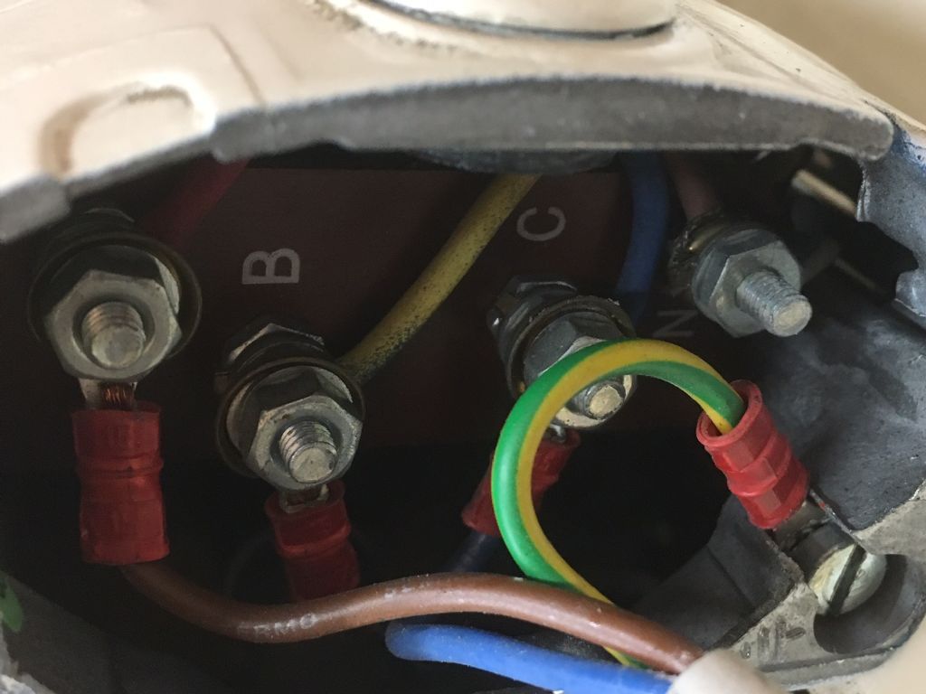

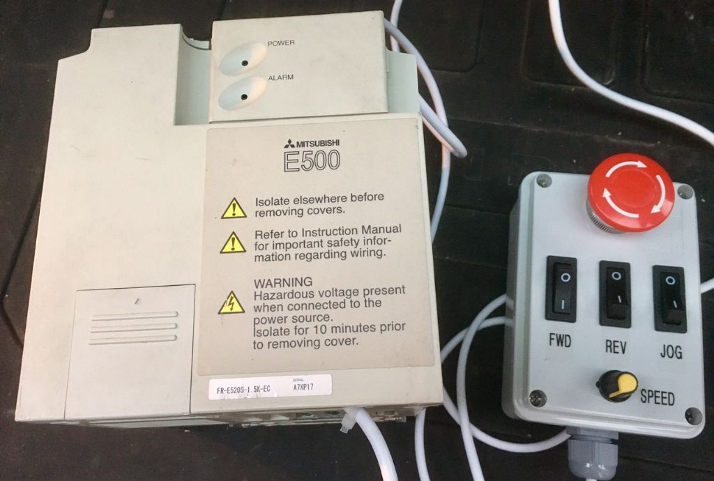

You may be able also to advise on the Mesh/Delta wiring im about to look at.. I have just got an Inverter and Pendent and need to put wire the motor to work single phase
Any idea about the wiring sequence

Boxford fitted three or four different motors. I presume you checked the motor plate first, as you may well have a dual voltage 240/415v motor.

Yes its the dual voltage one

There are several ways that are popular to control the inverter.
1) By the butons on the unit it's self. - This is far from ideal as the unit will get covered in grubby oil and crud from your fingers.
2) Most suppliers will provide an option of a remote pendant type control. - This is the easiest option and a good one that is taken by many people. You could of course make your own as one pays a premium for the supplied ones.
3) I stripped out the existing control circuit wiring and reconfigured it so that it latched relays / contactors interlinked with the forward and reverse controls. The advantage of doing this is that one uses the existing original switches, buttons and kick bars that the lathe was supplied with. No advantage electrically but IMHO it looks far neater.

I have already got a Mitsubushi E520s pre configured with the Pendent from Gavin on Ebay so just need to make the motor Mesh as opposed to Star and connect the SY cable from the inverter to the motor...
i was looking for advice on how to make the motor Mesh using the A,B,C,N terminals

Presumably the 'N' terminal has 3 wires connected to it. Yes / No.? (bit misleading as N normally denotes neutral. but in this case they have probably used a universal connection plate)
If so you need to disconnect and separate those three wires on the N terminal. You will then ideally need a Megger / insulation tester. If you have not got one a continuity tester of some form will do. - Just to be on the safe side of caution don't use a high voltage insulation tester with the inverter connected. Probably be OK but some electronics don't like voltage shoved the wrong way up their chuffer.!
What you need then to do with the tester is identify the other end of the windings for A, B & C ( given depending on maker any designation but usually U, V, W, or X, Y, Z. with a 1 or 2 after the letter. Does't matter really it's just a way of ID-ing them.)
Once you have the winding pairs connect as follows. :-
What you have ATM is the star connection with the N being the common bond of W2, U2, V2

thanks for the explanation and yes its has 3 wires connected but might need my sparky friend to check all that its beyond my remit...
