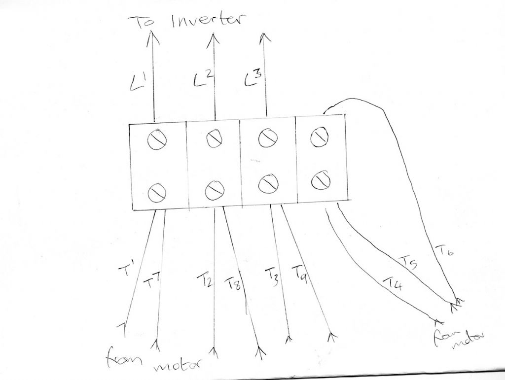

mark smith 2003/08/2016 15:40:37

Posted by Martin Connelly on 26/07/2016 13:33:13:
I'd use a rigid type terminal strip rather than the soft nylon type, they are more like the material usually found as terminal blocks in motors and may be more resilient with regard to fretting due to vibration.
**LINK**
Martin
Hi Martin, so which of those on that link do i need, you mention 2 wires on one side and one on the other????
Heres my idiot understanding of the wiring is that right or completely wrong.
Edited By mark smith 20 on 03/08/2016 15:41:54
Edited By mark smith 20 on 03/08/2016 15:42:46

mark smith 2003/08/2016 20:04:32
682 forum posts
337 photos
Really need advice on this,am i on the right track? Can a 3 section block be used and the T4 T5 T6 wire be simply twisted together seperately from the block and one of those twist cap wire connectors used??
Thanks
Andy Holdaway03/08/2016 20:39:37
avatar
167 forum posts
15 photos
Mark, your sketch is correct for a 230v 3 phase setup to run from a single to three phase inverter. If the motor runs the wrong way, swap any two of the wires from the inverter to the motor.

Emgee03/08/2016 21:52:59
2610 forum posts
312 photos
Mark, the isolator you linked to should be OK but don't forget to connect both ends of the cable metal braid for continuity of protection, either use earthing rings with connecting conductor or take the tails into the enclosure and connect at the earthing terminal with the cpc's (g/y earth cables)

Andy Ash03/08/2016 22:29:52
159 forum posts
36 photos
From what you show it seems correct, but my meter probes won't reach your motor from here. Unfortunately I can't say you won't burn your house down!

mark smith 2004/08/2016 12:19:48
682 forum posts
337 photos
Andy thanks for the confirmation,ill blame you if i blow myself up!!!smiley
Emgee ,thanks for the info,ill try and follow the advice correctly.
One question is the screw in the middle of the terminal box (middle of black area going into motor housing) on the motor the one to secure down a terminal block??
I assume the one to the side is the earth?
