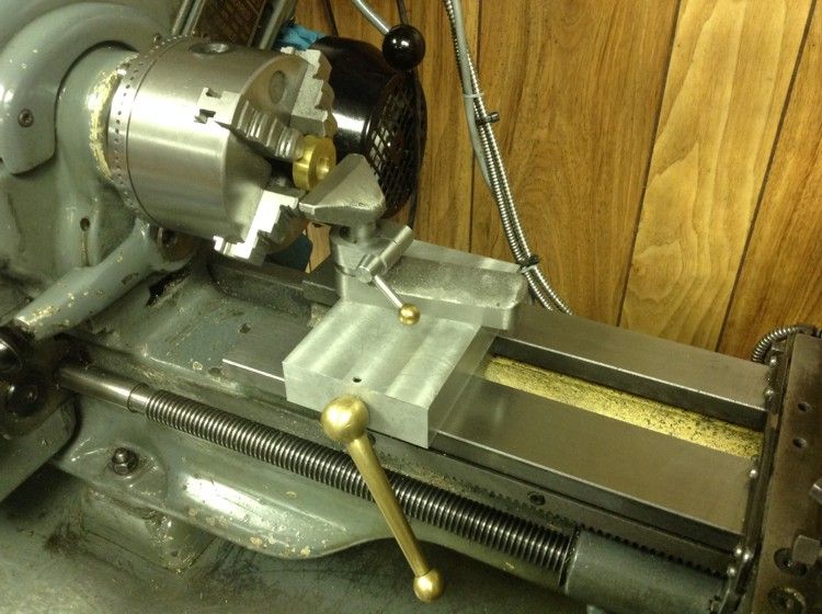

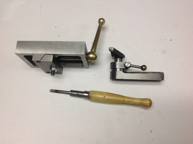

Don't know if your lathe has the old style south bend/boxford compound,
If it does adapting a woodturning toolrest works a treat

Boxford made two wood turning tool rests(short one and long one) to fit the old bench lathes (AUD, BUD etc) but ther are designed to fit the old-style rest-holding arrangements which use a tapered plug. It is easy to make a simple adapter to allow those rests to fit onto a plain surface or a tee slot etc. I suggest second-hand dealers (see G & M Tools, for example). It is also relatively easy to adapt other rests, and I often use a rest from a Record wood lathe to give me an extended rest which sits out a distance from the normal rest position, for larger jobs.
