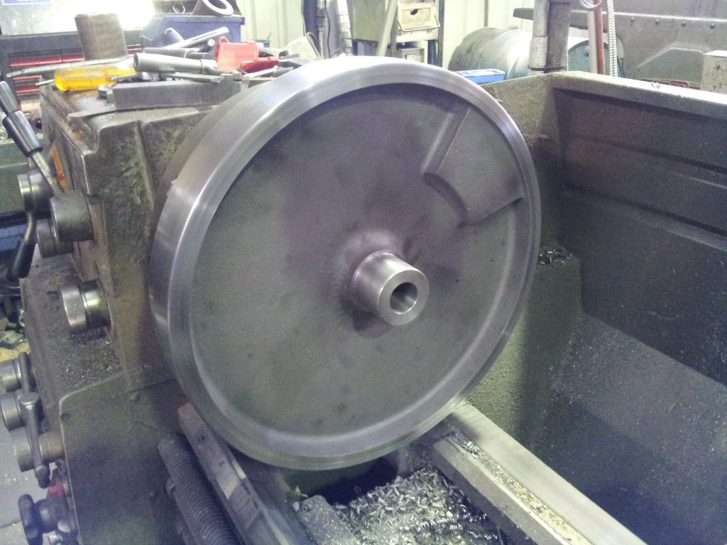

FLYWHEEL
The flywheel is 15" diameter x 2" wide and was supplied as a casting. Again, I had to use a mates lathe as it was too big for my little Southbend.
I used the inside lip on the flywheel to hold it in a 4-jaw chuck. The lip was small and slightly tapered, so cut a center hole and used the tail stock while turning the outside and the side of the boss in case it came loose. Then drilled a hole thru the casting and bored the hole to the correct size.
The crown on the outside edge was formed by cutting a slight taper on each edge, then blending it into a radius. The flywheel then rotated and held by the boss to machine the other side.

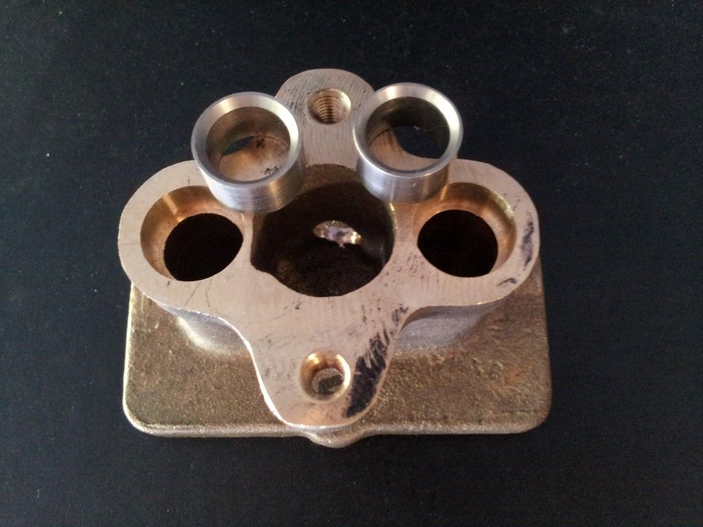

PRESSURE RELIEF VALVE
I ordered a gunmetal casting for the pressure relief valve body and a tension spring. The remaining parts were made from materials which I purchased (or scrounged) locally.
Base of the valve body being milled flat
Casting top machined and port holes being marked out.
Holes for the two valve ports being drilled.
Recessed holes for valve inserts bored to size
The valve cover was made from a piece of brass bar and cut to a rough shape. The saw, held in a collet chuck sliced thru the brass like butter.
Turning the valve cover.
The drawings for the pressure relief valve had brass insert with a flat surface on top to seal against the mating part. I made my inserts from stainless steel with a tapered seat.
Using a vice to press the insert into place.
Cover bolted in place for milling a slot for the valve retention lever
Valve insert being turned from brass bar stock.
Three vertical slots being milled in the side of the wing valve on a rotary table.
Machining the sealing face of the wing valve.
Pin for valve spring being machines.
A cut-out in the side is provided for access to a nut inside which is used to adjust the spring tension.
Machining of the valve lever which keeps the valve inserts in position.
Finished valve parts prior to assembly
Pressure relief valve fully assembled.
Note the holes in the side of the retaining nut inside which are used to set the release pressure by adjusting the load on the spring. The nut is retained by a lock wire to stop it coming loose after the pressure is set.

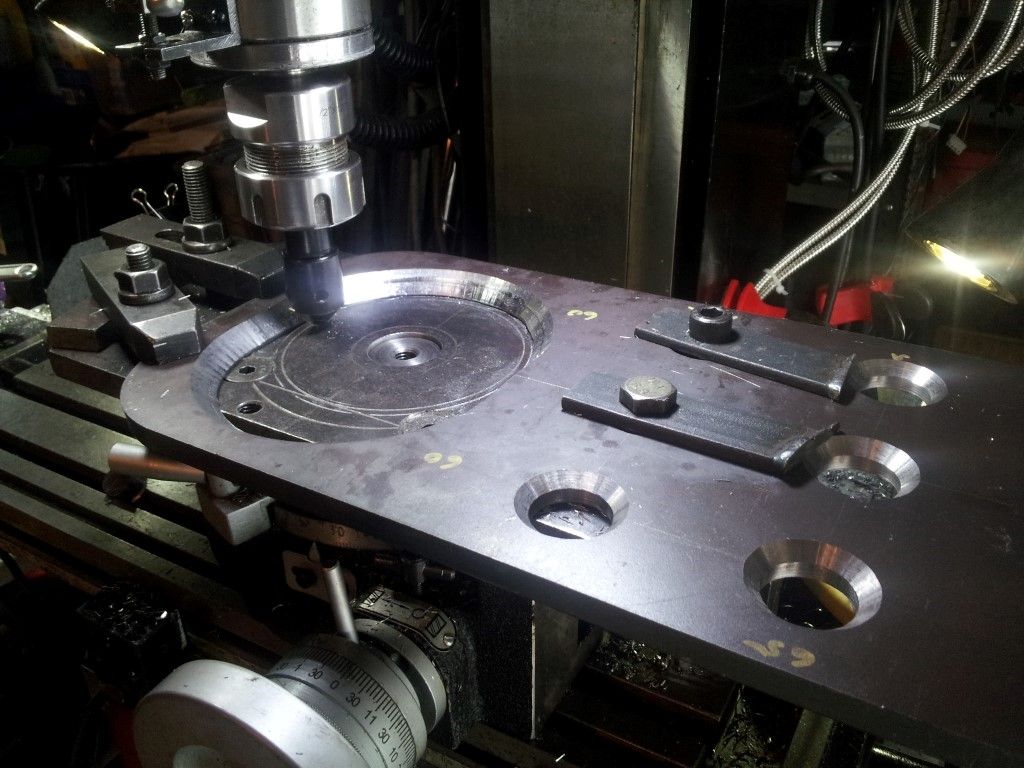

MACHINING THE FIRST FACE OF THE CASTING
Machining of the front surface of the steam chest casting using a 32mm cutter with replaceable carbide inserts. As this was a raw casting, there were no accurate faces to use as a datum for the milling setup and many double checks were made before settling on this position.
MACHINING THE LEFT HAND SIDE OF THE CASTING
The casting was turned on its side to machine the mounting face for the reverse valve cover and slide valve seat. Holes drilled and tapped for threaded studs which will hold a cover plate.
After cleaning up the casting with an angle grinder and a small hand held belt linisher, the front face was drilled and tapped for the front cover plate. These tapped holes would become a datum for cutting the bore in a later operation.
My solution for holding the casting in the lathe was to use an old car brake disc as a face plate.
The front side of the brake disc was flat and did not need machining, except for a slight ridge on the edge where the brake pads had not worn and I ground these off. Then clamped the disc to the top of the mill table and took a slight cut on the top surface to guarantee that it was parallel to the bottom. A series of mounting holes to match those on the front of the steam chest was next. The steam chest was bolted to the brake disk and held in the lathe chuck for facing the rear side of the casting and for boring the hole for the cylinder liner. The rear side hole was made slightly bigger than the front for ease of pressing in the cylinder liner. The rear end of the cylinder liner is slightly bigger than the front. Both ends will be a press fit into the steam chest.
Machining the bottom of the steam chest which bolts onto the top of the boiler in a BIG MILL. Normally the table is the part that moves, but on this mill it is stationary and the head moves. The steam chest is that little thing under the cutting head and the piece of 10” dia pipe in the middle of the picture is an offcut from the boiler barrel to use as a reference. I have allowed a 1mm gap between the boiler and steam chest for a gasket.
The steam chest, still attached to the brake disc and clamped to the mill table.
Mounting face of the steam chest being machined. We did not have a suitable cutter and first tried a HSS fly cutter but kept bluntening the tip on the cast iron. Then used a standard lathe tool with a carbide tip which worked well. Just had to run the mill in the reverse direction to suit the handing of the lathe tool.

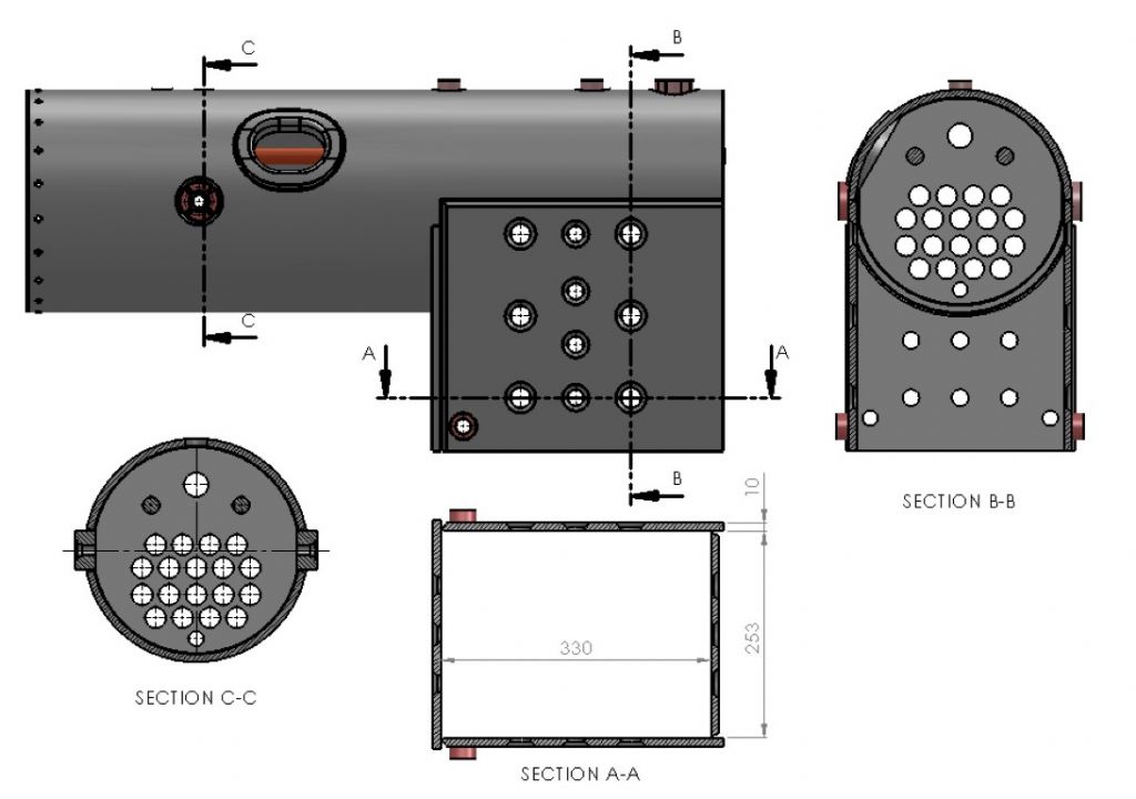

MODEL BOILER DESIGN and MANUFACTURE
Boiler design for the original traction engine
The boiler on the original full size traction engine was 20” OD x 85” (508 OD x 2160mm) overall length.
Boiler wall thickness: ½”
Distance between tube plates: 36”
Fire tubes: 4 x 3” dia and 19 x 1.5” dia.
Boiler for 6” scale model boiler
The drawing for the model boiler specified a 10” OD x ¼” thick steel plate but 10” OD (254mm) is not a standard pipe size and the Australian Miniature Boiler Safety Code specifies that I use ASTM A 106 grade with a wall thickness of not less than 6mm.
I chose to use 10” NB schedule 40 pipe which is the standard commercial size and is 273.1mm OD x 9.27mm wall thickness. Flat boiler plates are 10mm thick.
Because the barrel diameter is bigger than that shown on the model drawings, everything else had to be made wider. The crankshaft has to be made slightly longer and because the hornplates are further apart, the rear axle is also longer.
3D Models of 6” Scale Boiler created with Solidworks
Sectional View of Boiler

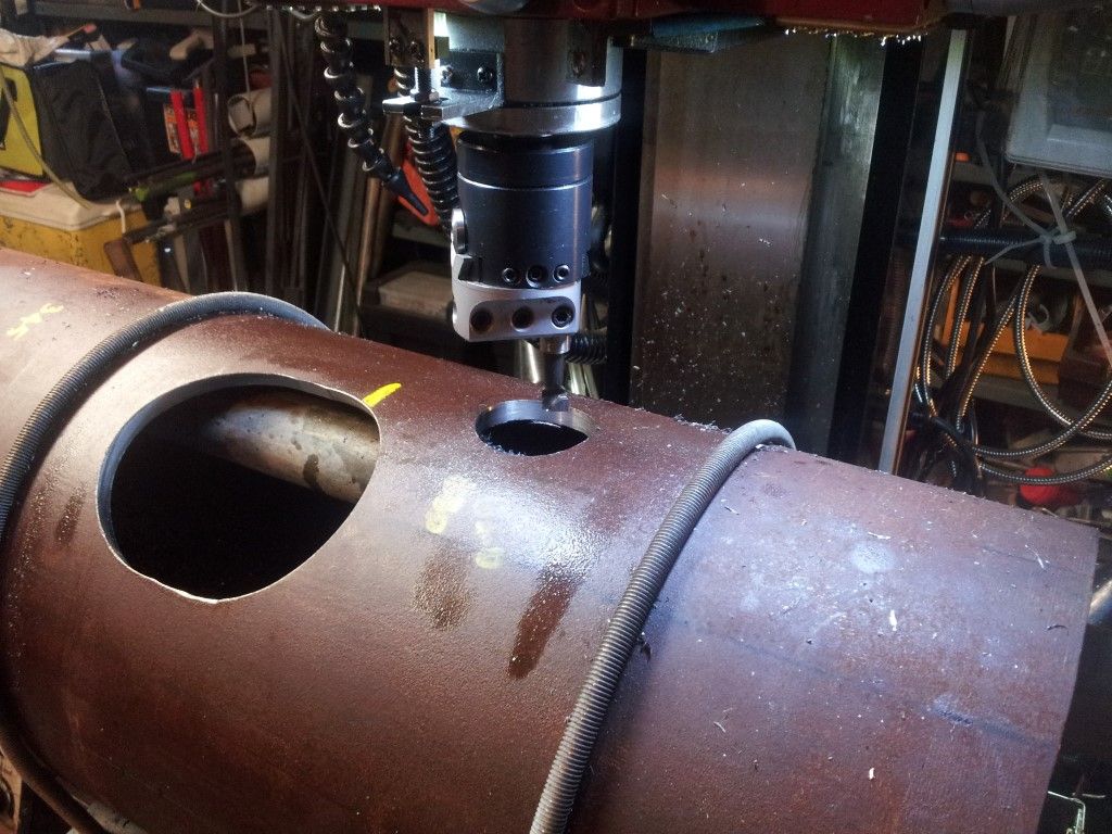

The boiler barrel was supported by a piece of pipe and held at both ends to take the load off the table of my SX3 mill while I machined holes for steam & water ports and for the manhole opening.
There was just enough space under the milling head for this operation and the sliding table is too small to carry such a big load.
Each hole was roughly cut to shape with a rotary broach cutter.
Holes in boiler being bored to their finished size.

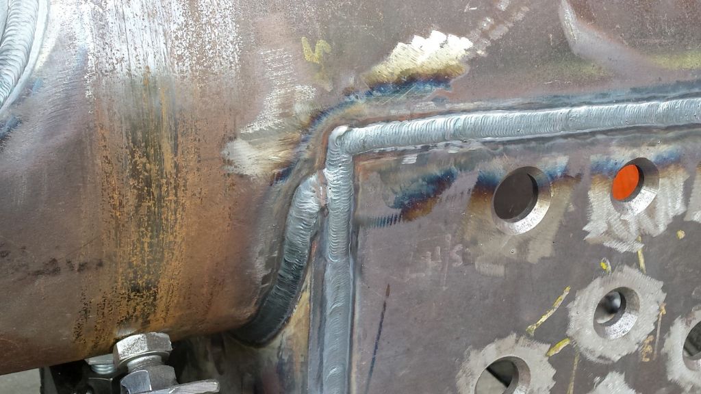

Weld preparations cut by hand with a carbide rotary burr in the chuck of wood router.
The holes for the firebox wall stays were cut with a rotary broach, held by a collet in the mill and then chamfered for welding in of the firebox stays.
The rear plate of the boiler is mounted on a rotary table and a full depth chamfer is being milled leaving a 1.5mm flat on the bottom of the hole of the firebox opening. The exact location for the centers of the each side of the hole is not that critical and was done so "by eye" to line up with the circles which I scribed on the mounting plate below.

WELDING OF BOILER
The majority of the welding of the outer shell of the boiler and the fire box was carried out with a TIG welder. A stick welder was use on a couple of places where there was limited access for the TIG. The welding process took much longer than expected but the finished welds were excellent.
Andrew Johnston01/02/2016 11:35:25
avatar
7061 forum posts
719 photos
Good grief, that's pretty darn neat welding. Must be one hell of a TIG welder to cope with thick steel plate? What size electrode and were the welds done in one pass?
Andrew
Paul Lousick01/02/2016 12:03:41
2276 forum posts
801 photos
Welding done by a top class welder who normally works on high pressure piping with years of practice. Used 2mm rods and multiple passes to build up the weld using a $6000 welding machine. Most of the welds were done from one side only and required a big joint preparation to achieve full penetration. Took about 15 hours to complete the job and consumed an E-size bottle of Argon gas. And boiler not finished yet.
