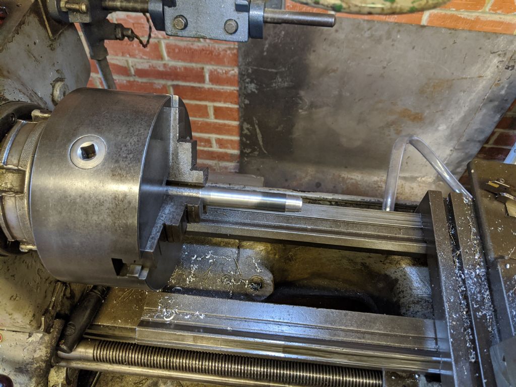

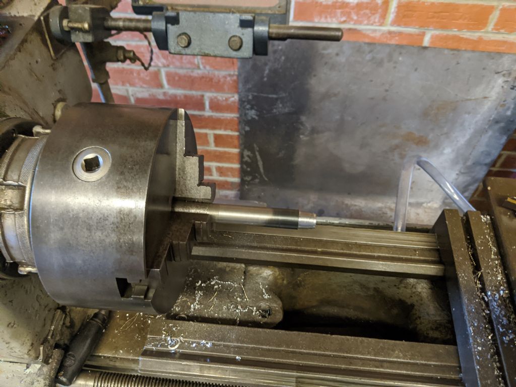

I got the numbers from the old seal, 16210037. I'll just find a new one with the measurements I took
Anyway. I started by trying to use a socket to push it out from the inside. This didn't work well as it just pushed out the leather and messed it up. Not a good start.
Immediately that stumped me as I couldn't get any grip on it any way or tap it out from the inside as it wasnt working. Too tight in there. So I resorted to using my rotary tool to cut away one section of the seal to release the pressure and allow it to come out
This worked quite well but I went a little too deep and took a lttle out of the bore, but that shouldn't make a difference really.
Then I measured
So we have
OD=1625 1 5/8ths
ID=1000 1 inch
T=a bit more than 350, probably 3/8ths
So, I'll find a standard size closest to that 1 5/8x1 5/8x3/8
Like This
Question is, do I want double lip or single lip? And whats the difference

You will have to get some RTV silicone gasket maker and fill the new cut and then hammer the seal in while the silicon is still wet. Next time use a oil seal removing tool or an old tack nail remover.
Go for the double lip seal. One lip keeps the oil in and the other keeps the external grime out and away from the internal seal.
When you install the seal do not smear the silicone around the circumference of the seal. Get some glycerine and smear the oil seal and then use a socket that just fits into the "hole" where the seal must go. You want to hit the seal on the lip that forms the OD of the seal. Anything less in diameter and you are going to bent the flat surface of the seal, destroying it. If you do not have such a socket, you will need to take a wood dowel and carefully punch around and around and around the circumference of the seal until it is seated. Seated is when it is about a hair's breath lower than the housing's flat external face surface. In addition oil the shaft very well before sliding the seal on. Otherwise the edge of the oil lip will bent over and will not seal.

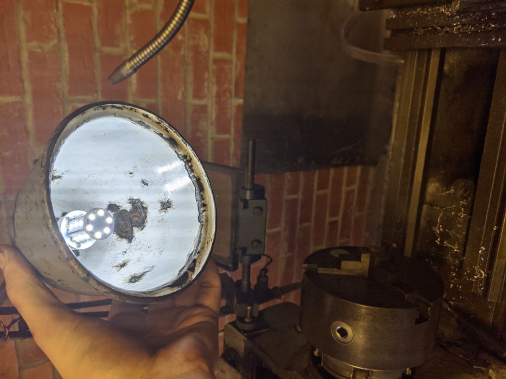

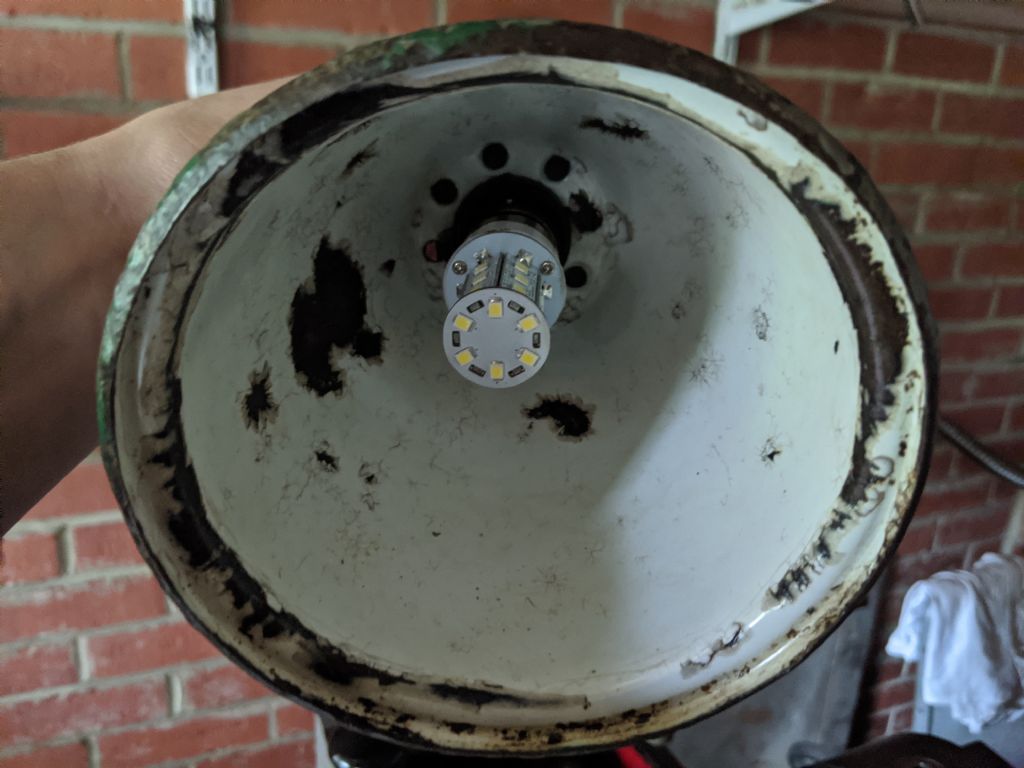

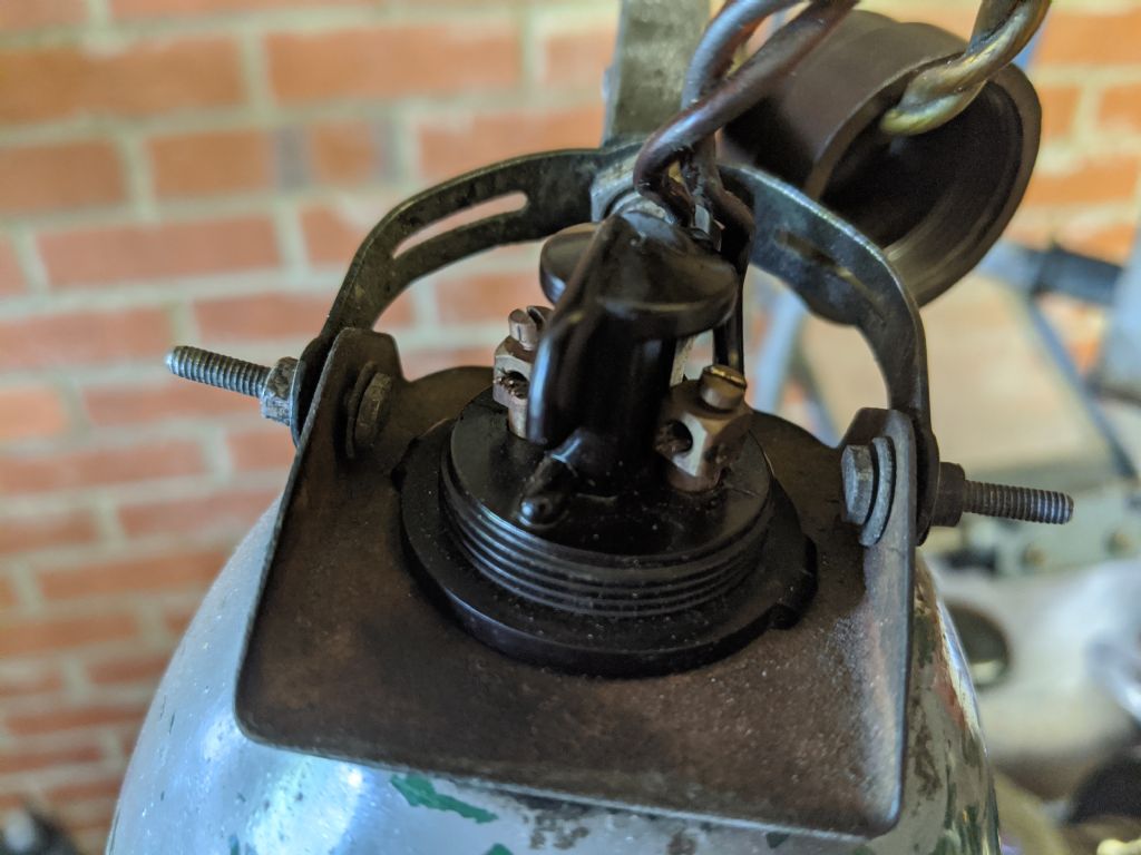

The second lightbulb arrived today, first one is definitely never showing up. So I went out and plugged it in and tried it. Nothing happened, no light, no flicker. How can I start to troubleshoot it? Wiring all seems right, but i'm getting nothing. It's a very cool little bulb with lots of LEDS
Still waiting on the oil seal, and I've ordered some loctite for the gear.

Phil Whitley19/05/2020 12:29:14
avatar
1533 forum posts
147 photos
Herman, I did use the Paragon paints colchester green, it is a bit pricy, but very good quality, it is thinned with naptha, not white spirit, and I believe this gives it better oil resistance. I used slightly less than one litre on my lathe, but I was spraying over a primed and denibbed surface, you use a lot less top coat that way, I also used the paragon thinners.
Richard, start at the back of the lampholder, and see if you have a voltage there, then follow back to the led power supply. Put a 13a plug on the led supply and see if that works, I think by then you will have found the fault. also check the bulb with a power supply to check it is ok. if you have voltage at the lampholder, check that both pins are free on their springs and can be compressed and pop out again.

@Richard, as @Phil said start tracing at the output of the transformer up to the two pins in the holder. Also check that the switch is working!

Richard Kirkman 119/05/2020 14:31:06
334 forum posts
799 photos
Thanks Howard

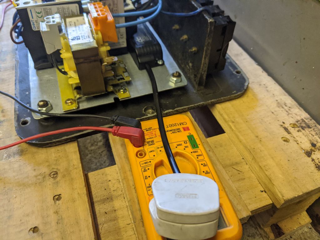

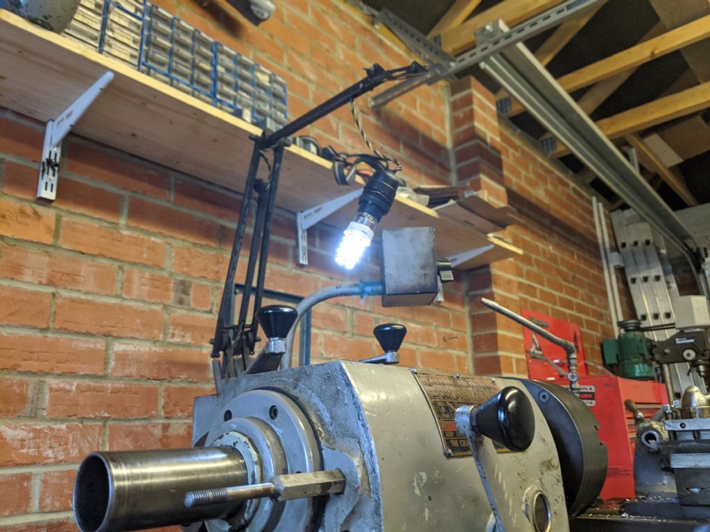

We finally have light!!!!!!!!!!!
It's taken a couple of months but we're finally there
So, I started by taking the light out and checking continuity for everything
Then I went in the cabinet and checked there. Everything had continuity and was working. Absolutely no idea what goes on or really how to check voltage.
So, I put a plug onto the 240v to 12v transformer
Then I plugged it in and nothing. Absolutely nothing. So, I put the multimeter to volts or something and started prodding things. It should have only been 12v so i wasn't too worried, but I was still careful.
Then I was just playing around. I looked up and it was on. No idea what I did, if anything at all. It was running from the plug, which was great. Then I took the plug off and put everything back together. Low and behold, it still worked. Not a clue what I did or what happened, but it's now working.
Light off
Light on
It just adds that bit extra lighting. Was it a lot of effort? Yes. Was it expensive for a light? Yes. But is it exactly what I wanted? Definitely as it fills the hole and remains contained in the lathe. The lamp seems to be very good and holds in place where I put it, unlike the lamp I have on my wood lathe.

Herman van der Merwe19/05/2020 15:33:18
avatar
180 forum posts
Good news. Most likely you screwed the screw of the termination block onto the sheathing of a wire and it did not touch the wire. When you did the plug thing and you screwed the wires back in, it then contacted the wire. Presto - current flows!
