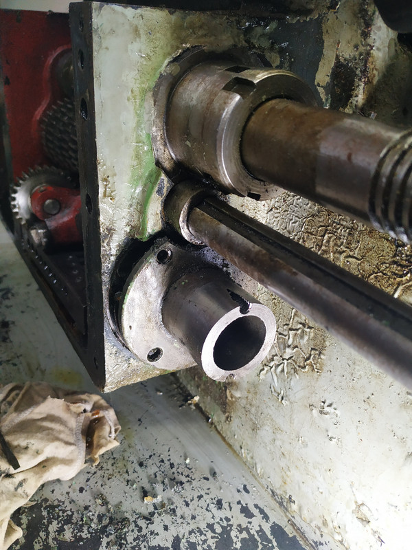

Richard Kirkman 116/05/2020 20:52:27
334 forum posts
799 photos
A few more pictures to Illustrate.
There seems to be some red stuff which I presume is the gasket material. I think the bolts had some red on them too
Red stuff doesn't scratch away easily. Someone could have added glue to stop it leaking at some point?
Herman van der Merwe16/05/2020 20:57:50
avatar
180 forum posts
My lathe has the cap screws located in the smaller diameter collar that stands out from the larger flange.
This is how mine came out.
Herman van der Merwe16/05/2020 21:01:23
avatar
180 forum posts
The red stuff is gasket maker. You need to heat it up with a hot air gun and then stick two putty knives in there to wedge it apart while the gasket stuff is hot and soft. Only way to get the red gasket stuff off is to wire brush it with a brass wire cup.
You can also make three hard wood wedges and drive these in between the flange you want to remove and the headstock body.

Phil Whitley16/05/2020 21:02:00
avatar
1533 forum posts
147 photos
Red hermatite gasket cement, thats why it wont come off, it sets, not mega hard like Osotite, but hard enough to need wedges or an extractor to give it a straight pull. Hermatite is non standard on Colchesters, so I think we can guess it has been off before! Can you use a longer bolt in the threaded hole to push against the headstock and gently break the seal?
