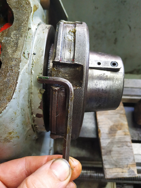

Any idea how to get the spindle's chuck cone loose?

Posted by Herman van der Merwe on 12/05/2020 12:55:55:
If by chuck cone you mean the L0 taper part, that's part of the main spindle, so the whole spindle must be removed which I have covered earlier in this thread. There is also a guide in the manual I sent.

If you look at the attached photo you will see that I cannot fit anything between the nut and the cap screw head. I did read your forum post and the manual's section, but alas my lathe's spindle is different. It looks like the cone part can unscrew.
Richard Kirkman 112/05/2020 16:16:17
334 forum posts
799 photos
Okay fair enough.
Having the l0 taper screw on and off defeats the point of the taper though. So I don't think it screws off.
Could you try removing the whole spindle?

Hi Richard, you might have seen on groups.io that I did get the spindle out after a LOT of struggling.

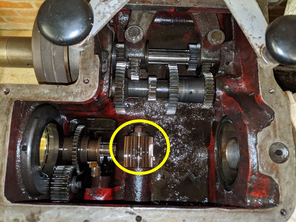

How did you manage to get this gear off the shaft? Mine does not want to move.

Yes I have seen. Very interesting stuff, I wasn't expecting your spindle to be anything like that. Enjoying your thread a lot!
The gear was quite hard to get off. There's a locknut on the end of the shaft which must be removed, then there's a washer then the gear comes off. However, my gear was quite stuck. Eventually, after a lot of pulling and pushing and cutting my knuckles on the gears behind it, I managed to work it off. I didn't take out the other gear shaft, but If you have then it should be much easier access as I struggled and ended up pulling and pushing on the actual handle which risked damaging it. Luckily nothing broke for me, but it's worth mentioning.
Then, if memory serves, there is a leather washer behind the gear which acts as a gasket. My lathe was leaking from that shaft so I made a new leather washer which I made very tight to make sure it didn't leak anymore (1 month later, it's still not leaking) Then just reassemble in the opposite order.
Good luck
I'm not sure that yours will be the same as mine. I'll have a look at the pictures of yours
