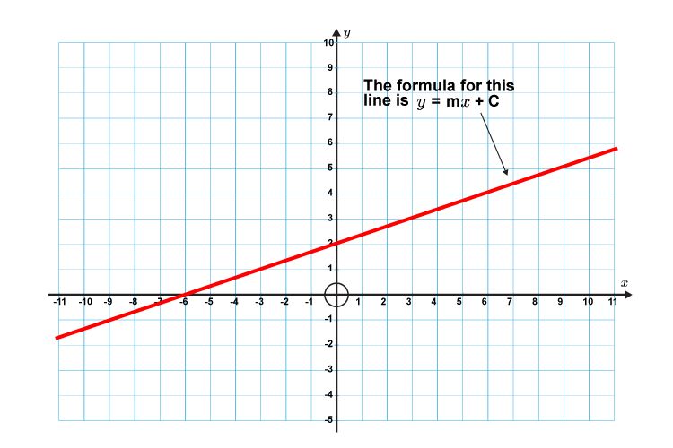

My next problem is mathematical and although I'm sure the answer is easy I've failed utterly to do the algebra.
At the moment, the Arduino calculates HHMMSS by assuming every tick is average, which isn't true. Apart from the wildness noted above, according to the data the pendulum reacts to heat, air pressure and humidity. (Still to be proven, but I'm fairly certain the Arduino responds to heat, not the pendulum.) A little difficult to disentangle the two, but there's strong evidence the pendulum is influenced by both air-pressure and humidity. Higher air pressure reduces the weight of the bob and increases air resistance slightly. To make a rod, carbon-fibres are embedded in a resin matrix and it's likely the matrix is sensitive to humidity.
As the clock knows what temperature, air pressure, and humidity are, I want to correct the average tick by applying a compensating formula. Linear Regression gives the following y = mx + c values:
ticks = x, temp = y : -19.98002063 35.27297589
ticks = x, humidity = y : 52.18719052 16.32451551
ticks = x, pressure = y : 81.65298034 901.6873213
How do you convert a y = mx + c slope into the corresponding correction? For example, given the period of a tick tick at a known temperature, how do you calculate value of tick for any other temperature?
I thought this was easy until I tried to do it . Brain refused to cooperate as soon as I put pencil to paper...

I think you need the multivariate regression coefficients first of all. Then if you assume that the period P is given by something like:
P = P0 + a x temp + b x pressure + c x humidity
then you just subtract the last 3 terms from the measured P to get P0. Excel or R can calculate the multivariate coefficients,

Back to the theory. Assuming the variation is linear, the relationship between temperature and frequency is represented as a straight line graph obeying the standard formula y = mx + c
If the values of 'm' and 'c' are found the frequency of the crystal at any temperature can be predicted, allowing temperature compensation to be applied. In a mechanical clock, compensation is done by carefully selecting and dimensioning suitable materials to alter the length of the pendulum: not easy to design! In an electronic clock no need to change the mechanics because numbers can be corrected by formula. The microcontroller eliminates a tricky mechanical issue by doing a sum.
Extracting 'm' and 'c' from a dataset turns out to be a well-known problem and the Python numpy module I'm already using has a polyfit function that does the job in a blink. m=-5.21113 and c=15997975.666. The bottom graph shows applying the formula reduces drift from about 30Hz to about 6Hz, a worthwhile improvement.
The python program needed to crunch the numbers is another easy when you know how job!
