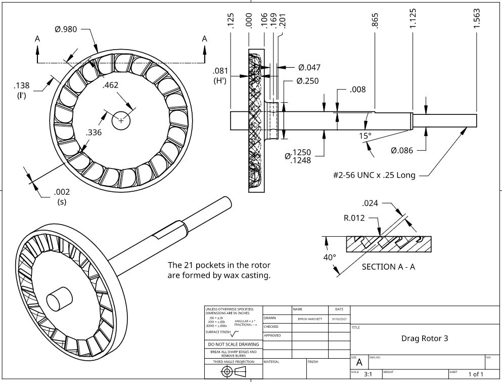

I designed Drag Rotor 3 following all the guidelines from Shapeways. The two guidelines I missed on Drag Rotor 2 were keeping the minimum thickness greater than 0.6mm minimum for bronze and having a sharp edge on a thin section. The blades on Drag Rotor 3 are 0.6mm thick and have a round end. The following picture shows a 3D view of the blades. The drawing for this rotor will be shown in the next post. I should point out that Shapeways minimum thickness is not the same for all materials so should be checked. I may try this rotor if I have a problem with Drag Rotor 2 since it will work with the cast housing and cast cover plate of Drag Turbine 3.Drag Rotor 3 Blades

This is the drawing for Drag Rotor 3. I had to make the pockets deeper and reduce the number of blades to open up the flow area with the extra blade thickness.

Werner Jeggli06/01/2021 14:26:08
28 forum posts
6 photos
Am I correct in assuming that the use of the Spencer one sided blower principle to a turbine rotor would result in a bidirectional turbine while your adaptation is uni-directional. Would be a big disadvantage for model applications!
Werner
Turbine Guy06/01/2021 15:15:09
541 forum posts
578 photos
Hi Werner,
If the Spencer blowers use 90 degree blades they would be truly bidirectional. You are right that using the 40 degree blades makes the turbine almost unidirectional. My design would have some torque running in the opposite directions if the flow in the ports is reversed. You bring up a very interesting point about running in both directions, I have not looked at that. Using the 90 degree blades would make the drag turbine truly reversible but quite a bit less efficient. The maximum efficiencies found for the tests of 90 degree blades and 40 degree blades in 'A STUDY OF HIGH ENERGY LEVEL, LOW POWER OUTPUT TURBINES' by Dr. Balje are 20% and 33% respectively. These were from actual tests so should give an indication of the difference in efficiency. We have both seen that things don't always work out the same for miniature steam models so there might not be this much difference. I may try a rotor with 90 degree blades and see how it does.
Thanks for bringing this up,
Byron

Roger Best10/01/2021 19:39:28
avatar
406 forum posts
56 photos
Posted by Werner Jeggli on 06/01/2021 14:26:08:
Werner
Hey Werner, what model needs a shaft speed of 25000rpm? Almost everything, other than a noise maker, will need a reduction gearbox and that means direction control is possible.
The main problem all small models have is efficiency, so optimising for power is a good start. yes
Werner Jeggli11/01/2021 16:09:19
28 forum posts
6 photos
Hi Roger,
You are right of course, but then you will have problems with remote controlling the reversing gear because of unsynchronised tooth positions. In addition it will not be possible to dynamically brake the model with counter steam. I built such a gauge 1 turbine loco drive many years ago - that's why I know.
Turbine Guy11/01/2021 19:00:13
541 forum posts
578 photos
Hi Roger and Werner,
If the drag turbine works well enough to demonstrate the efficiency estimated by Dr. Balje can be approached with my tiny model, that would indicate that an efficiency in the range of 15% to 20% could be obtained with 90 degree blades. The best efficiency I have been able to obtain from my tangential and axial impulse turbines using my airbrush compressor and smallest propeller is approximately 14% as shown in the table below. If an efficiency of over 15% can be obtained with 90 degree blades, it would be higher than I have been able to obtain up to date and have full power in both directions. This would be quite a bit less than the 28% efficiency I hope to get with the 40 degree blades but would still be a major improvement and I think worth testing.
Thanks for the feedback,
Byron
Turbine Test Results 11
