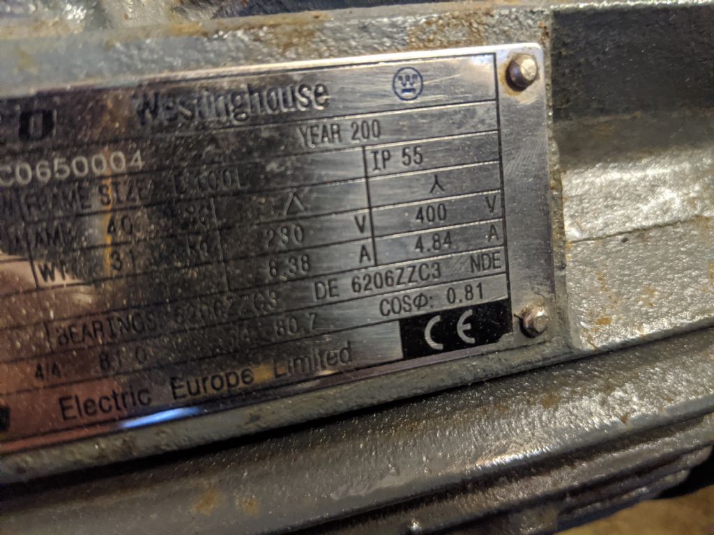

Richard Kirkman 128/03/2020 20:45:27
334 forum posts
799 photos

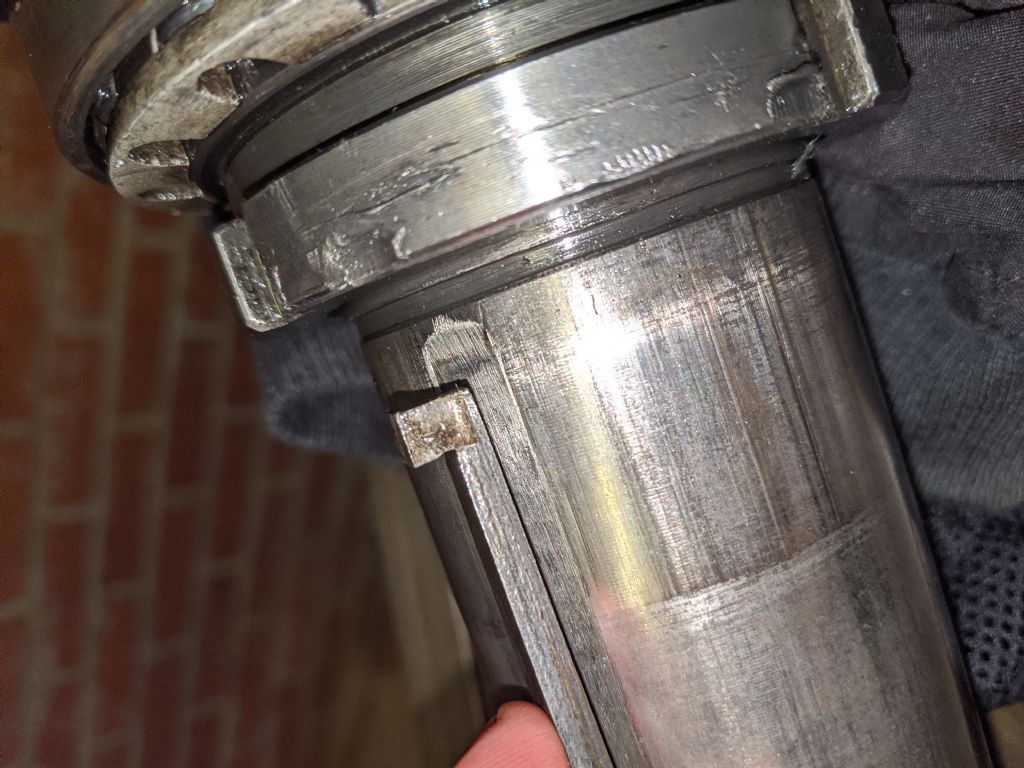

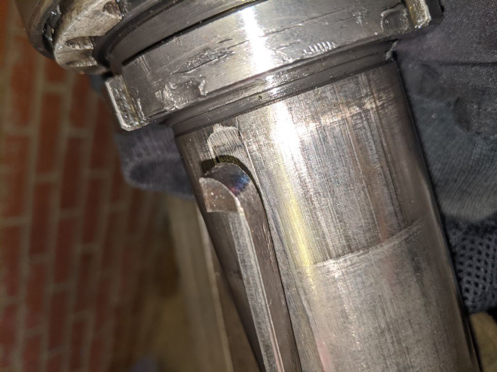

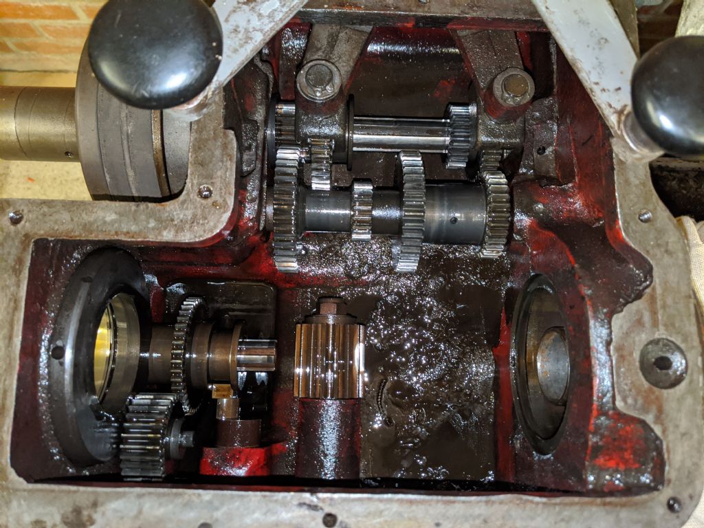

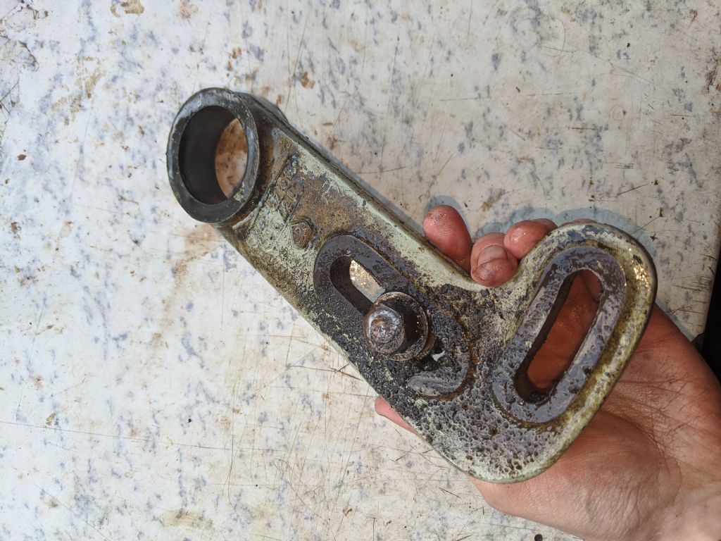

Had a scrub at the end of the tumbler shaft, definitely no Dutch key.

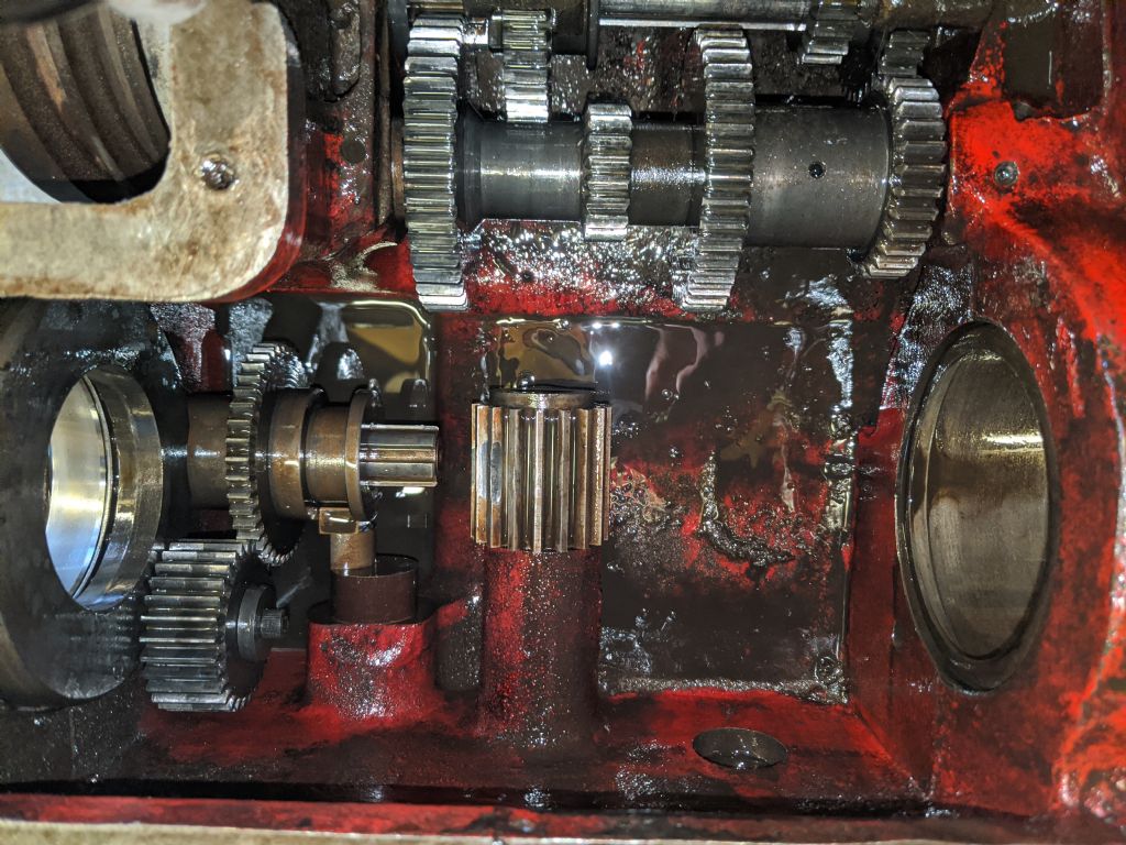

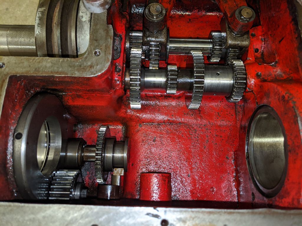

Inside of the headstock is looking a lot cleaner than it was, and I can't really get it any cleaner without taking more parts out, which I really don't want to do. So I'll reassemble tomorrow. If you look at the before and after, it's a lot better than it was

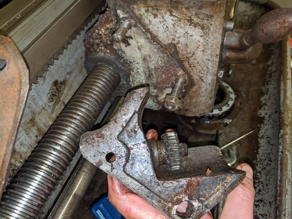

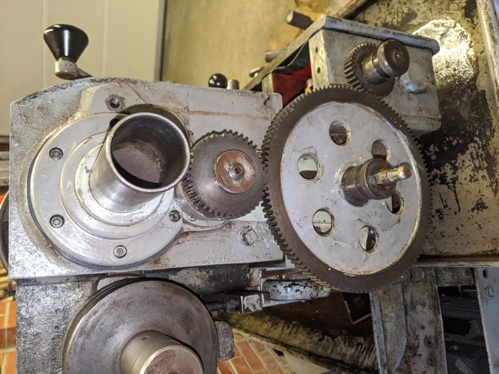

Took off the thread counter and found lots of rubbish behind there tooimg_20200328_195051.jpg
I need to sort out the little lighting transformer to get the electrics finished.
So I need a transformer to take the 415v to 250v then use my current transformer to get it right?
I also need to order the correct length belts now the motor has changed, the old ones don't fit at all
Thanks for your help today Phil, big progress!

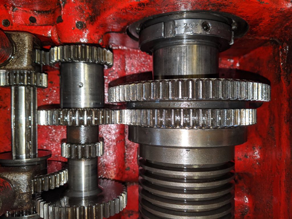

Reassembly has had to come to a stop.

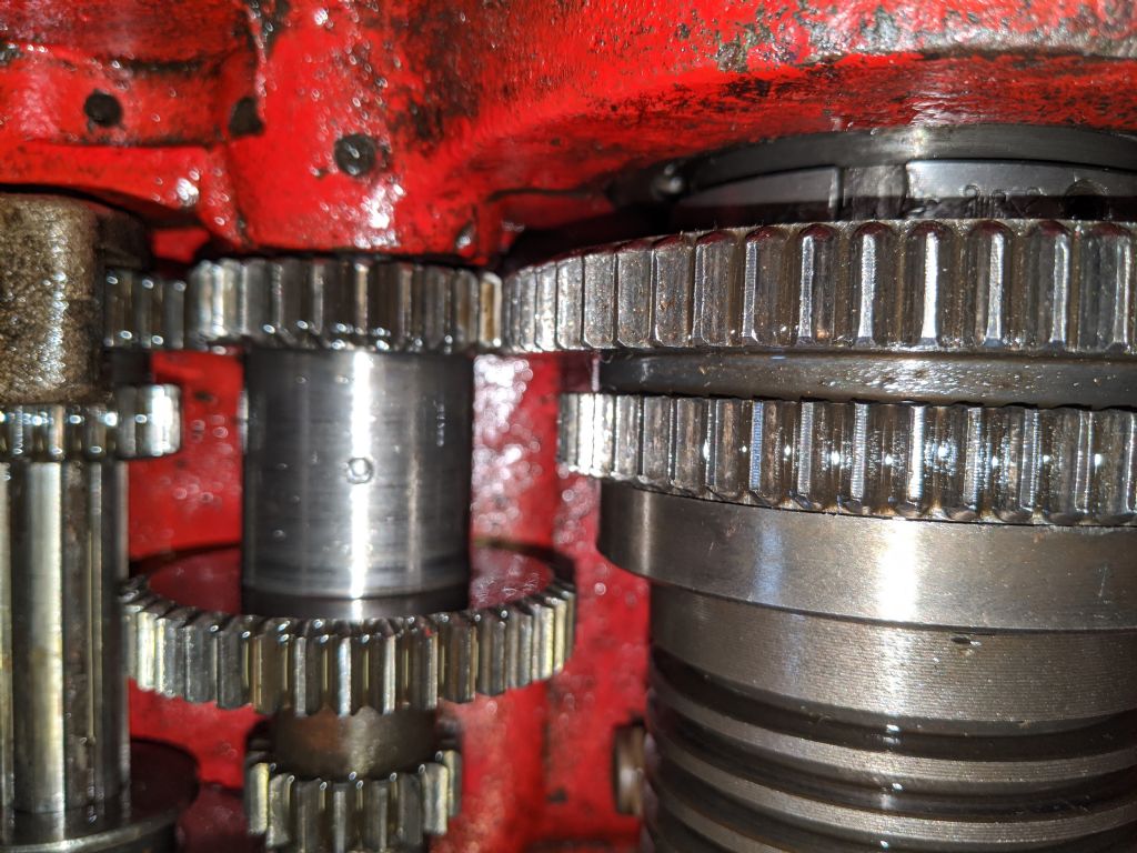

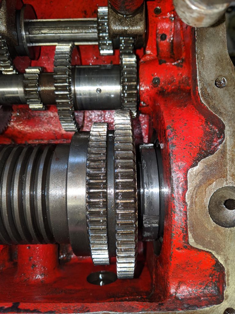

I'm getting gear misalignment between the main selector ones. Once the spindle is back in, the gear just will not slide over any more than that. There's nothing clearly blocking it that I can see. So I have no idea why it's happening
Any ideas? I'll go back and take another look but I think they should line up more than that. It was like this before I took it to pieces too
Phil Whitley29/03/2020 15:15:08

Hi Richard, I am going to the workshop tomorrow, so I will take a pic of the dutch key in my machine, unless I have one on file, I will look today
Re the gearbox problem, have you got the mesh on the sliding shifter one tooth out? that is certainly not meshing sufficiently with the driving gear! I gather that the gear is not coming in to contact with the boss on the spindle visible in your picture. If there is a stop on the sliding shifter handle, the handle nay be hotting ther stop before the gear is fully meshed. No doubt this problem is in my future too, when I replace my spindle bearings.

Meshing problem solved. The keyway in the spindle was machined in using a horizontal mill, so the end of the keyway has a radius, but the key only has a radius on one end.
When I first got the machine, the gears were misaligned, as I replaced a part and made sure to put the key back in the same orientation, which was wrong. Anyway, now it's in the right orientation, the spindle went back together beautifully, first try as well!
I had pictures of when I first received the lathe so I could see if there was any damage in there and they were definitely misaligned then too. So big improvement
I managed to find the picture of the headstock the first time I'd drained it, makes for a pretty before/after picture. A vast improvement

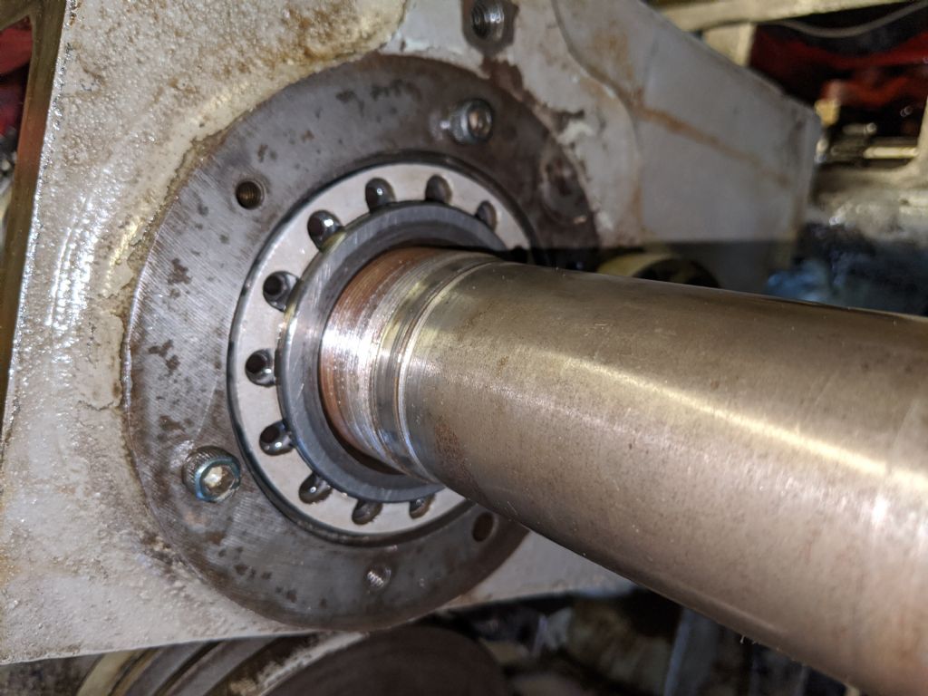

As for reassembly, it's just the same as disassembly, but backward. Phil, you'll need to take the main spindle apart a bit further to access the front bearings in there if you can see them, You'll need some c-spanners to get the locking ring off I think.
To start reassembling, put the main spindle through the right hang hole, with the sliding gears already in the headstock, slide the spindle through them as you insert it. You must put both gears on at this point, but the ring spacer at the end can be left off as that can be slid on at the end. Leaving this off allows you some space to fiddle with getting everything aligned onto their keys and to get the handle into the right position for the sliding collar since you need to account for the movement of the spindle pushing the handle back over.
You've got to make sure the spindle lines up with a bass/bronze pin that you can just about see in the last picture. This must be aligned before you start to tap the spindle back in place. The actual part that the bolts go through can be spun into place later, but the spindle must be started in the right place, with the oiling hole that you can see, facing directly up to the sky.
Richard Kirkman 129/03/2020 17:19:50
334 forum posts
799 photos

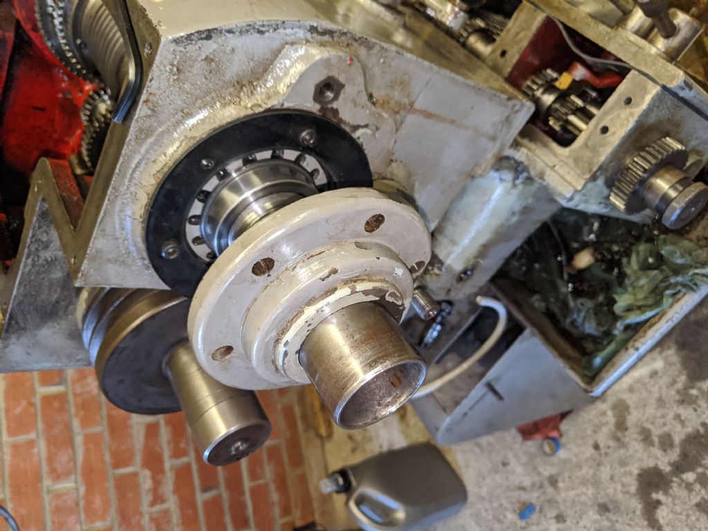

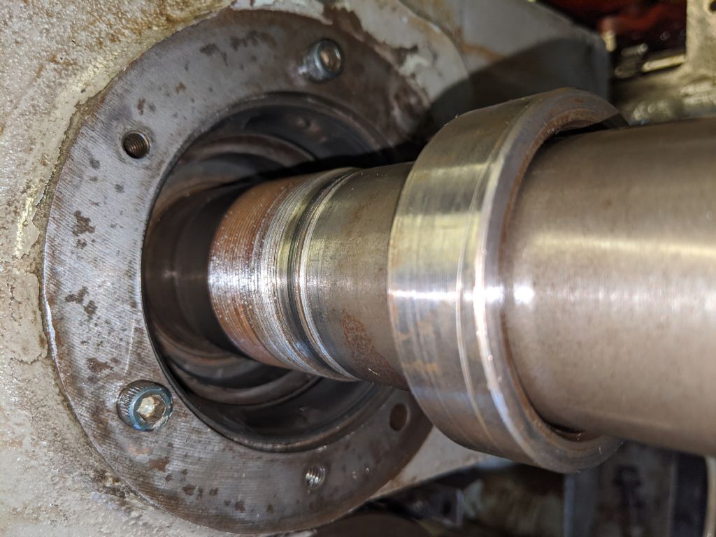

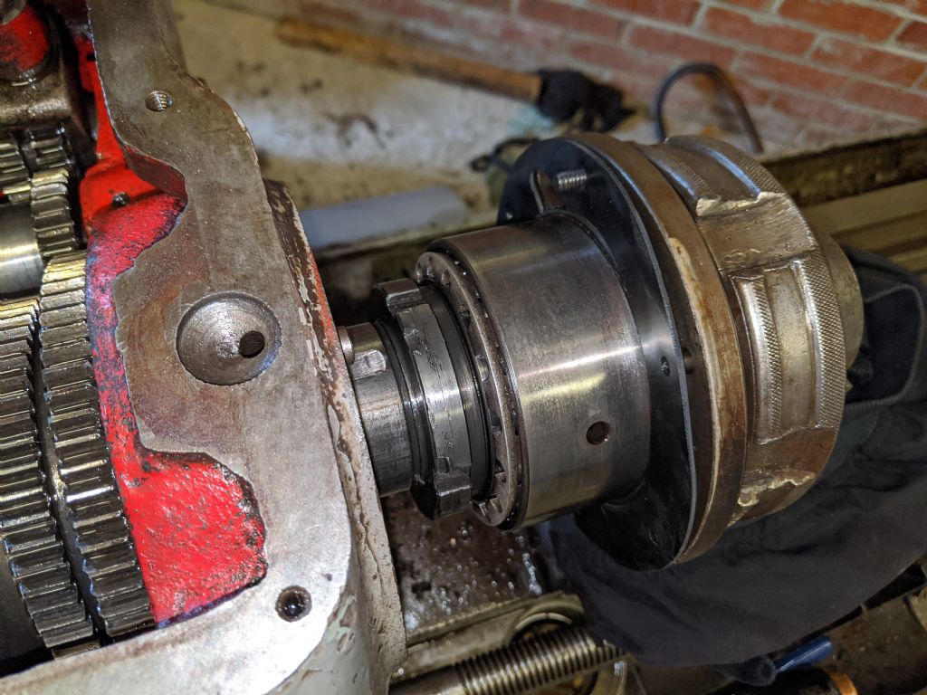

As the spindle is tapped back, using a copper mallet or block of wood and such things to not damage the spindle nose, put in the rear bearing as this will help align the shaft and make sure it is going in square. This helps it go in much easier
Once the spindle is back in place, you must put all the bolts in, lining up the gasket at the same time. I made my gasket tight over the bolts so that it would stay in place and aligned while I tapped the spindle back in
Then you can slide the spacer ring back on that I was on about earlier. If you put the bearing back in to align the shaft then this must be removed before you can do this.
Then the bearing goes back in

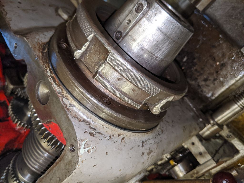

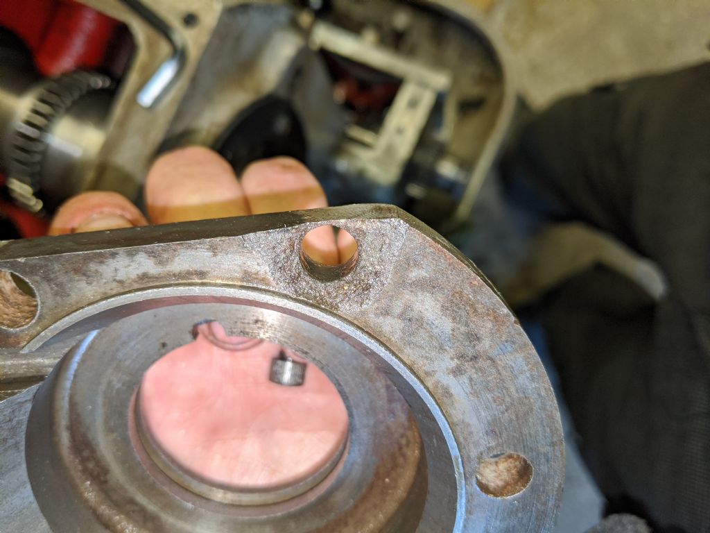

Then the locking ring, making sure to tighten it down quite tightlyimg_20200329_155434.jpg
Then I put my gasket and end cover back on.

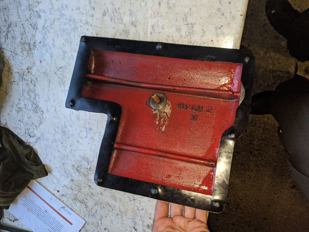

I realized as I was doing this that it wasn't going on square, so I took it off and had a look.

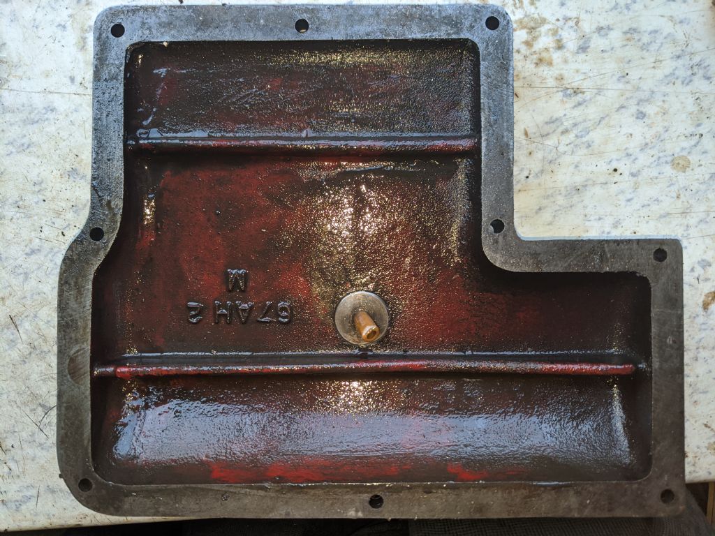

I knew the casting was broken, but I thought it was broken on one of the through-holes. Turns out it had broken in one of the recessed holes, making it a through-hole, so this piece is only being secured by two bolts. Not ideal, but it will do for now. I'm still trying to get spare parts from Tracy so hopefully, that'll come too.
This means it's not applying lots of pressure to the gasket all the way around, so it may leak there, but I tried to tighten the other bolts up enough to put a bit of pressure on it. Hopefully, it'll work.
So, it's all back together, I can continue to work on cleaning it up. I've put some PTFE tape around the plugs so they won't leak anymore either.
I have more than enough gasket material to make at least another 20 sets of gaskets, so I'm going to replace the one from the headstock too.

Not too sure how the motor will be running. Is it simpler to just spend the 25 quid on the transformer and wire that up?

On the tumbler shaft, i will post up a pic of mine, but it is essental to lock the shaft to the handle once the gears have been set up to mesh correctly in all positions, and if yours hasn't been dutch keyed (VERY odd, but it is an early one) then they must have used some other method, which is the reason it won't come off. It seems to be there in the handle, but not the shaft. Has someone fitted, or even made, a replacement shaft? Take the clamping bolt right out of the handle, and have a good look around it for hidden roll pins or screw holes.

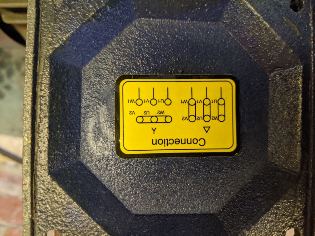

As to the motor thing, it will be running in star, but whether you could do as I suggest will depend on whether the star connection point is in the terminal box, or buried in the windings. If the motor can be connected in star or delta, it will be. It is an option for future consideration, and would provide an "onboard" neutral without extra wiring and five pin plugs and sockets.

"If the motor can be connected in star or delta, it will be" (should have continued) in the terminal box!.

I finished off yesterday by cleaning up all the parts that had come off. So all of the gears on the end have had a thorough degreasing and toothbrushing till they were the right colour again!
It's looking much better. However i'm still at that stage where I don't really feel like anything is properly finished? Even though I've done a lot

As for the motor neutral stuff, I have no idea. I still need to wire in the new motor, but I'll look in a few days. I'm still fancying the transformer more.

Here you go Richard, the dutch key!
Phil Whitley30/03/2020 16:00:30
avatar
1533 forum posts
147 photos
Note that the shaft on mine has a shoulder that yours doesn't have!
Richard Kirkman 130/03/2020 21:18:07
334 forum posts
799 photos
You're right, mine doesn't have a shoulder. I'll have another look at mine tomorrow or at some point

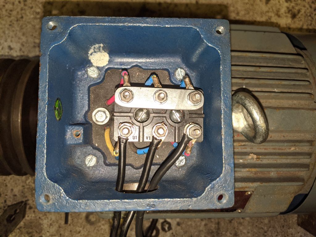

So that's how I've wired it. Seems fine to me

Will that transformer that you linked to from rs do the job that I need. So I wire from the 415v to the transformer. Then to the low lighting one? Because I need to order the new belts as well. Plus it would be nice to get All the wiring finished

Hi Richard, the star point is the metal link across the three terminals in the connector box, so you could take a wire from there and it would be a neutral as far as its relationship to any of the other phases is concerned, but after another "DOH" moment, I realised that this is only when the motor is running, and to have the light go out when you stop the lathe is unacceptable, to say the least! Get the transformer, and link it to your existing LEd power supply.
You need to get some flexible conduit and end bushes to go between the contactor and the motor terminal box, those wires are only single insulated, and would chafe through in no time, plastic flex conduit and end bushes are VERY cheap, local electrical wholesaler, or screwfix. Always be doubly safe with three phase! short circuits between phases are LOUD and quite spectacular!
The RS transformer appears correct, as long as it is continously rated for use, I would prefer it if you got RS to confirm it as suitable, explain the use you want to put it to in an email to their tech dept, and they should be able to confirm it is correct for purpose. I have a natural aversion to loud noises, even at this range!

Afterthought!
you would be connecting the new transformer across the two fuses that originally supplied the lighting transformer, so it would be a protected circuit, so if the transformer did fail, it would just blow a fuse! no loud bangs, very undramatic!!

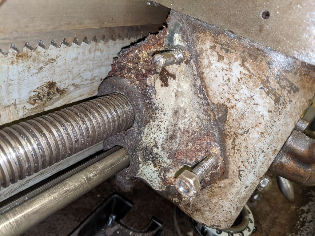

I'm not entirely convinced mine is leaking from the drain plug, I think it might be leaking from the broken casting bit, then running down and dripping off the plug. So, I'll wait till I get the replacement part, then I'll take it all to bits again.
Rs said they didn't know if it was continuous duty or not. I'm sure it'll be fine, so I've ordered it along with the new belts.

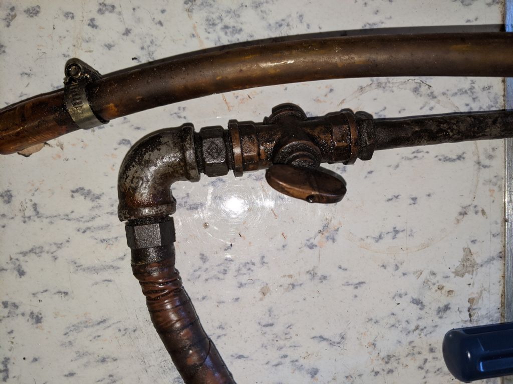

The coolant tap may need replacing as I took off all the tape that was on it and its a bit broken. Unless anyone would recommend how to fix it? I'll put up pictures later
I've ordered myself some new pipe for the coolant pump too since the old stuff was orange and I couldn't clean the inside

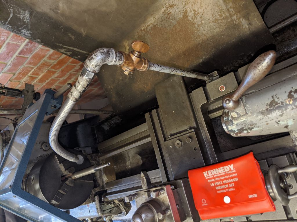

Coolant pipe all sorted today. Had to wait for wood to glue again, so did a bit of cleaning. Think I need to take the light to pieces if the wiring is going to be done soon
I think it looks quite fitting. The splash guard at the back isn't original. No idea where it came from, but it doesn't fit very well. Still need the tube to arrive, but that shouldn't be long
