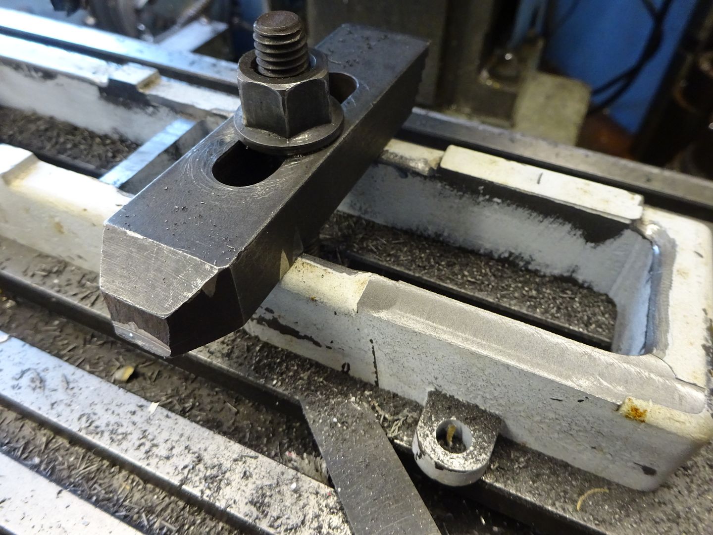

JasonB27/05/2021 07:12:41
avatar
25215 forum posts
3105 photos
1 articles
Take a cut at say 1.2mm from stock top and then measure how high that side is compared to the other and lower your tool by the difference. Probably would have been better to do upto the edge of the cross head guide pad and not the narrow cut the other side then no blending needed, if you have the movement with the second setup I'd set it to just skim upto the edge of those pads
At the end of the day you are replicating a casting and some deviation is desirable and helps make it look like a casting rather than painted barstock. Look at this shot of where I machined off the unused bearing pad on the Victoria I did recently, one end is about 5 thou above the surrounding cast surface the other a similar amount below and thats over 2" distance.
All blends in fine with a bit of Dremel, file and Emery work
Dr_GMJN27/05/2021 08:51:22
avatar
1602 forum posts
Thanks Jason.
Yes, the initial idea was to do as you suggested and machine up to one side of the right hand pad. I changed my mind because I wanted all four pads exactly the same length, and was using the DRO datumed on the left inner edge of the bed. If I'd have only machined one side, any error in the bed length would have thrown out the DRO reading when re-datumed at the other end after swapping the part on the bed. OK it seems less than 0.5mm, but I didn't want to take any chances - my mill bed and all my accurate measuring equipment can't accommodate these part lengths in one go.
I suppose I could have machined to the scribed lines, but I went down the track of getting pad widths perfect rather than simplifying bed height match. Anyway, it'll be fine once sanded.
I did notice in the article that it was suggested to relieve the centre and end undersides of the bed, to guarantee the pads contact. Is that what you're checking with the feeler gauge in the picture? I thought of finishing everything, then just flatting the middle and ends with abrasive paper just to give a fraction of clearance. At present they're flat all over.

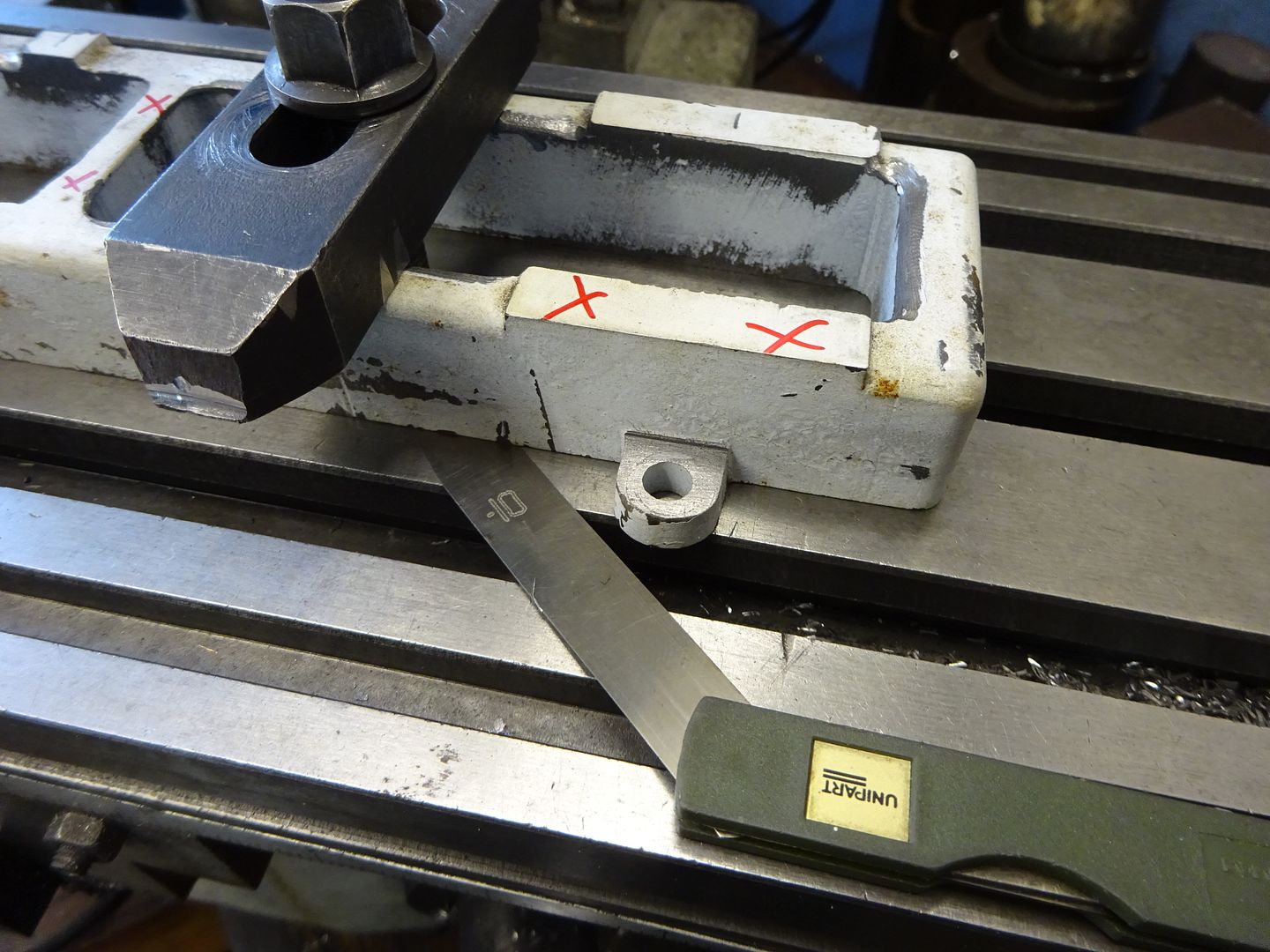

JasonB27/05/2021 10:58:41
avatar
25215 forum posts
3105 photos
1 articles
The bed had been part machined when I got it and the bottom possibly just filed which meant it rocked on the mill table so I shimmed it up with feeler gauges so that the clamps would not distort the bed and subsequently machined the tops of all the pads and the bottom flat.

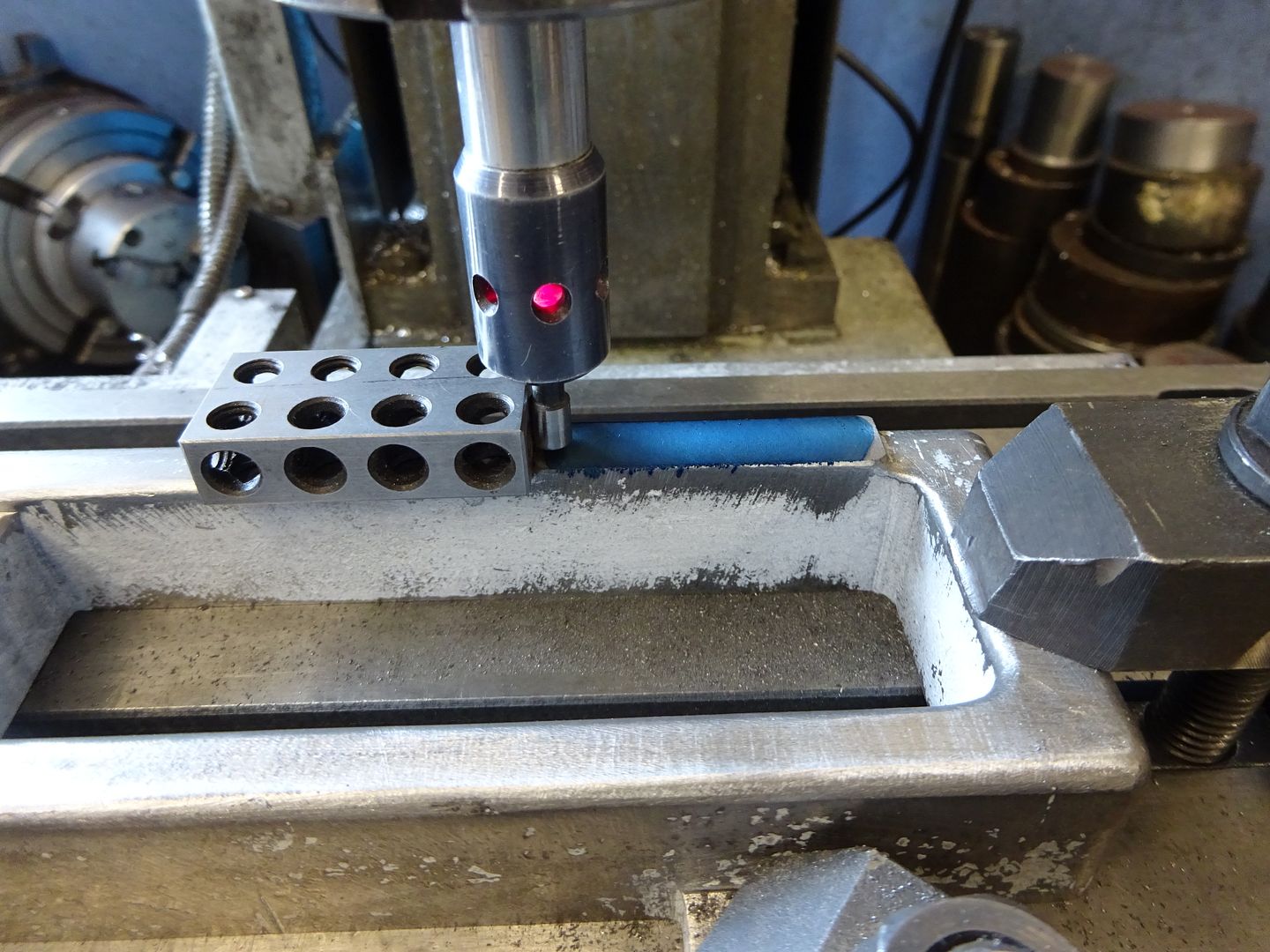

Dr_GMJN06/06/2021 20:35:43
avatar
1602 forum posts
Back on this one after a week in deepest West Wales...
After finishing all the pads (needed four setups), and drilling and tapping all the holes, I set up for skimming the pads:
I took a 0.1 mm cut, again using four setups, but with the z-axis locked:
All flat and parallel:

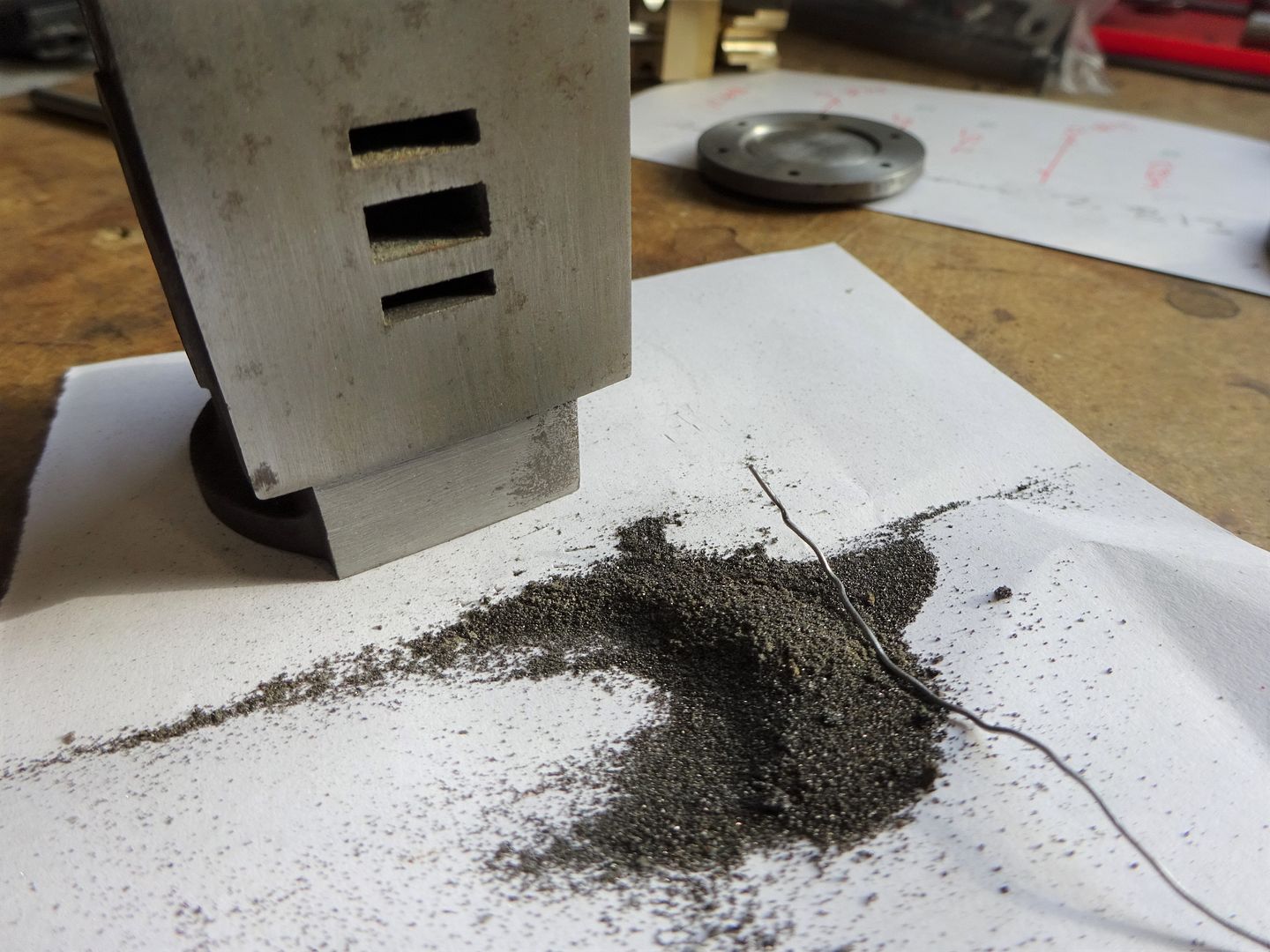

JasonB19/06/2021 10:01:55
avatar
25215 forum posts
3105 photos
1 articles
You don't need a full strip in the middle so short bits will do or anything that could be cut to 1/2" long.
Don't forget to poke some fuse wire down the cast steam passages as they are often still full of core sand and you don't want to go spreading that over your machines

Dr_GMJN19/06/2021 17:59:37
avatar
1602 forum posts
So on to the cylinders - I needed to clean them up to get an idea of the diameter to machine into the modified feet blocks.
I actually have three - one was damaged when I got it; looked like whatever was used to separate it from its runner might have cut into the valve face:
There isn’t much machining allowance on there, so I sent a photo to Stuart Models who immediately sent another (excellent service). The intention is to use the damaged one for a machining test run, so I bodged some JB Weld into the cuts:
I cleaned the other two up, initially with a wire brush:
and removed the drain cock pads with a file, in preparation for fitting the feet:
But then I noticed quite a bit of scaling on the surface, which wouldn’t come off:
The file just skated off it, so I resorted to a grinding bit in the Dremel:
Which seemed to do the trick, but there’s still a lot to remove. It’s worse on one casting than the other two. I wonder if putting them in the fire made it worse. I’m thinking of trying to remove it from the cylinder bore as well, before machining. I now understand What all the fuss is about regarding casting skins, and them ruining tools. There was none on the 10V.
Also began poking the steam ports with wire to remove any residual mould sand - again, one was much worse than the other:
So current status is two are about 50% fettled, still waiting for the JB weld to set on the other:
