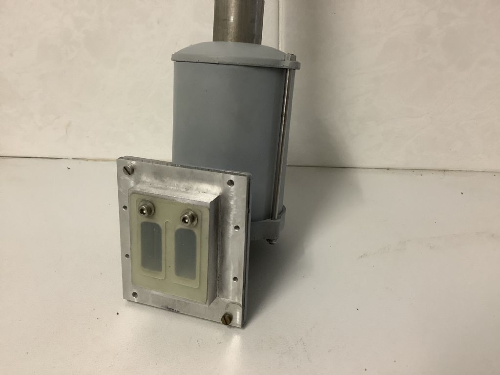

5939552f-c8a6-497d-be41-3e3a89a3d476.jpegNo this is not a pot belly heating stove but the air filter and intake pipe for the tractor. I have yet to make the casting that connects it to the back of the engine and reed intake block. The top and bottom are aluminium castings and the side is rolled steel sheet. I have decided to make a new crankcase casting as there are areas “ in need of improvement “! I am in the process of a redesign of the internal core and that means more 3D printing and I have to work that in with the weather as we are in storm season and I do not want any equipment damaged by lighten strikes or stop half way through a 15 hr pint! While the printer is busy I will be designing other small parts and reading about hot bulb engines. There is always plenty to think about and do.

This week I have made and machined the three castings for the air intake system.The photographs show the core box, pattern and core, and then two views of the completed reed valve air filter system. The other night we had 120 mm of rain in 12 hours together with thunder and lightening but fortunately it has cleared away out to sea and this means the 3D printer is now back in action printing the the revised core box for the crank case. Each of the four parts takes about 14 hours and by the end of today I will have printed part one! It looks as though I will be ready to cast the crankcase again next week ,weather permitting. T

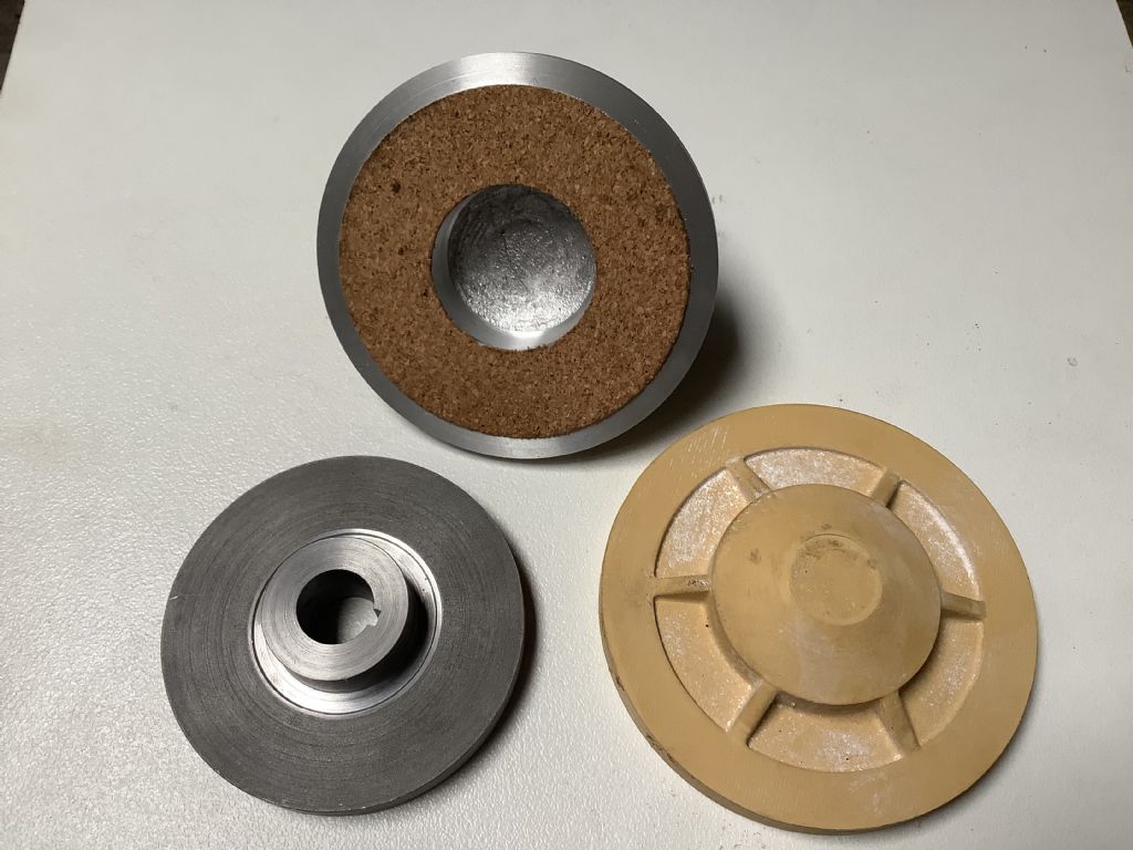

Thank goodness for a shed as today the “ big wet” arrived in the form of 235 mm of rain in the last 24 hrs. The shed did have a moat around it but in some places they had over 600mm in the same time and that’s enough to wash a shed away ! I have made some of the parts for the clutch ,these being the outer pressure plate and the inner plate. I still have many parts large and small to make and fit but I am trying to follow the same construction methods as used on the full size tractor. This is not always easy as some of the details are not visible in the drawings that I have and I don’t feel I can ask the owner to take the original apart. Photographs to follow.
Fred
Four stroke Fred08/01/2022 08:53:53
avatar
322 forum posts
305 photos
Cork faced pressure plate and solid steel clutch plate with 3D printed pattern.
