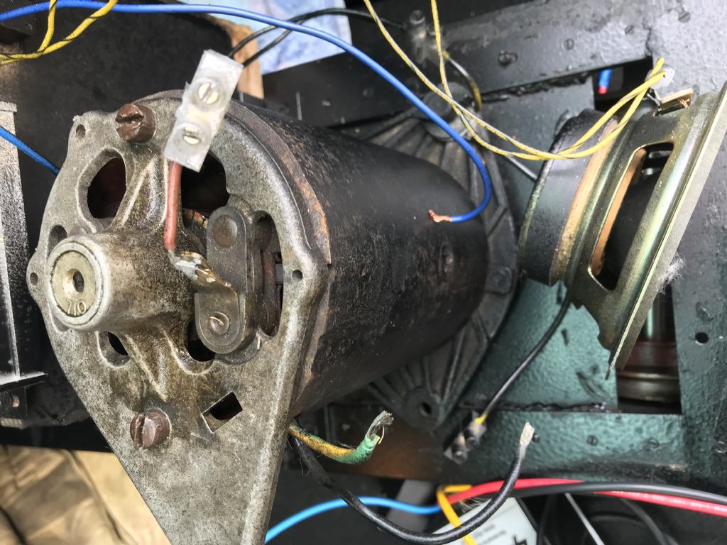

Hi Robert, here are further readings.
Black to brown. 3.9
ground to green/brown. Ol
case to black. 1.3
case to brown. Ol.
thanks, michael
04/09/2019 18:49:58
Hi Dave. Ok these are the figures. Black to green/yellow=8 ohms. Brown to green/yellow 4.5 decreasing. So with this new info. How or should I wire my two controller wires. Thanks, michael
04/09/2019 17:08:58
Hi, yes I do have a multi meter. There are two of these dynamos wired so that one works forward and the other for reverse. I only wish to wire up one dynamo. So Dave if I am reading you correctly.both brown and green/yellow wires to positive and black to earth.
Ron I do have a 2nd loco that I am going to fit in the 500w motor and 36v. I need to purchase a L/H tap tomorrow from Tracy tools to be able to fit the old chain gear to the new motor. But that’s a difference project from this one. I am keeping the old dynamo on this one as I don’t have time available to make or find new fittings for a new motor, so would just like to get this working to use over the next few months.

Hi, I am trying to wire a controller to this motor. The controller as a live and negative outlet wire . But the motor as three wires. Can anyone please let me know which wire connects to which. Thanksf1f905c0-df76-4eb8-aa29-47e10b6b51e7.jpeg
